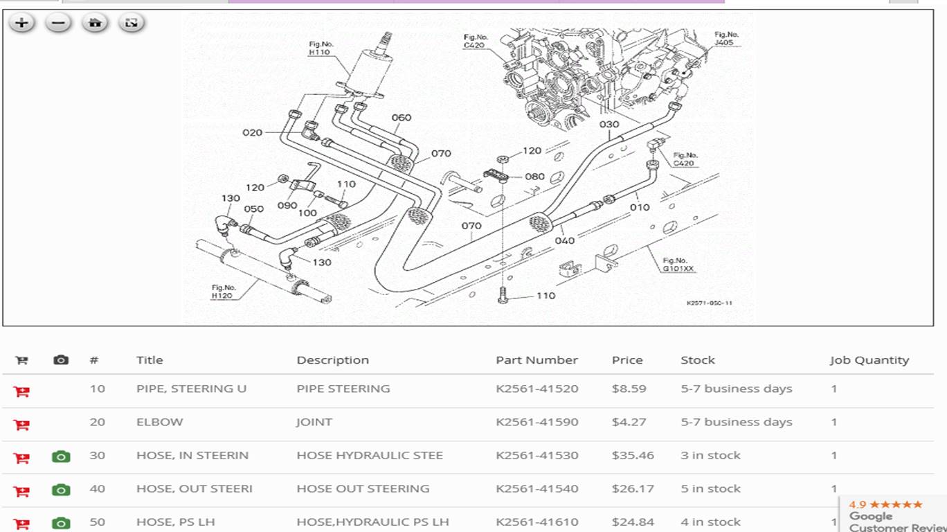

Greetings ,new member here.I have been trolling on this site for 6 months and now I need some assistance. I have a bx2230 and it developed a pin hole leak in one of the metal lines, right where the brace holds it down in front of my left foot. I have had no luck finding a exploded view or a part number. looks like an easy fix.any help would be gratefully appreciated, I am continually amazed at the knowledge on this site. Thank You .

Did you look here?: Kubota Parts | Buy Online & Save
   / hydraulic lines #4
Is this what you are looking for?
Here's the link of the parts breakdown: Kubota BX223D Parts Diagrams
Added in Edit: Sorry the link won't take one directly to the drawing. After selecting link above, selected Pump/Motor System along the left hand side, then select J21500 HYDRAULIC OIL LINE(STEERING).

Heck I'd remove that line and have someone simply braze a blob of brass over the pin hole, maybe even silver solder but brazing would be better.

Hey guys ,thanks again for the help. Well I got the line put on Friday night (4 Hrs later) .Wasn't easy but I didn't figure it would be .Hint to any one doing this,Take off the mower ,I wish I had. Also be prepared to remove the bracket that your FEL mounts on to. line came apart fairly easy. 15 year old tractor.Changed hyd. fluid and filter,so I am good to go! thanks again everyone!

Mine got hit by a grinder by accident when my neighbor was welding something else. But they were all corroded, so I replaced all 3 of mine for about $90. Removing the left rear wheel helped also.
