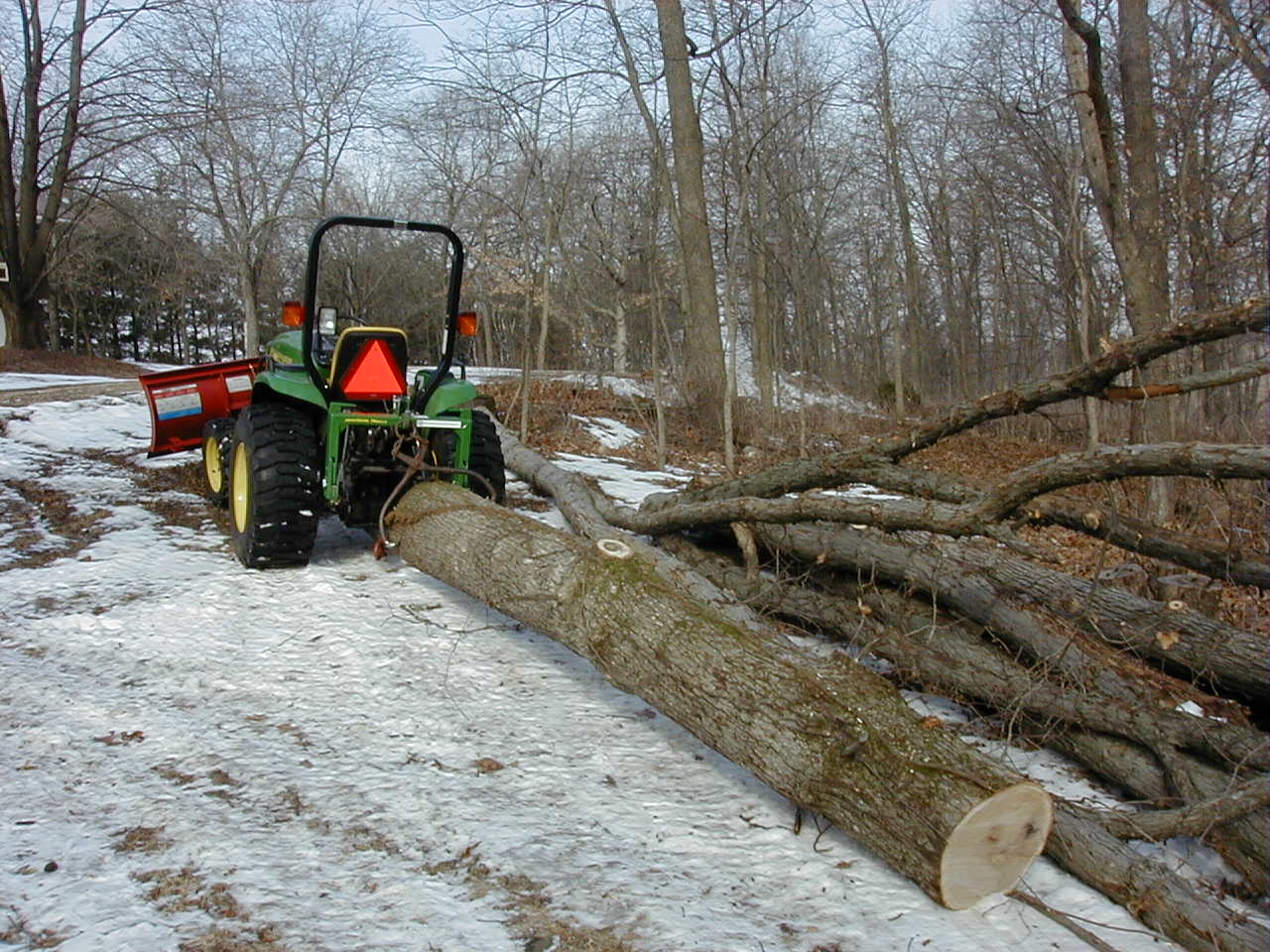

personally just back right up. toss chain around tree a couple times. and right over 3pt hitch. (closer to rear of tractor) as i can. within reason. so i can get more weight right near the rear tires. so my front wheels don't come off the ground. 3pt hitch lifting things up just a little bit so the one end of tree is not digging into the ground as it is being pulled.

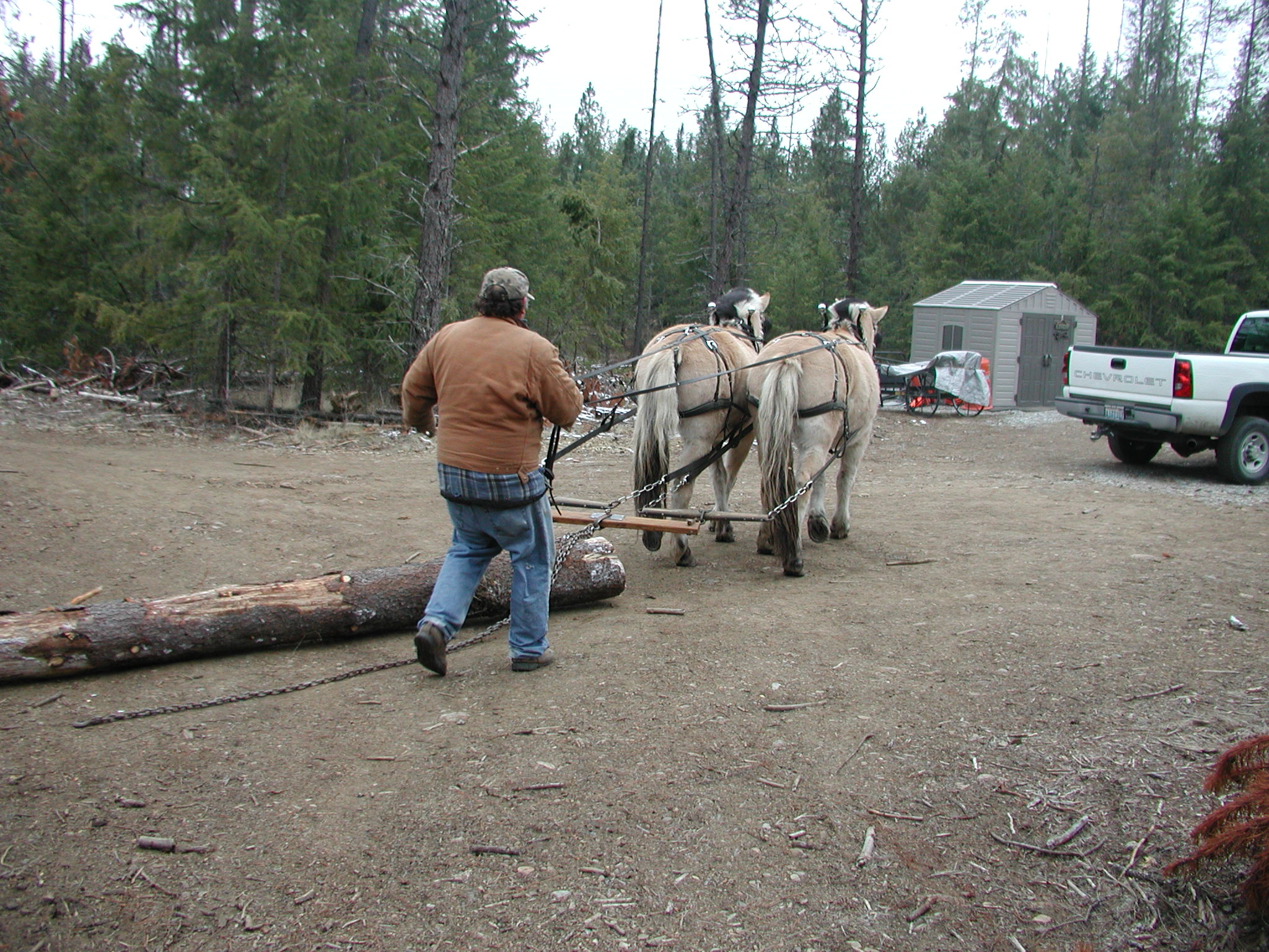

Since I started moving logs on a trailer loaded with a front grapple on the loader I've been real happy. Clean bark, very little jumping on and off, very little hand work after sawing, roadways stay good with no tree furrows.
The rear grapple is appealing but my woodlot is a good half mile uphill from the barn and a little portion of town paved road in between.
By the way GRS, that's some handsome harness you've got and a handsome pair too.
