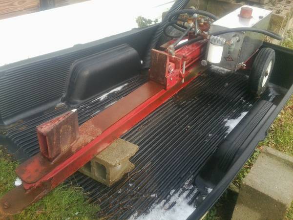

Would it be possible or advisable to use the hydraulics on a power trac to run a log splitter. I am looking at a log splitter that the owner uses a Simplicity 12 hp tractor to run the log splitter by bolting the pump onto a pto shaft. I was thinking I could use the pto circuit to run the splitter .

You can. One big negative is that you can not use the PT at the same time to carry logs etc. You are also putting more wear and tear on the PT than is necessary. On the plus side, doing it that way gives you one less engine/pump to purchase and maintain.

Just make sure the ram and valve can handle the PSI of the Power Trac. I am building a log grapple and put a 2000psi cylinder on it. I promptly blew the seals in the cylinder after half an hour of use. Had to step up to a higher psi cylinder.

Of course you can use a log splitter on the PT.
The GPM will determine the speed.
Moss, You could have used the 2000 psi cyl with an external relief valve across the cyl, or reset the log splitter valve to 2000 psi.

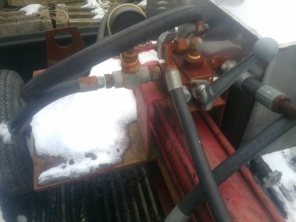

Some more questions . The in and out ports on the valve are 3/4 inch , currently there is a 3/4 inch hose on the in and 5/8 inch on the out port, should I replace the 5/8 inch hose with a 3/4 inch hose? The ydraulic cylinder is 4 inch and 24 inch stroke, bore is 1 1/2 inch and the pt 422 is 8 gpm and 2500 psi Also what kind of quick disconnect does power trac use?

The OUT hose should be the same size as the IN hose/port or larger.
However, an adapter will be cheaper to replace.
They were using Faster QD's.

J.J. sorry but I got the way the hoses are reversed. The in hose is 5/8 inch and the out hose is 3/4 inch. The in hose has an adapter taking it from 3/4 to 5/8 inch where the pressure gauge is.
/ Hydraulic log splitter #20
Out hose should be larger. Less back pressure.
