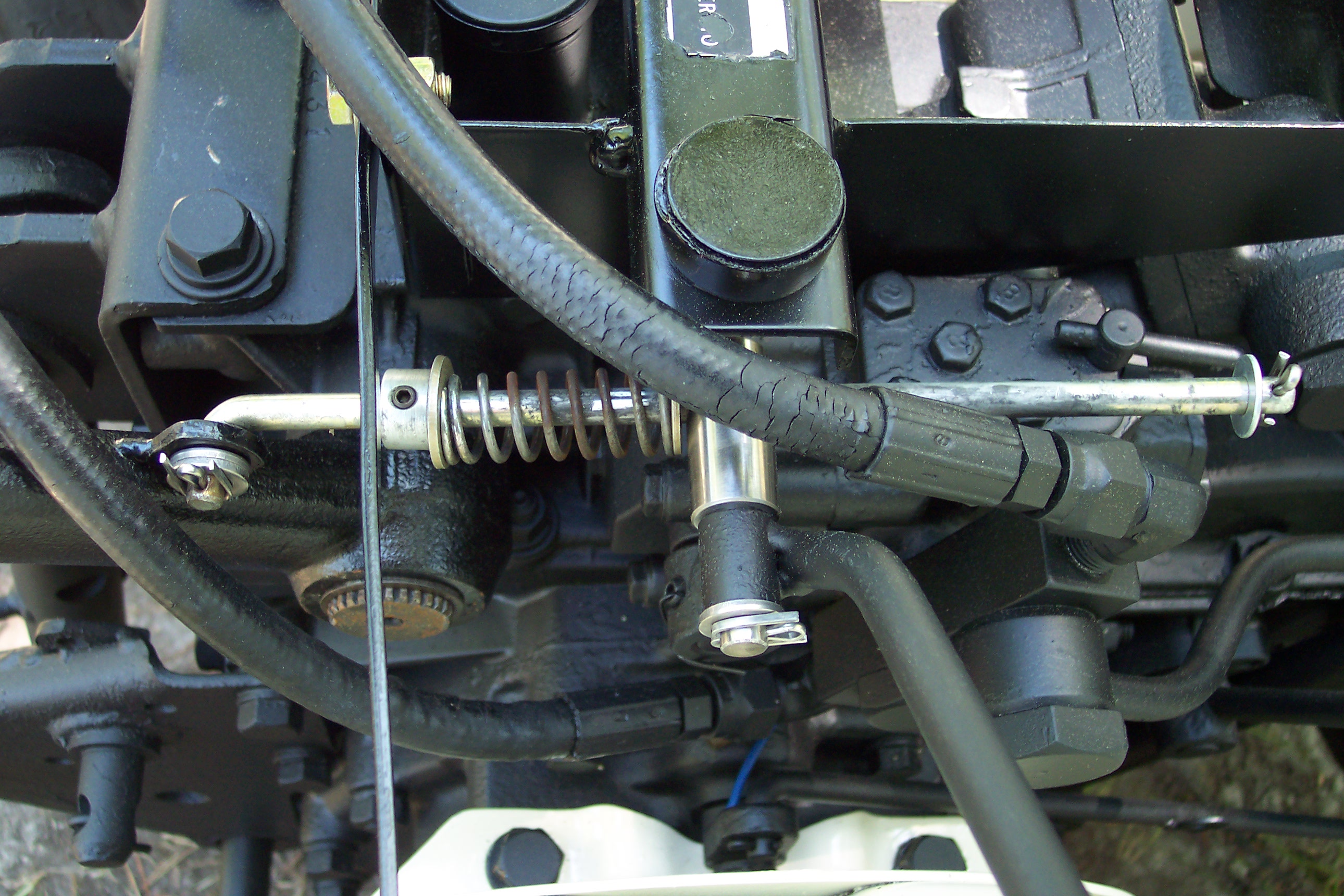

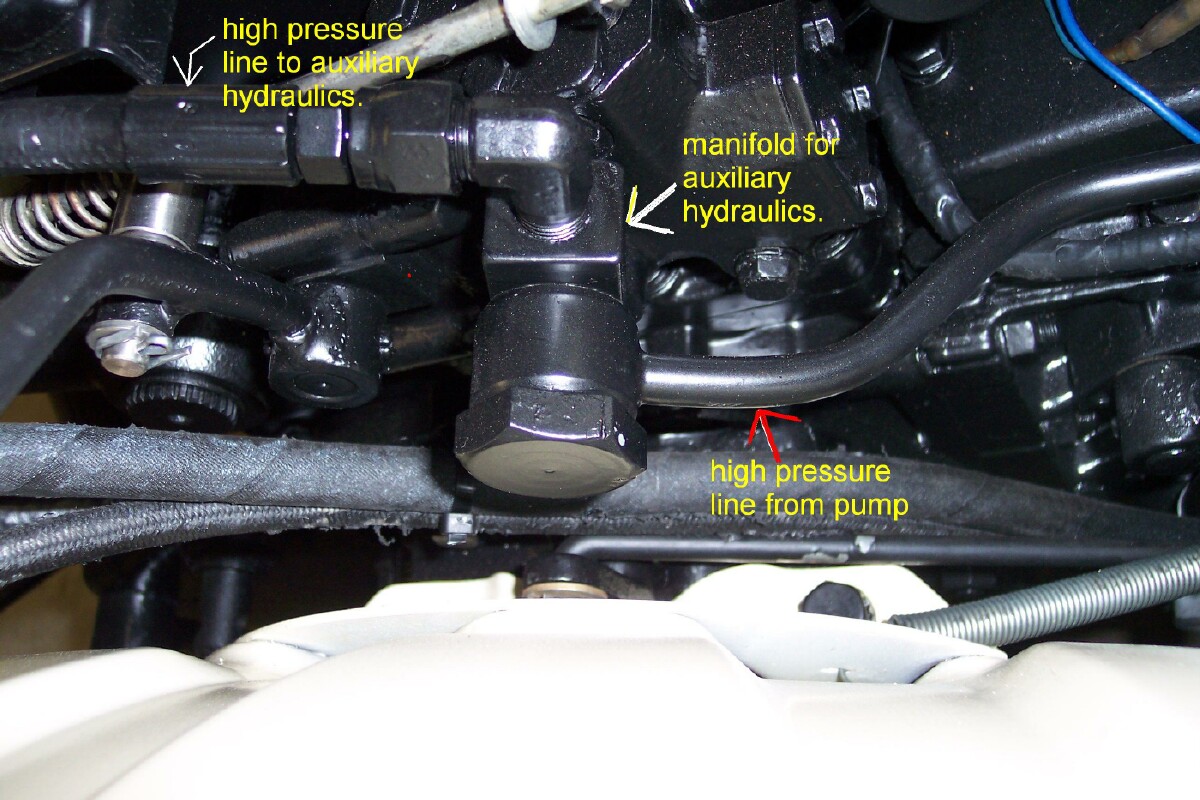

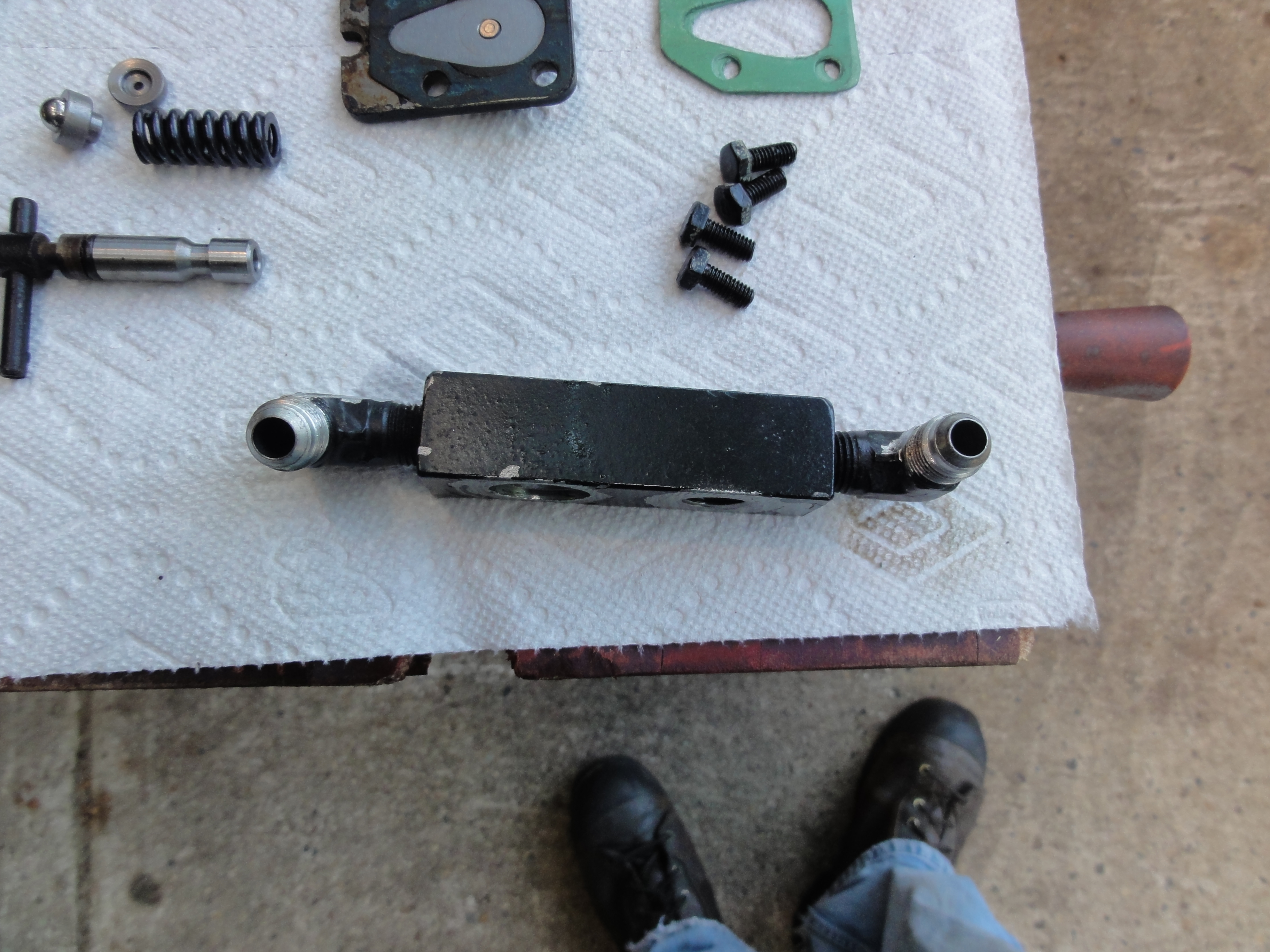

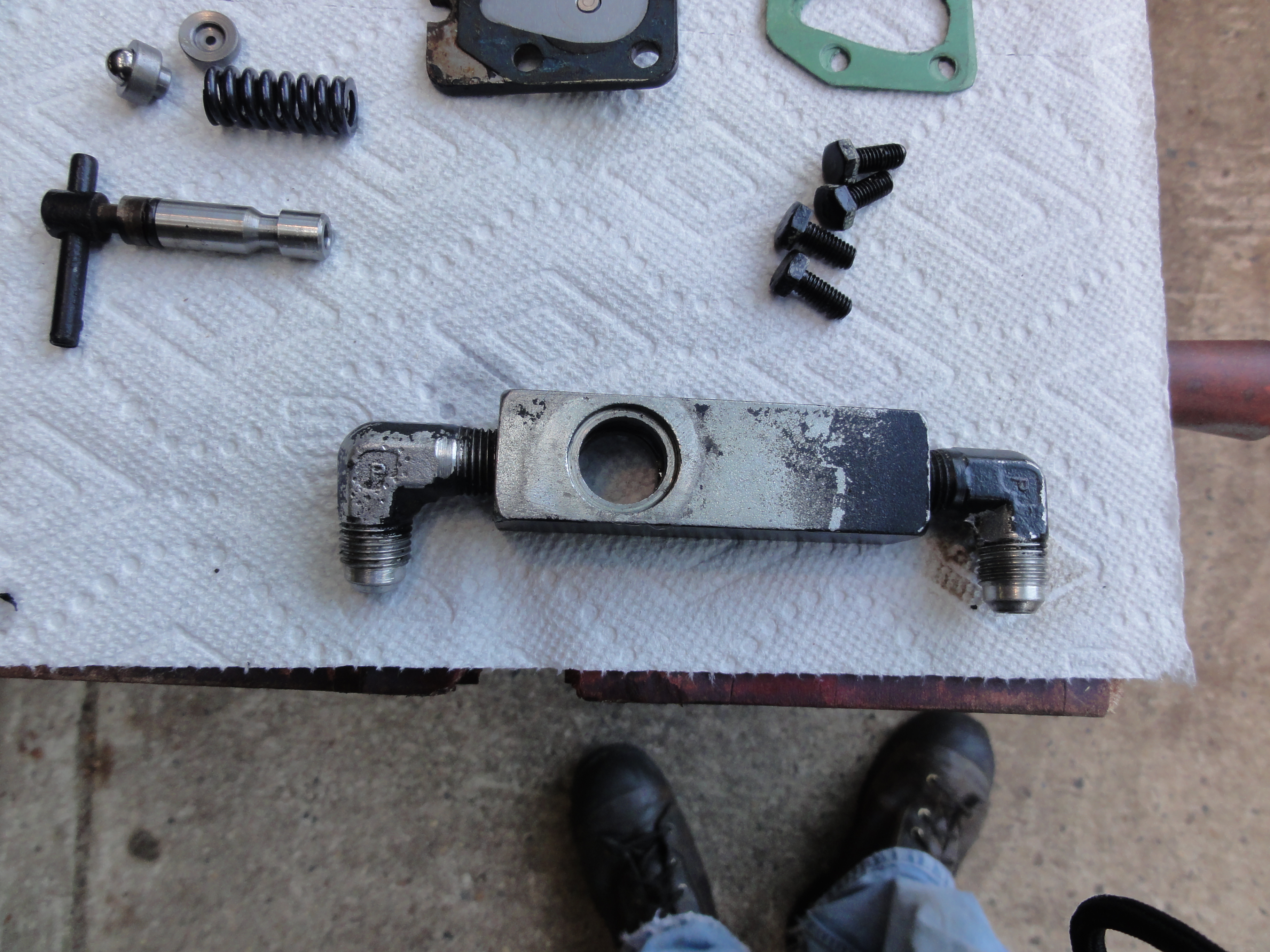

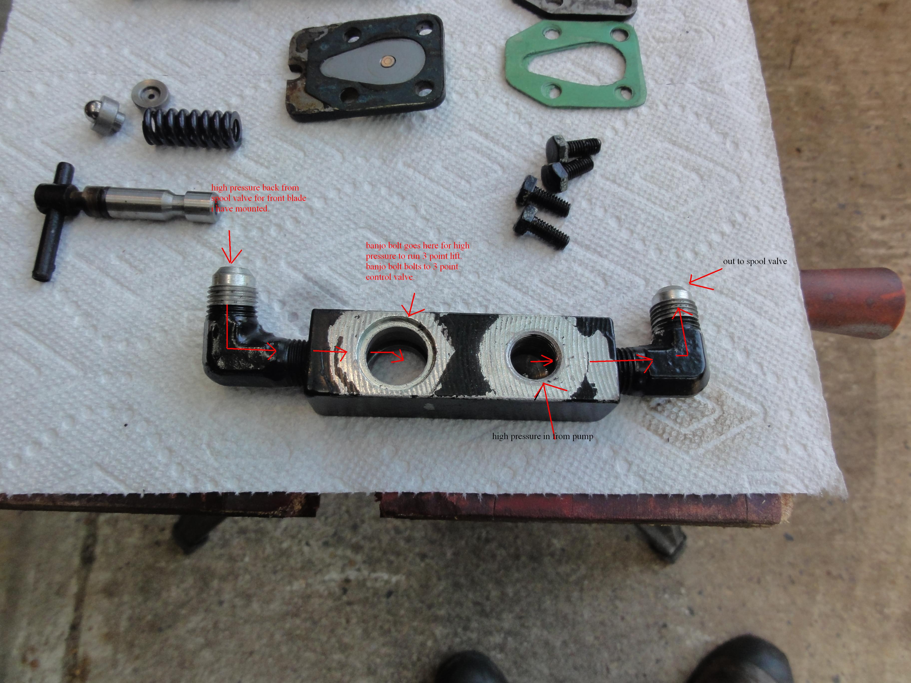

Here are pictures of the one on my G154/TX1300F
I though I made a sketch of this manifold but I
can't find it. I will take it back off and measure
it and make a new sketch if you are interested.

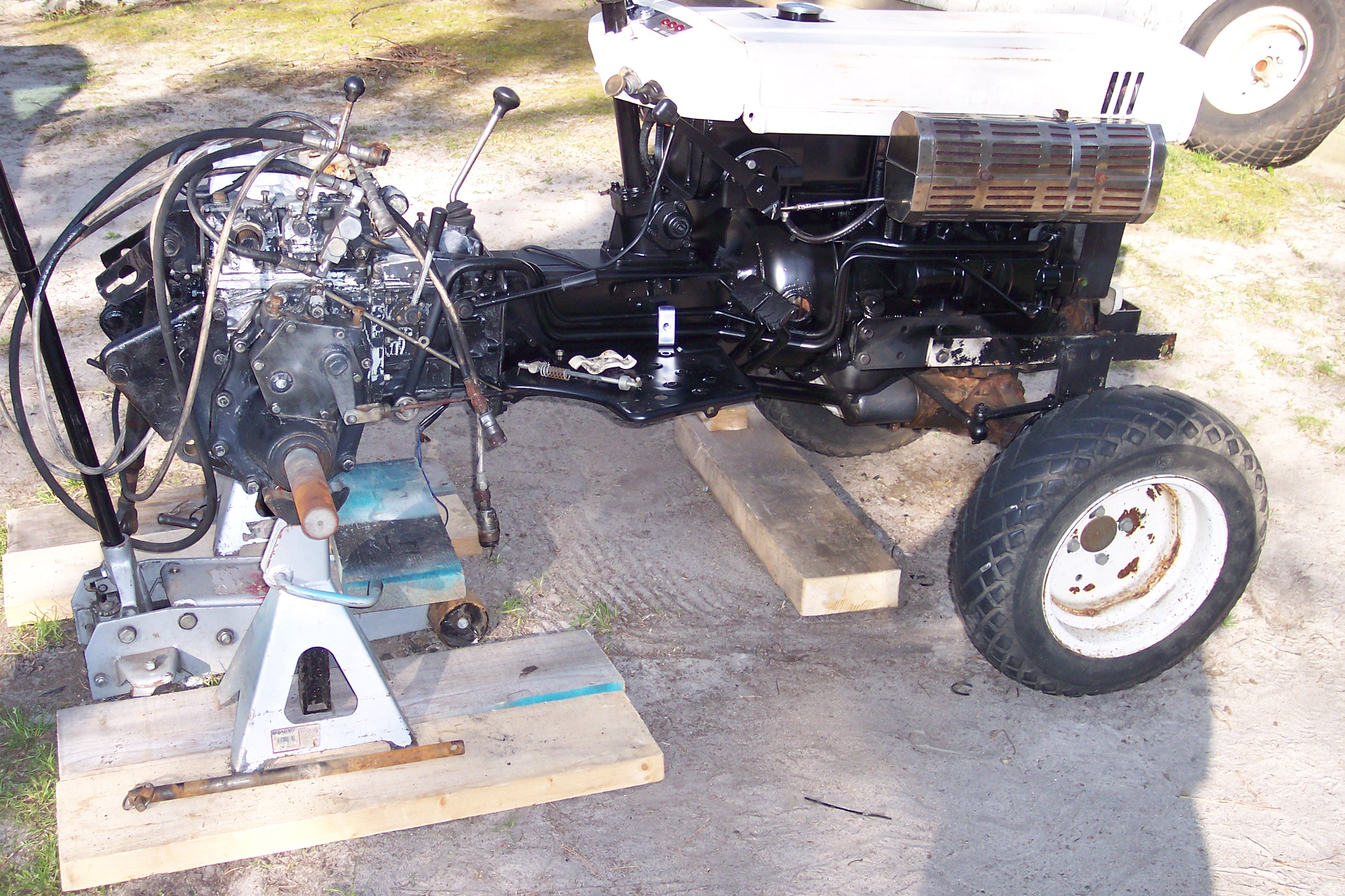

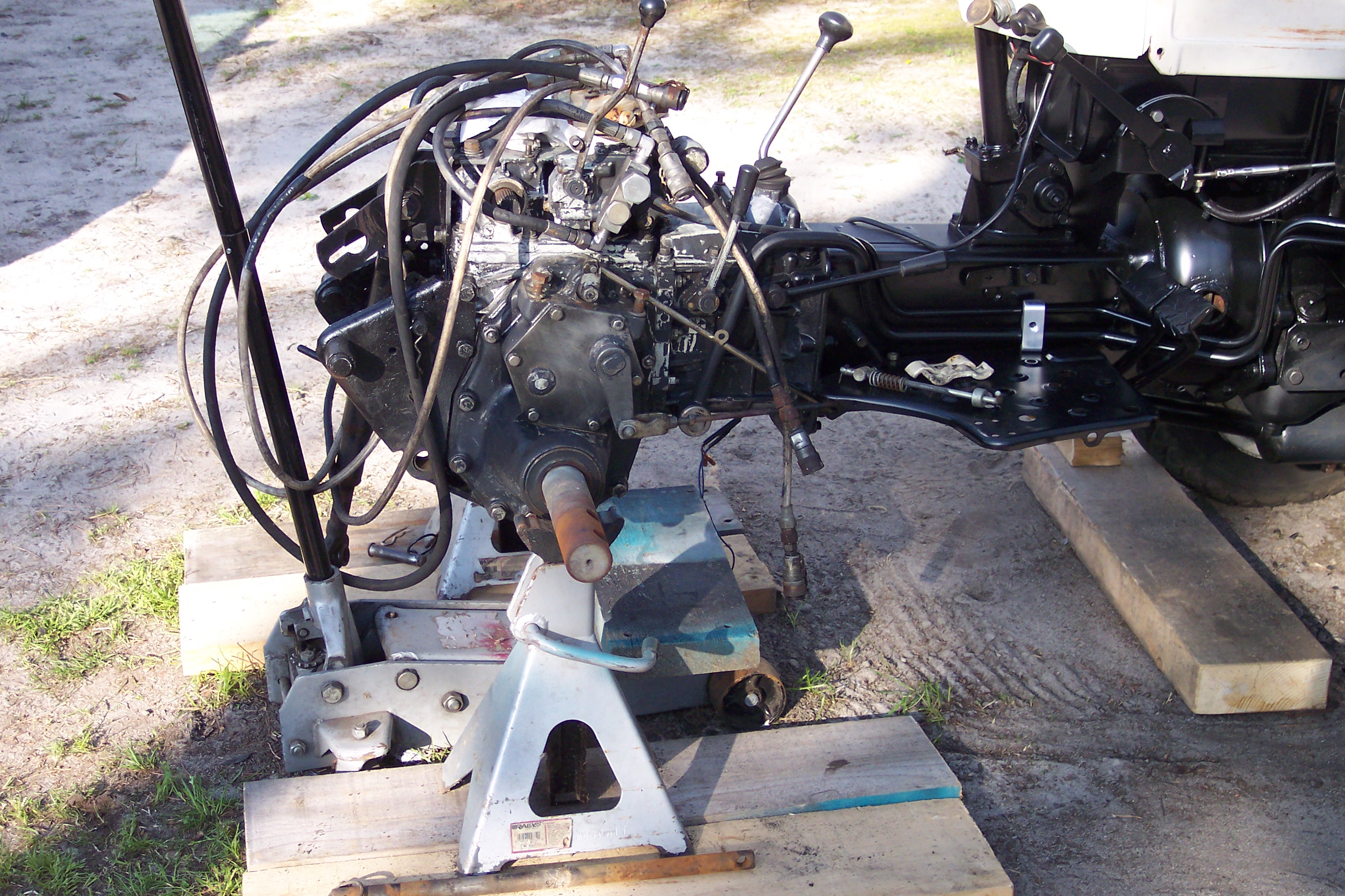

/ hydraulic manifold ? #8
The spool valve was already on the tractor when I got it.
I believe the valve and the manifold along with hydraulic
hoses and snow blade were dealer installed. I have
see my setup on other tractors.

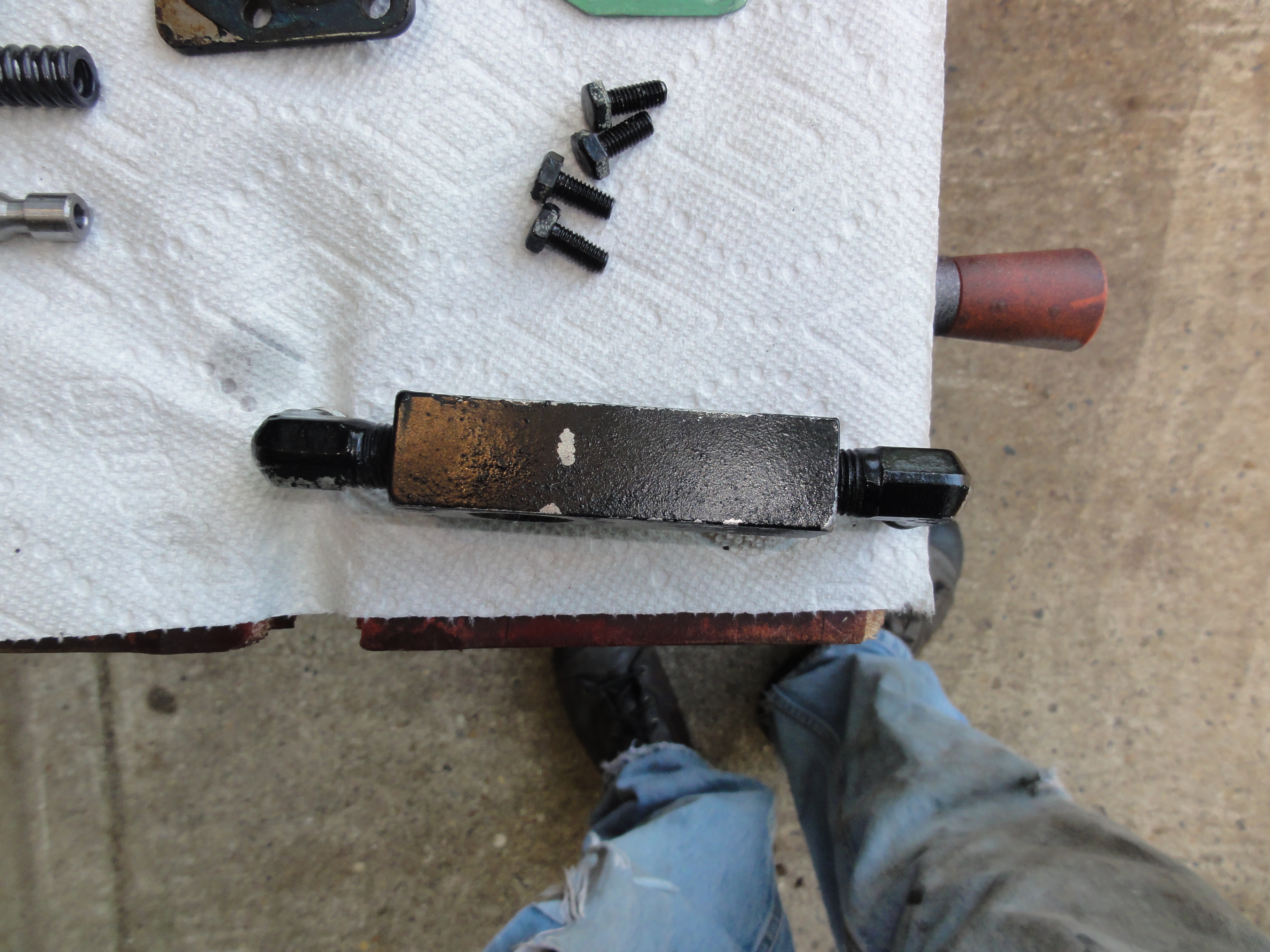

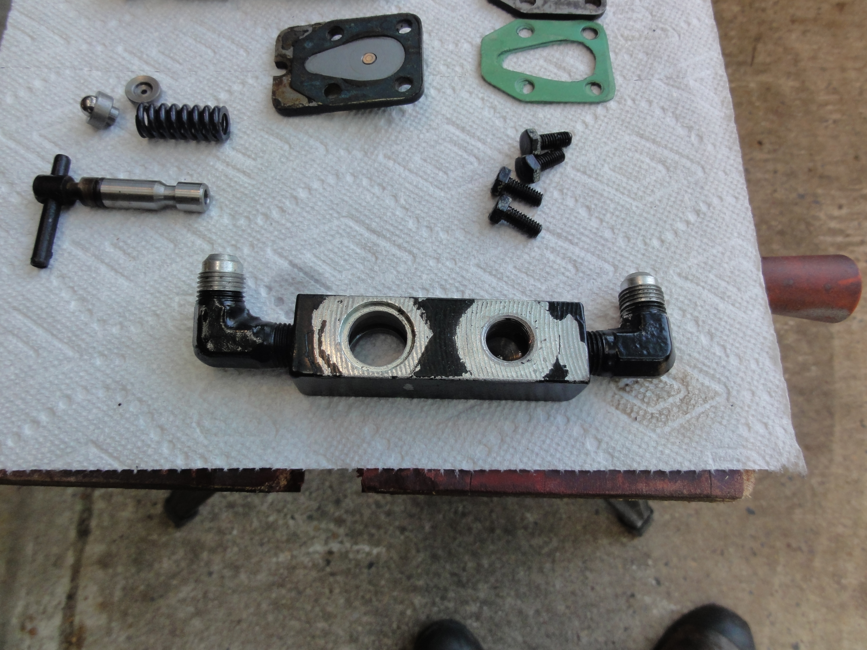

My manifold is not any type of valve. It is just
high pressure in one side of manifold and out that end to
carry pressure to front blade valve assembly.
high pressure returns from control valves into
the other end of manifold and out the side
via a banjo bolt and the high pressure
then goes into the 3 point control valve.
Its just a pass through. I guess I will
have to take it off so I can get all of the
dimensions to make a drawing for anyone
who wants to have one of these made.

fxrs55 - I'm pretty green with hydraulics but from your pics and drawing that looks like an open spool plumbed neatly in before the 3 point. Pretty much what I was looking at with Hoye's adapters.
Dave - is that how you see it as well ?
If it works, I haven't found any spools that have more than a 500 psi rating on the tank side. I read Ampa's thread and he had issue with a cracked spool housing, I wonder if that's why.
/ hydraulic manifold ? #20
Using the tank port as a supply for another circuit is a common mistake and usually results in the failure you describe of a crack in the valve body. Further, you eliminate a relief valve working properly as it needs a path to the tank to save you from destroying the pump. There is lots of junk hydraulic advice on the web.
This out port pressure restriction is common as you have found.
Years ago companies like Kubota made hydraulic blocks that could be added by their customers in order to acquire more circuits.
The big difference between the 3 pt hitch and the circuits you want to add is the 3 pt uses a single acting hydraulic cylinder, whereas, because you want to control double acting cylinders you need a control valve and not try to use the 3 pt control valve
Dave M7040
