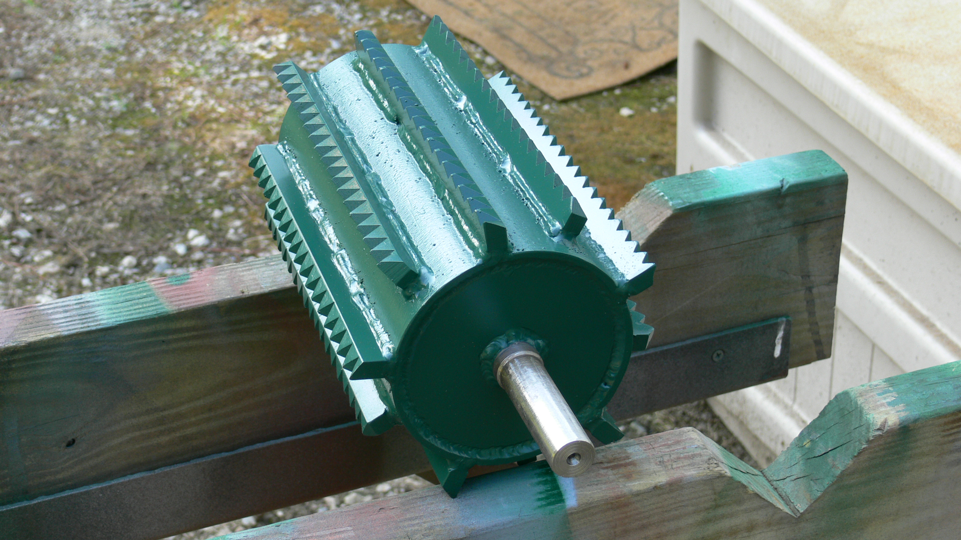

5030 - - now for the chipper story - - you asked for it:). When I first got the chipper the feed drum only had flat 1/8" bars welded across to grab branches. The bars would slide on branches and nothing would feed unless you pushed in constantly - - PITA. I ground notches in the feed drum to make them more like teeth and this worked until I bent the shaft and broke the nut on the drive shaft. I talked to the the dealer that sold me the chipper and nothing else was available so I made a feed drum and sent him a picture (see below) - - I now see that feed drums remarkably similar to mine are now for sale - - wonder where they got the design! Next I broke the nut on the drive shaft - - again. Back to the dealer and found that Jinma had a new design with U joints so I purchased and installed that. Then the bar that holds the feed drum was flexing and bending jamming the feed drum against the side - - gear box gone - - so I remade the entire drum support system using steel tubing - - NO flexing now, goes straight up and down with no problems. At this point I considered trying to design a hydraulic system but I needed the chipper got lazy and ordered another gearbox. I have no idea why this one broke. It was feeding fine, branches were 3.5" max and nothing strange - - it broke in less than an hour of chipping. All gearboxes break by snapping the bronze gear - - the steel worm input is fine. One other change to the chipper was the cutting blades. I found the tips of the "hardened" blades were curling over/bending. I made blades out of D-2 steel had them hardened and I ground them sharp - - blades don't get dull nearly as fast now and they don't bend!
