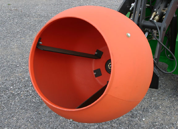

Power-Trac has this cement mixer for one of the smaller PT. I believe the output of the PTO pump is about 8 gpm. It might work for you, small and light weight.They have two sizes. A 4 cu ft, and a 6 cu ft

As others have stated, you need a much lower displacement motor if you
are going direct drive.
I think you meant to say he will need a larger displacement motor. Larger displacement will decrease the rpm of the output shaft for the same flow. Larger displacement will also increase the torque.
   / Hydraulic Motor from Aux Hydraulics? #14
You are correct, I stated it backwards. Although generally torque goes
up with displacement, that does not have to be true. And some common
series (Char-Lynn S for example) tend to be lower pressure/lower torque
vs some other series/brands of the same displacement (E.G. White HB).
I am trying to find a deal on a very high torque motor displacing about 8
ci and a moderate torque motor of 8-10ci. The latter for a concrete mixer,
the former for another hyd PHD. Torque output is also based on the
internal design of the motor.
