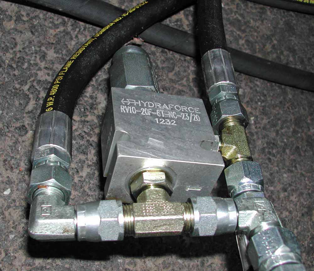

That motor at SurpCntr runs at 1450psi, continuous. Once you pick a motor, go to the manufacturer's spec
sheet in their online catalog and look up the characteristics. You want to pick an operating point somewhere
in the midrange of pressure/RPM; they get very inefficient at the extremes.
If you have an aftermarket AUX valve already, then you are set with a relief, as long as it is adjustable. Full
flow is fine if you are going to pick a motor and gear it down to fit your flow. If you don't want to adjust the
AUX valve RV, and don't use a motor rated at least at 2300psi, then a simple crossover RV like this I recently
used for my hydraulic chainsaw works well, and is not too spendy. Factory AUX valves often do not have their
own RVs because they count on the system RV. My Kioti OEM AUX valve is like that, which required I add an
RV. Also, some hyd motors have an optional RV built in.
I try to simplify the design as much as I can.
