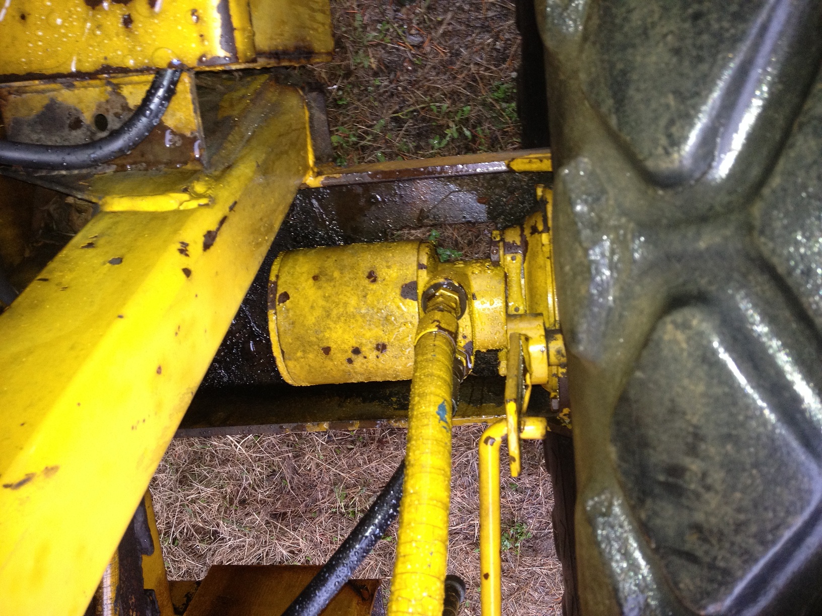

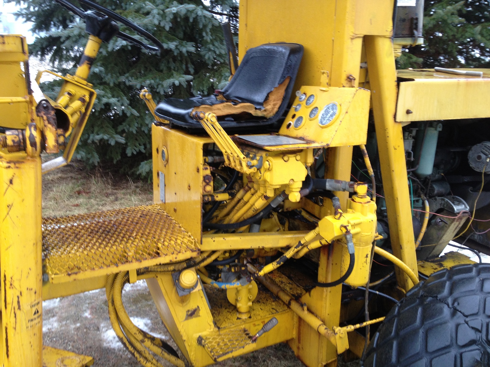

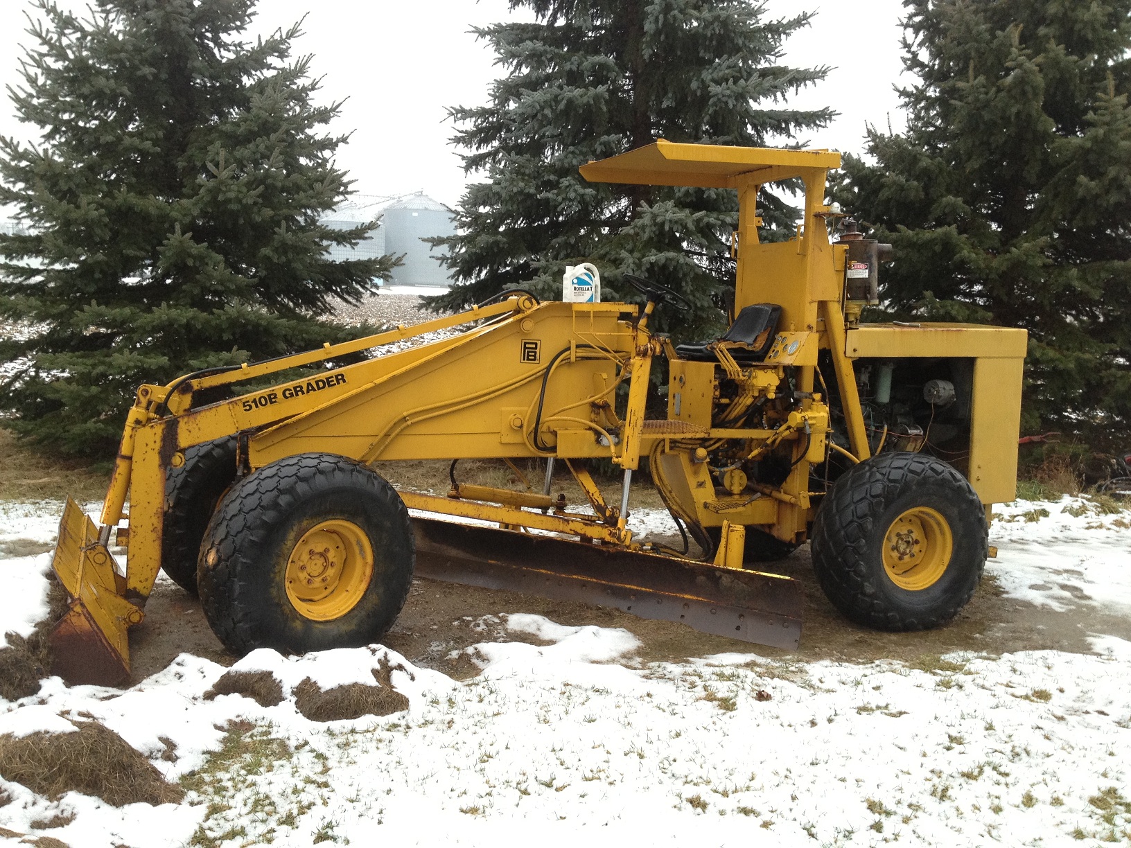

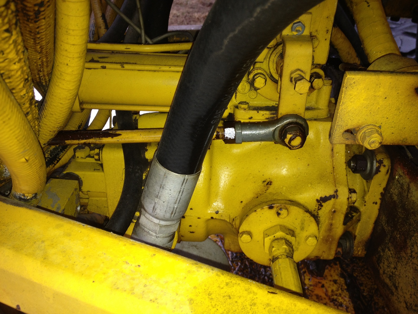

pics of hydrostatic 4x4 grader Eric
   / Hydraulic Motors?
#12
Do you have any specs on that pump. What kind of speed does it get.
   / Hydraulic Motors? #13
No, It wouldent do you any good anyway, this machine weighs maybe 8000 lbs, and has a 4cyl diesel engine, You can you tube puckett bros grader 510 and see one in action, The point is, Its a 4x4, hyd motor on each wheel, And >1< hydrostatic drive pump. I also have another 4x4 machine setup the same way, Jacobsen LF 3810, 4x4 was an option, I dont understand why you want to complicate your machine with 2 pumps. Max speed on either one of these machines is about 10 mph, And you need about double that so specs off even the Jacobsen mower wont help much, The really cool thing about the jacobsen i that its a 2wd until you flip a switch and direct oil to the back axle, at that point it slows down, maybe 25%, so basically its like a transfer case in a 4x4 truck, only this is either 4x4 low or 2wd high. perfect for your application, you can get top speed in 2wd, or 4x4 at a slower speed.:thumbsup: Eric
