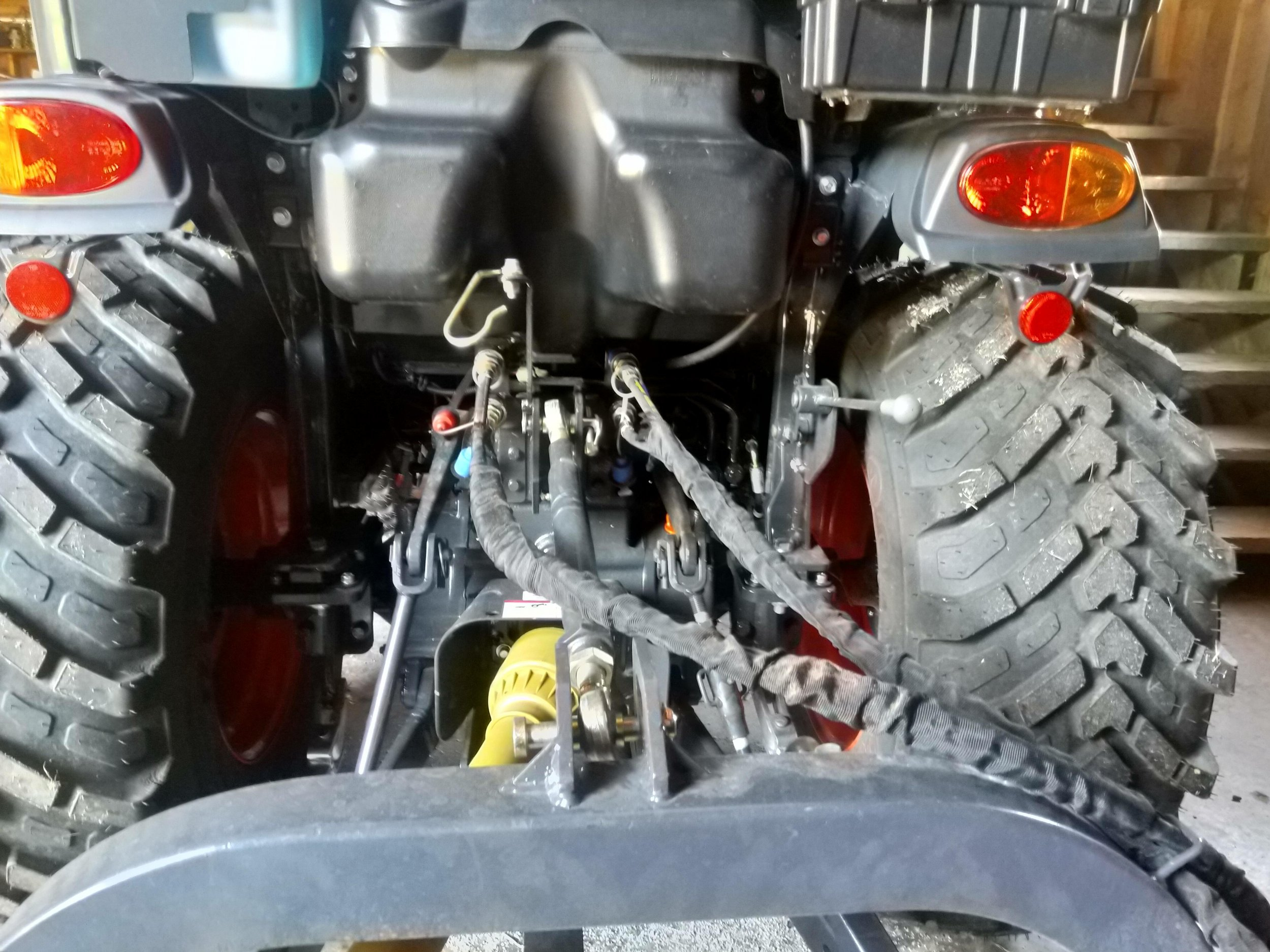

I have a ck3510se-hc with the 2 rears and would really like to eventually get a top n tilt but need to keep 2 pairs open for my flail mower.
I've seen a few videos showing these off but not of anyone actually using them, and not much on the forums.
Based on the lack of room and placement of the factory remotes, I think I would have to mount it up behind the fuel tank, maybe make a bracket to hook in by the bolts near the right fender and get hoses to feed it from the remote. The left remote is the detent, right is the normal spring return center.
Since it looks like it will be many months for top n tilt availability I just wanted to make sure I wasn't barking up the wrong tree with how to go about this. In the beginning I thought I may just get the hydraulic top link and remove it during mowing season.

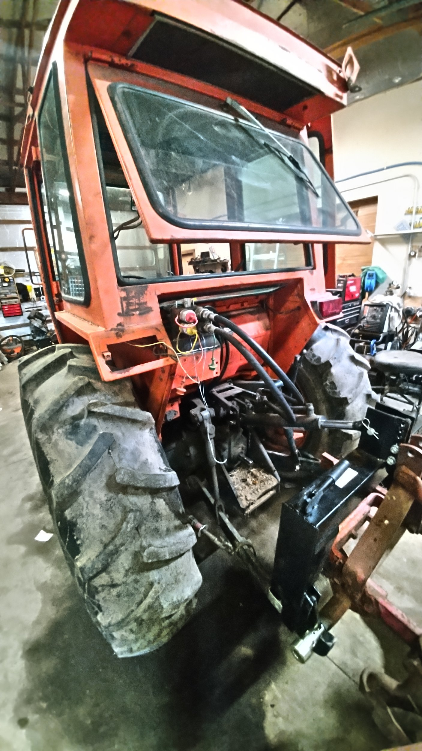

Bought a manual multiplyer gave me a total of two remotes instead of one.
Bought from summit a few years back nice they include all fittings and accessories you may need to make it work, including dust caps, very happy with it but for my application, in order to manually change circuits from seat I did have to make a bracket and reroute the original remote lines, easy peasy.

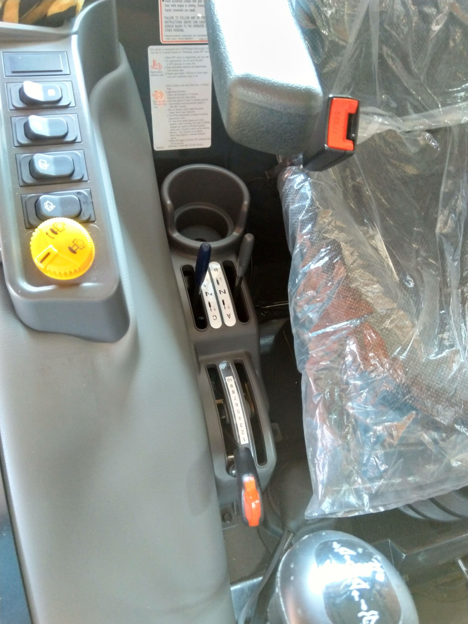

Just a thought,concern. I personally would prefer to have the diverter controls on the actual control lever, not some rocker switches mounted who knows where? :unsure:
When I want to control a cylinder, I sure do not want to be switching some rocker switch and then move my hand over to the control lever. :oops:
I would check with Summit to see if they might be able to provide such a control in place of the rocker controls.
Just my 2 cents. :)

I have an empty rocker panel spot right above the controls in the cab, which is why I was thinking the 3 way rocker switch vs their panel with multiple switches. My thought is that if I'm using the flail I won't need to adjust the rocker once it's hooked up and the top link is set. And when I'm using the box blade or something like that I would only have to switch between top and tilt.
