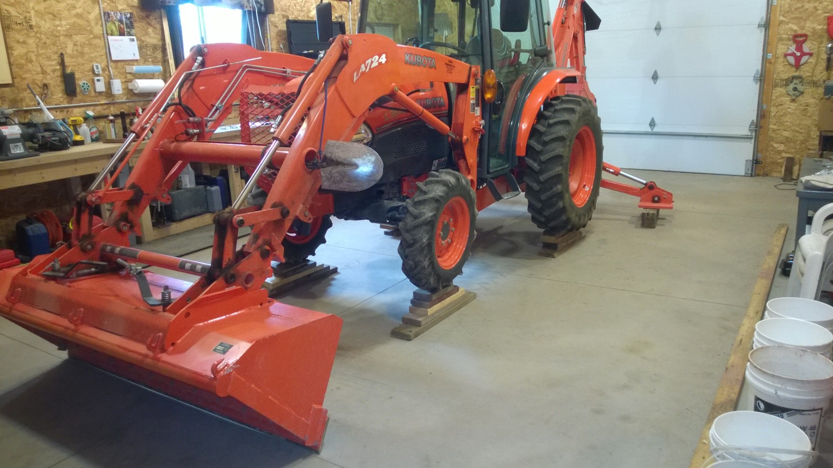

I follow the Kubota manual, I changed the filters when required and I did the SUDT2 at 50 and 450. This summer I will do the 850.
It holds around 11 gallons, but I only get about 8 out of it. I use 5 gallon pails. I open the two side plugs first, then I open the bigger
one. The big one gives me almost 5 gallons. I haven't tested the oil, but it looks good on the dipstick, but is black as ever in a white
pail.
