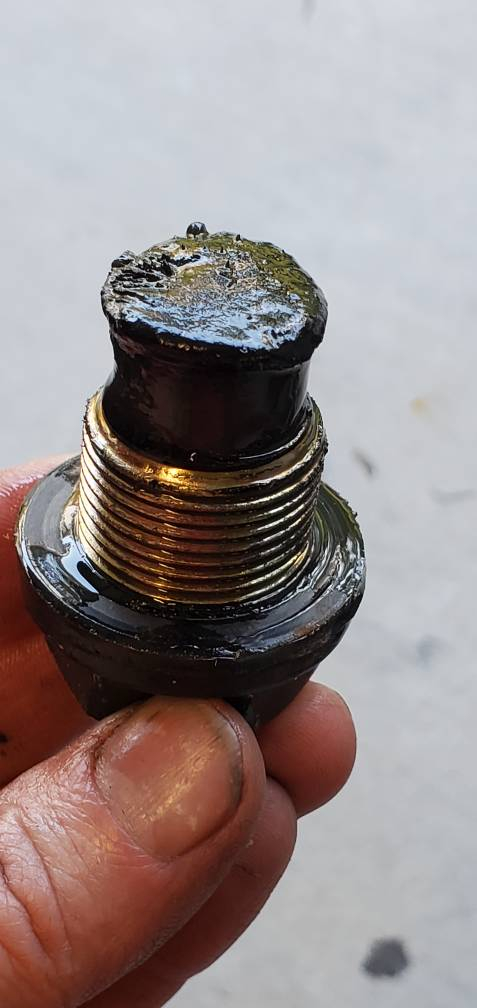

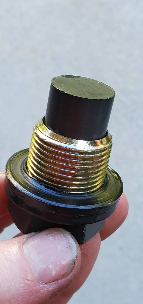

I went ahead and did a complete change. Glad I did because of all the grim attached to the drain plug. Put all 5 gallons in and it is dead center on the stick.
