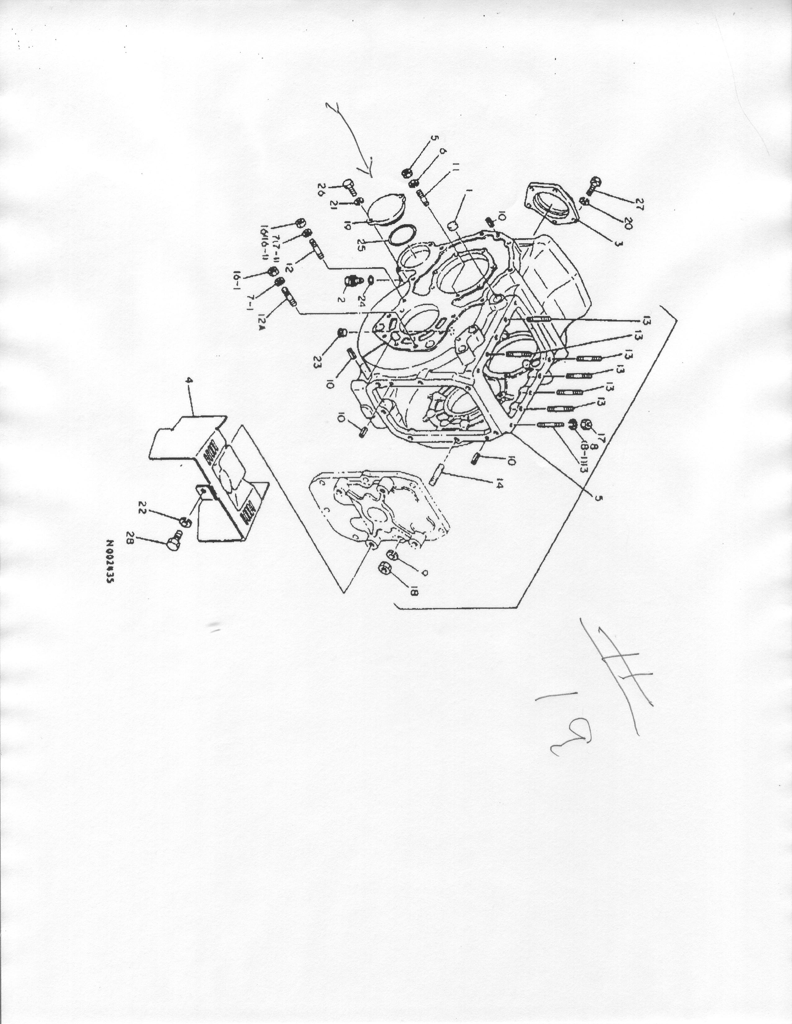

I need to change the hydraulic fluid on a YM2020 The one under the transmission is obvious but there is another plug more to the rear under the belly aprox in the same area as the seat. Wondering if i need to remove this as well or is this something different. Also the screen that needs cleaning is that behind the metal plate on the clutch side up against the trans...it is about 6-8" long and about 3" wide and has 4 bolts holding it in place.

Well I have removed both drain plugs and had to put the rear one back as the 5 gal pail was overflowing... Should i just get another pail and drain the rest out ?? Might be another quart but can't tell Danny i have a new spin on filter but have not located the screen cover... is it under the left brake peddle or on the left side under the PTO ... there is a cover that is round that has 2 ears and is connected to a hose in this area but the bolts are like 13-15m

That should be it.

Thanks for the fast reply ... I will go finish this project The drawing sa a big help !!!!
