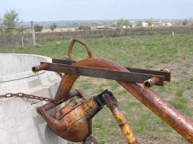

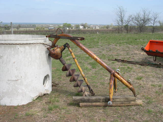

See photos of Danuser PHD with welded weight frame and handle. Frame is for elevator weights which are about 80 lbs or so each and have 2 holes thru them. I can mount 4 weights on the frame thru the pipes and are held on with clips.

texasjohn,
Where is your PTO Shaft Guard? I have never ordered one but I think you can get them for less than $50 and they are worth every penny.
Shaft Guard from Bare-Co
Safety first. :)

Neophyte, I understand your point.:eek:
I actually use the PHD about once every 3 years for a couple of holes. Plastic guard broke into pieces long ago. I keep people away from it when I use it. :)
You see the white thing that the PHD is chained to?
It's a 2800 lb concrete culvert.:confused:
Well, actually, I have a few dozen of them and they are my new corner/brace posts. No need to dig post holes anymore. Just take that sucker to where you need a corner post or gate post and sit it down. It ain't gonna move. If it isn't straight, put a few rocks under one edge. Wrap your wire around it and pull it as tight as you want. Drill holes for gate hinges as needed. Mount gate.. it WON'T sag. And, it won't rot, either.:eek:
