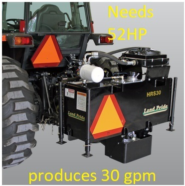

So my basic question is about getting hydraulic power to the FEL snowblower. The 4066r has 11gpm available for implements, but the blowers need something like 20 at a minimum and 40 is preferable. I know that there are rear PTO pumps, but they all seem to stop at 20 GPM.
Cheyenne Mfg has a blower with a PTO pump that claims to have a “T” to the regular power beyond system to boost the GPM rating. Are these PTO pumps, especially ones that feed back into the regular hydraulic circuit for real! Would they damage the hydraulics (as in too much flow). Also, could I still use the 3pt hitch and hydraulic controls for a rear blade? Am I missing something altogether?

You can't add that much pump capacity and not increase the sump volume to help dissipate heat.

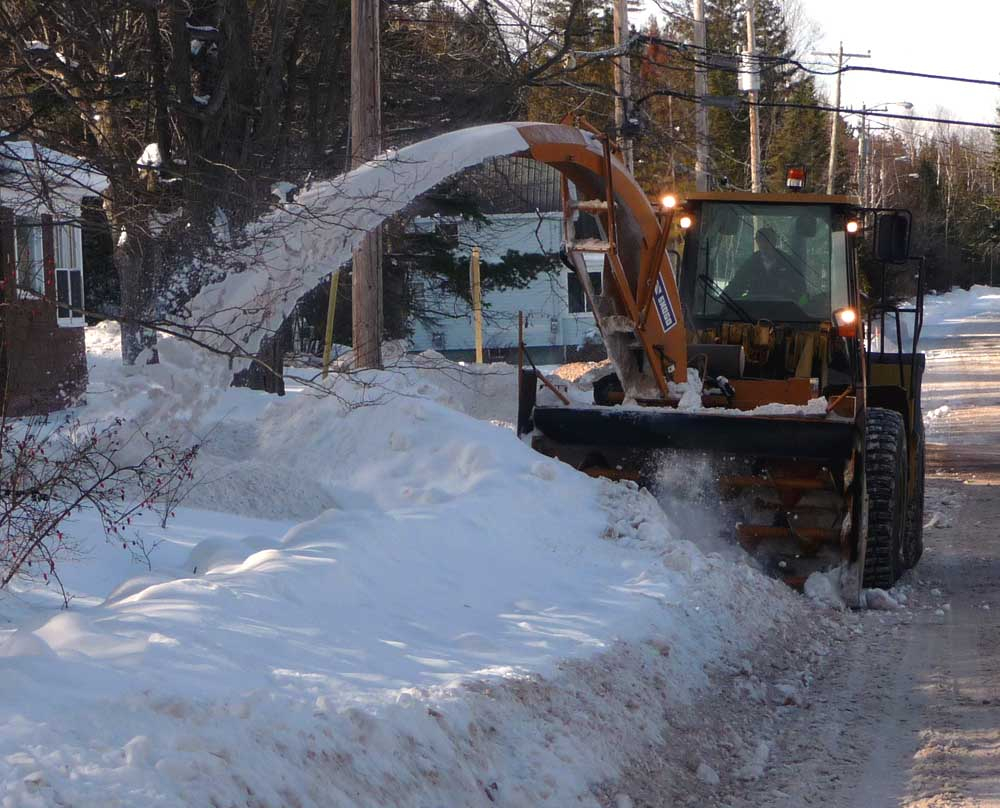

Lots of self contained units get added to front end loaders here. :unsure: Seen here is a municipal unit.

Information on the Sheyenne websites pretty vague and raises a few questions for me and I question ability of drawing 15 GPM out of a CUT sump without cavitation.
I did not see any hydraulic circuit but is this running a semi-closed loop where the pump inlet is connected to the tractor sump and also to return from snowblower motor? In doing this once the lines for the blower are full very little oil is drawn from the reservoir but you now have a concern for the loop oil temperature. Not a common practice but does work if designed properly.

I agree, the website is lacking. I have seen a number of adds for PTO hydraulic pumps with no obvious fluid sump. I saw a video of this blower suggesting that one just connects the pump to the power beyond (I think), plug in the blower hydraulic connectors, pull on the PTO and the blower starts. I am not just accepting this hook, line and sinker which is why I am posting here. But I am curious if this is even feasible and especially if anyone has actually used this type of setup.
