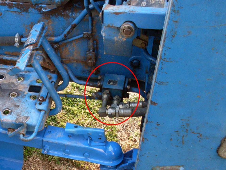

I recently bought a ford 1700 with a770 loader. I'm still changing oils, re packing cyllinders etc. before I haul it to our camp .
I notice that the loader will not pick front tires off the ground ----- ? should it be able to ? If so where should I start looking for the problem . Thanks Mick

Mick, picking up the front really is only a quick way to verify that your loader can do some real work. It doesn't guarantee anything about maximum loader efficiency or power/pressure. On an older tractor, I'd suspect you might not have full pressure from your pump, but if you force the loader arms down as far as they go, you should be able to hear the system relief valve lift if you have good hearing. If the system relief valve is lifting, most likely you have normal pressure unless the relief valve spring is fatigued from old age or somebody has removed shims. On your 1700 model tractor, you may have a separate relief valve in the 3PH circuit and one in the supply for the FEL. The one for the FEL should be in a block on the right side of your tractor just in front of the foot rest. On later model 1700 series, this is the location of the relief valve.
/ hydraulic power / loader
Jim, the pic you sent does,nt look familiar, mine is an 80, and fluid is fed to the controls from 2 hoses originating under the right side of the seat, I'll look for the relief valve and listen though. I just got the tractor ,seems to have been pretty well taken care of, previous owner passed 10 or 11 years ago and it sat in a garage til now. Only shows 550 hrs on the meter so I hope its a minor fix. I'll let you know

Can you show pictures of the valve, and the cyl.

JINMAN, In your post you sent a pic of the relief valve on a F-1700, can you lead me to the hydraulic filter and suction screen on the 1700 ?

Your tractor doesn't have a regular spin-on filter or cartridge type filter. All it has is a screen. Follow the big line off the top of the hydraulic pump. Where it goes into the transmission case on the right hand side, there is a round cover under a banjo connector. Take the banjo connector loose and remove the round cover. It is attached to the screen. Be sure and drain your hydraulic fluid before removing the banjo fitting or cover. After cleaning the screen, you can add your fluid back. Here's a diagram of the screen (item 15). The screen is on the suction side of the pump.
