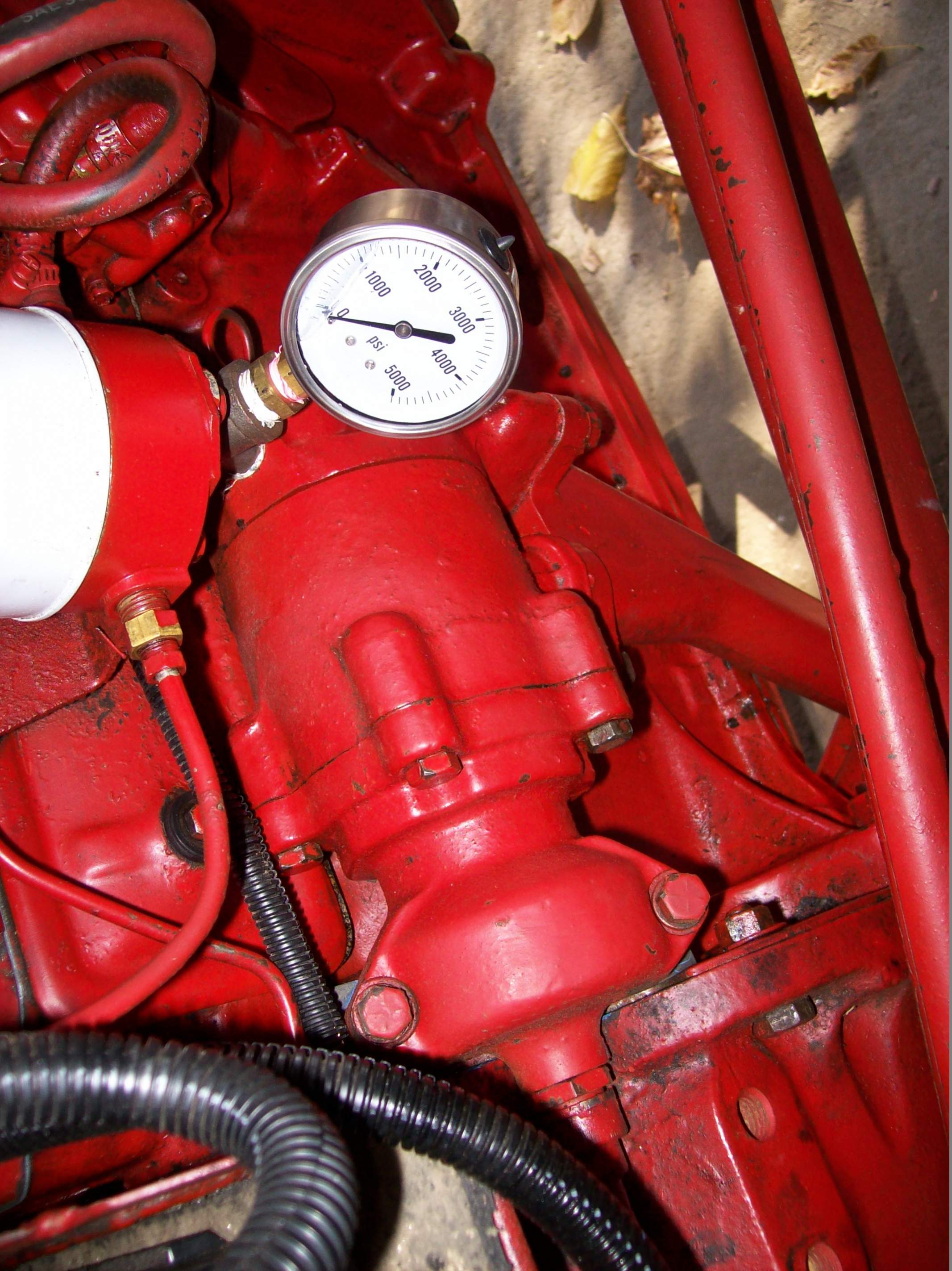

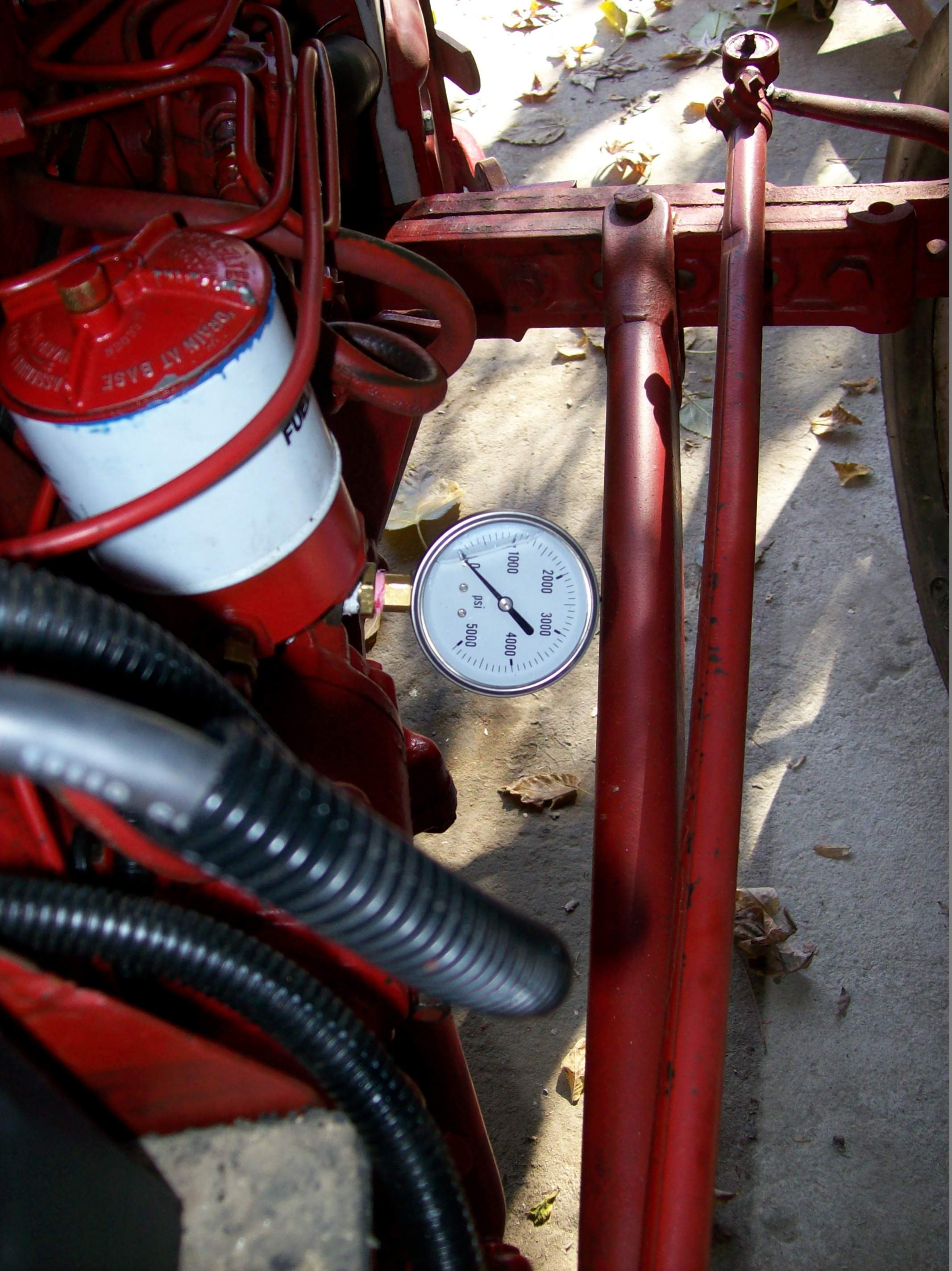

   / Hydraulic pressure check #15
Recently on my 861D I was able to install an Ebay hydraulic pump gauge (goes to 5000 lbs) elbowed from the plug in the top of my Hydraulic pump and left it there permanently. I haven't tried to test the relief valve by chaining the lift arms to the axle, but when lifting my 6' scrape blade the pressure ran up to about 400-500 lbs and dropped down to almost 0 when the lift stopped moving. I figure that is about the weight of the blade. When I do run into something heavy or unmovable, I plan to just keep an eye on the gauge from the tractor seat and observe how much pressure it really will lift and when the relief valve kicks in. I'm not sure what pressure the relief valve opens, but I know it is supposed to be under 3000 lbs. for mine tractor.
   / Hydraulic pressure check #16
Most at pressures for tractors are under 2500 psi, which is why I reccomended a 3000 psi gauge to show good resolution.
With no book in front of me I'd guess open is around 2250 and cracking a bit less.
