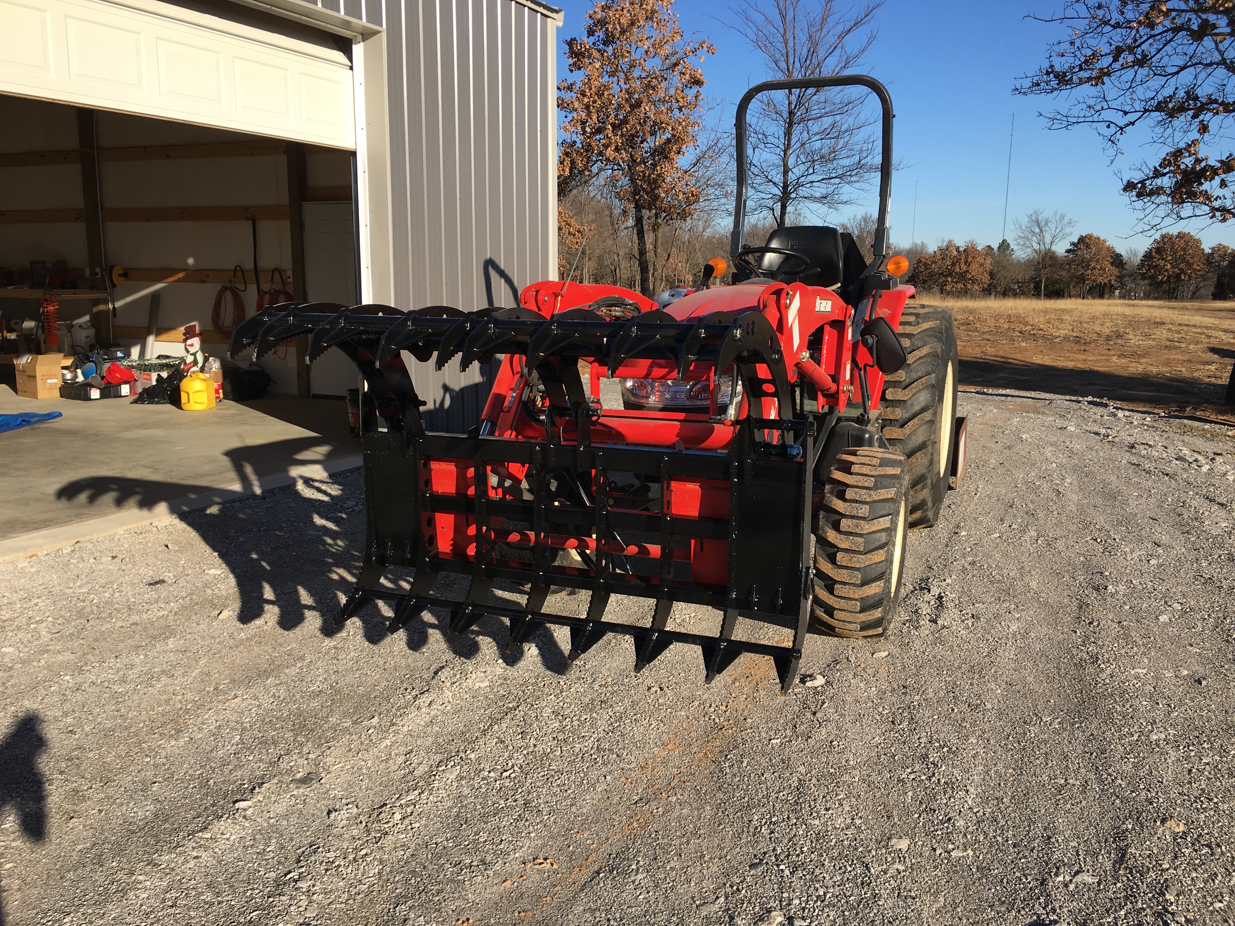

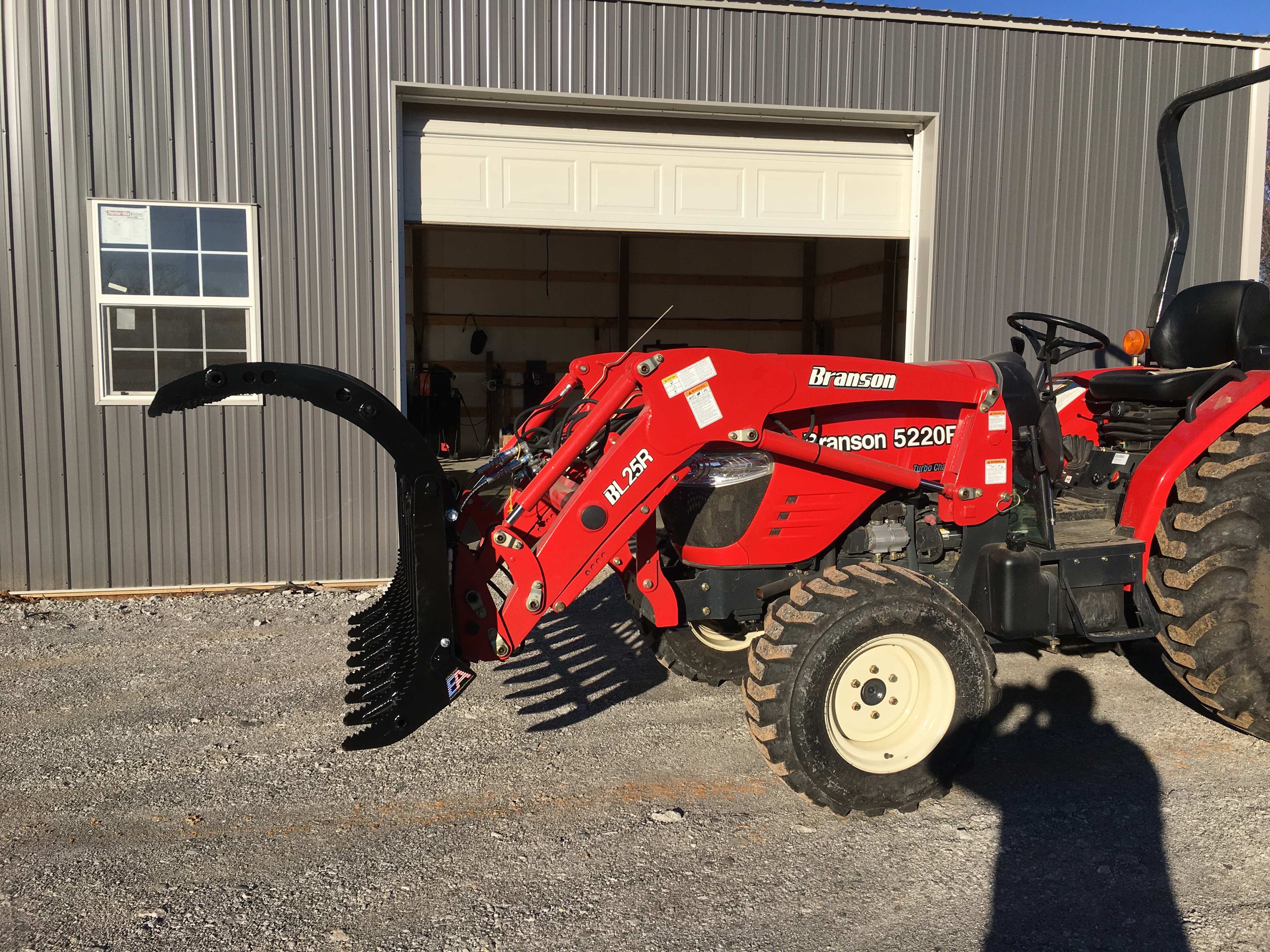

I wanted to provide an update on my FEL lift issue. Simply, the grapple sold by my dealer was to heavy. My new EA wicked root grapple arrived and I quickly found the tree that I was unable to pick up with my tractor.
Well the new combination works perfect! I am pleased with my new toy (tool).
