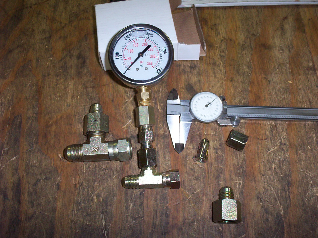

The following are Weatherhead part #'s.
C5706x4, C5706x6, C5706x8, C5706x12. These are JIC street run T's in sizes 4 thru 12. With these, you tap into the line you want to check the pressure of and run the T to your gauge.
C5015x6x4, C5015x8x4, C5015x12x4. These are JIC reducers and need the nut that follows to work. They reduce from the T to the gauge.
C5105x6, x8, and x12. These are the nuts for the reducers.
I also like about a 2' piece of 1/4" 2-wire hose to go from the T to the gauge. Makes life easier.
The pic below shows some of the fittings. There are also 1 piece JIC reducers which is in the pic. It doesn't matter which one you get. Everything I list should be able to be bought locally for a hundred bucks or less, ballpark price. I would have to look up everything individually to give an exact price.
Good luck, Andy.

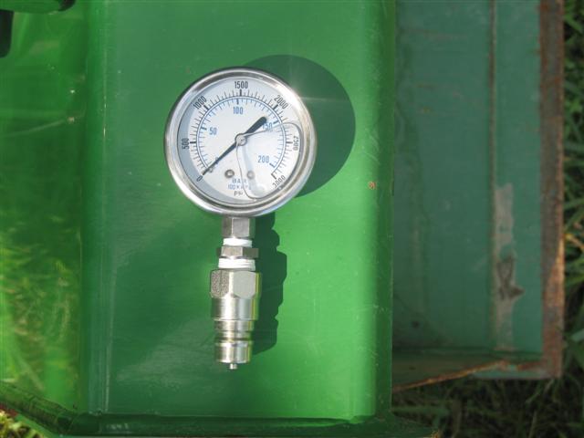

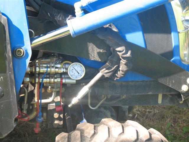

I raised the rpm today at 2200 rpm the pressure gauge showed 2000 psi.
I don't know if you can read it in the picture.
133 psi would this make a difference?
