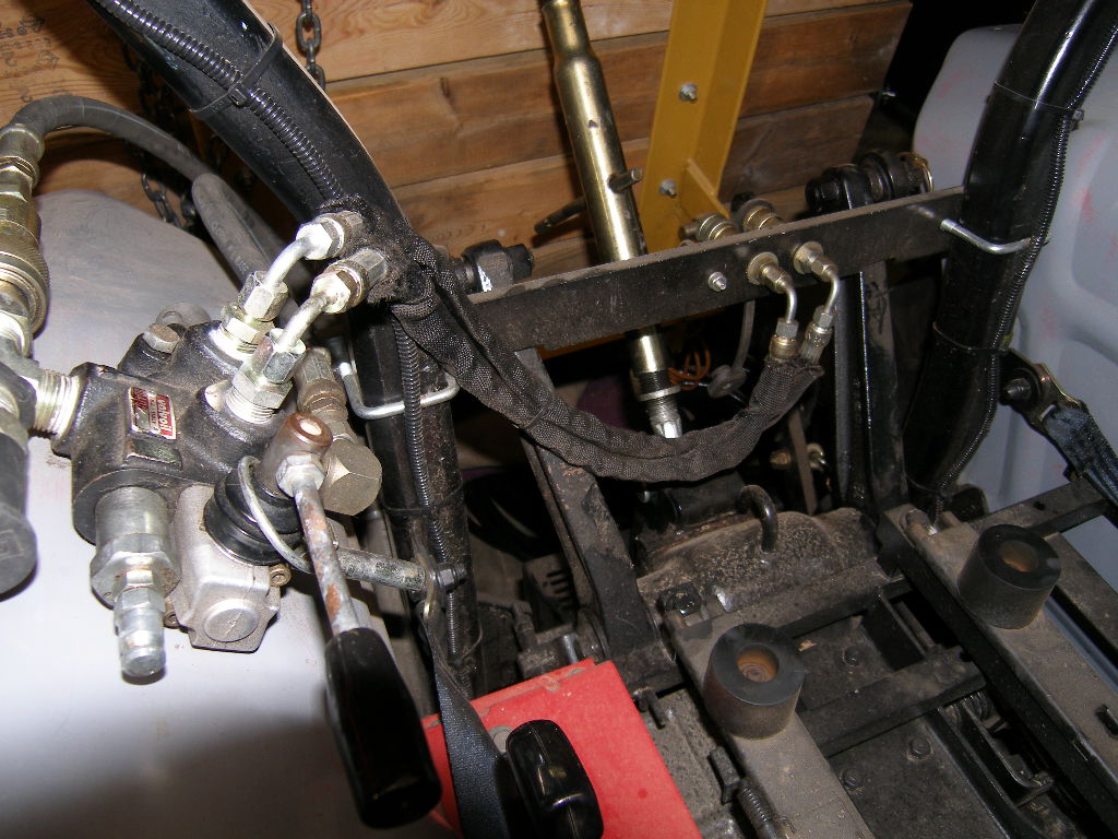

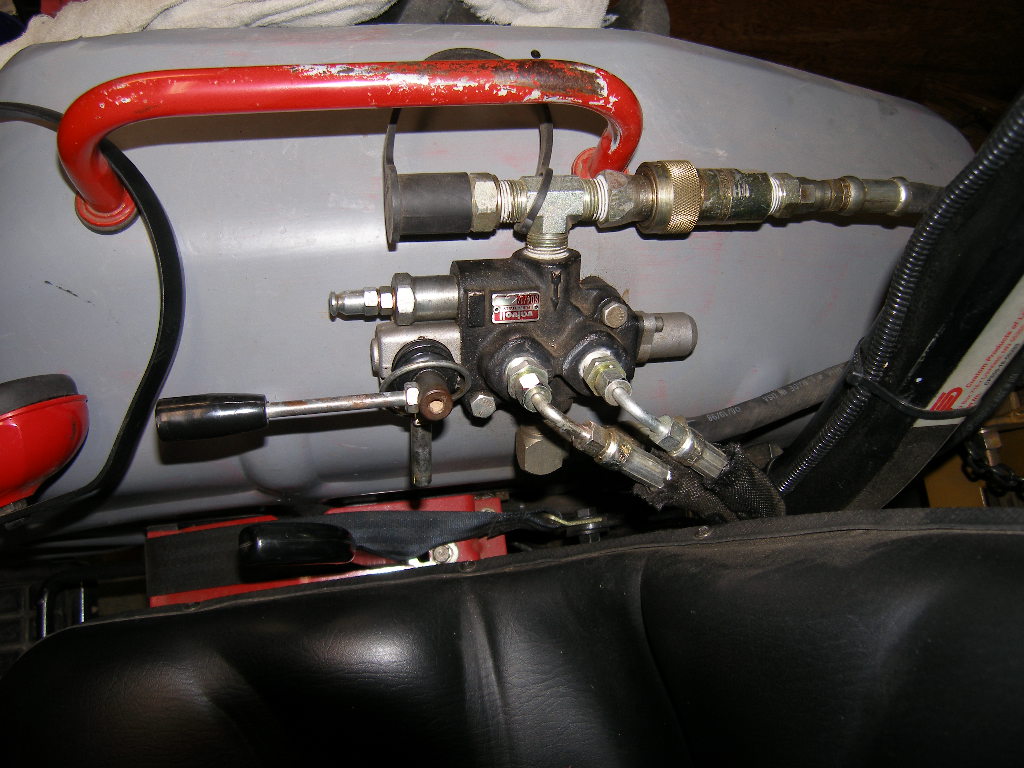

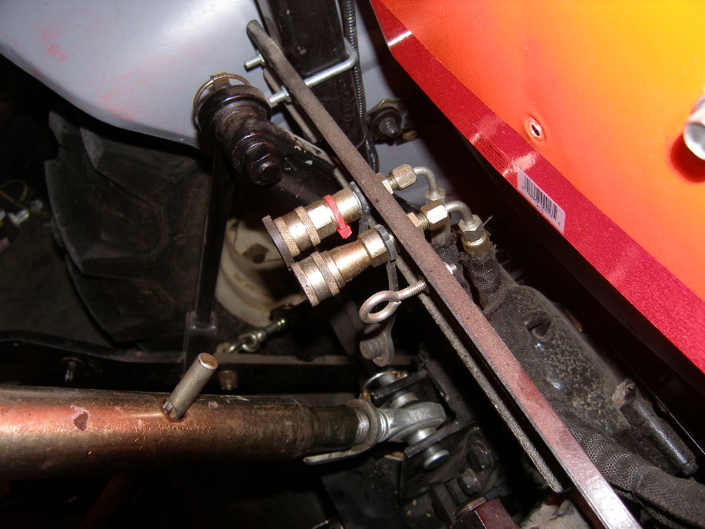

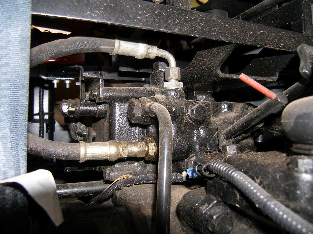

I have a 2301D that has an aftermarket FEL installed. I now want to replace 1 lift arm leveler on the 3 point with a hydraulic cylinder. I'd rather not tee into the supply line to the FEL if I can avoid it. Is there a source at the rear of the tractor that will supply high pressure to run the cylinder?
/ Hydraulic pressure tap #2
choffman41,
If you click on the following link and read the discussion from several months ago, I posted some information regarding adding remote hydraulics to a YM2310D using the tap ports on the hydraulic block beneath the seat. The YM2310D is the shuttle shift version of the YM2301D so I would expect that you have the exact same hydraulic setup as mine.
http://www.tractorbynet.com/forums/yanmar/43657-remote-hydraulics.html
Since this original discussion I added a ROPS bar to my tractor and this provided me a convienient place to add a mount for the quick disconnects. The following are pictures of the remote hydraulic installation on my tractor.

Thanks John, that helps a lot, however, mine has a short hose that seems to connect the I port to the O port rather than having plugs in it. I don't understand what that's about, but I guess I can just pull the hose and use the existing fittings.
