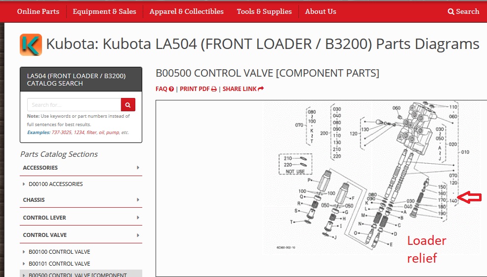

I may be wrong but, I think you are focusing on the wrong relief valve. Most loader valves have their own relief valve built in. If I am correct that is the relief valve you have just tested.
Do you have power steering as I cannot find any manuals specific to your tractor and tractordata.com shows no earlier nor later models..
How many hoses connect to your loader valve? 6 or 7.
Before you go adding any shims I suggest you/we need to fully understand your system and where you are adding shims.

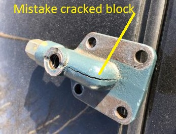

Be patient, increasing by 50 to 140 psi wont make a difference you will likely notice! You don't get a second chance with hydraulics. In an instant something is broken beyond repair.

Thanks for the input Dave. The B3200 is a hydrostatic tractor. The relief valve in the loader is the one I'm looking for. BXpanded included directions specifically showing how to run the test and what valve requires the shims to be added. However, they don't tell you how many PSI each thickness shim corresponds to. I just saw a post from someone with a B3300 - basically the same tractor as the B3200 and he got a boost of 80 PSI with a .2mm shim. If the math is correct then I'm planning on using a .3 and .1 shim to equal 160 PSI increase. I'll test it again after adding the shims. If it's too high then I can take the smaller shim out and retest.
