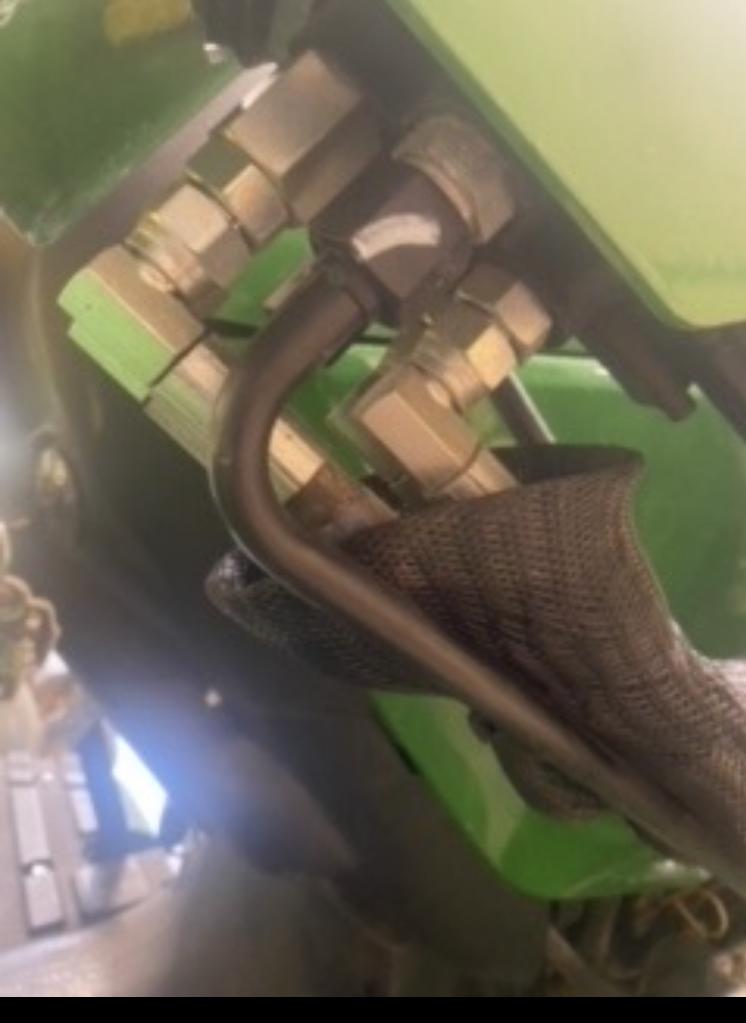

John Deere 3038e
John Deere 3038E with D160 loader, no third function or remotes.
Looking for a hydraulic pressure tester.
Kens bolt on hooks only has for the two series.
Any help appreciated,
Thanks,Mike

I would email Ken, and ask if he can fit one up for you. I think he can, as he has other size hydraulic connects.
If not, buy the gauge (Ken or Amazon), a hydraulic hose and the required fitting at TS, Amazon or local shop, and make one up yourself.

If you are looking for loader pressures use the hydraulic quick connects they are the easiest to match when you are building your gauge. I prefer T-ing into the line so I can see pressures as the attachment works. instead of just dead heading the system at the quick connect.

The E model has no quick couplers, the loader isn't quick disconnect. That's why the OP sent the pictures.
I bet the 2 and 3 series tractors have the same size hydraulic lines for the loader.
Using a T and installed permanently, the gauge can also be used as a scale. Just need to associate the displayed pressure with weight.
Don't cheap out on the gauge if permanently installed. If the gauge fails and leaks you're stuck dead.

leave it to deere to cheap out on the simplest upgrades. So I guess the loaders are not removable (atleast easily)
kind of hard to identify fittings when they are still attached.

The E stands for "economy" and it is you get what you pay for. Want deluxe, go to the R series. Get to pay for the "extras".
Find a connection where you can put in a "T" and plumb your pressure test gauge in there. Take notes from member Bavarian, he said it well. Have some fun with it. Will be a nice upgrade. It's what I did to my wood splitter, to see the pump pressure when splitting oak firewood.
