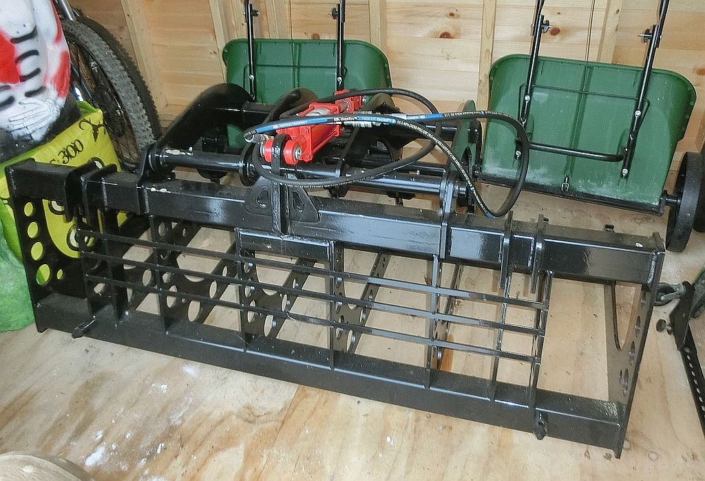

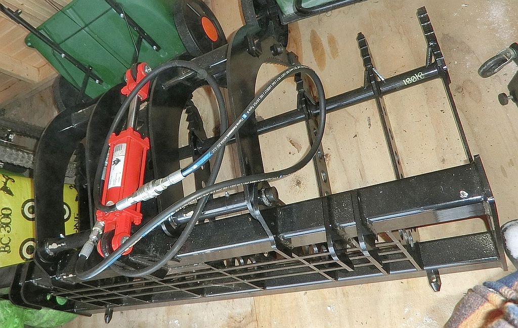

Here are two photos of my grapple that is currently in shed storage. I inserted the hoses into one another just to keep them free of dust and dirt.
Am I correct by writing - (1) the joy stick can be used to raise and lower the grapple. And (2) the SCV lever in the cab on the fender can be used to open and close the grapple. Thanks again, FredSG

   / 4310 Rear Hydraulic Couplings #17

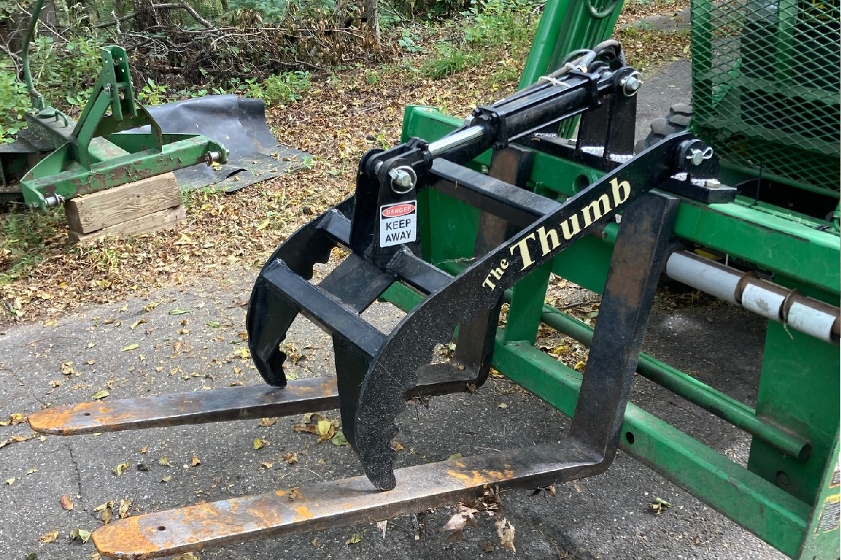

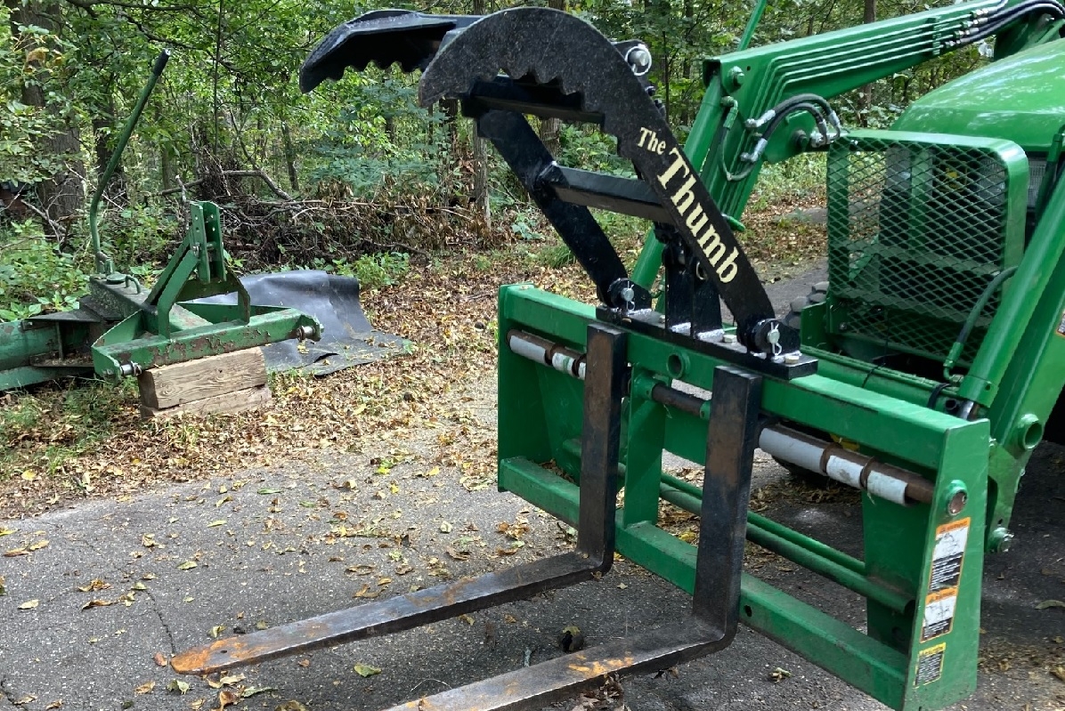

Correct, but also the joy stick will tilt your grapple that is attached to your FEL (front end loader). Just like dumping the bucket when it was used.
A trick, I found, was routing the hydraulic lines from the rear end of the tractor to the front of the loader. Disconnects needed if removing the forks, as well as needed if removing the FEL.
My "grapple" is just a thumb (The Thumb) used to grasp brush and hold logs when using the forks on my FEL.
