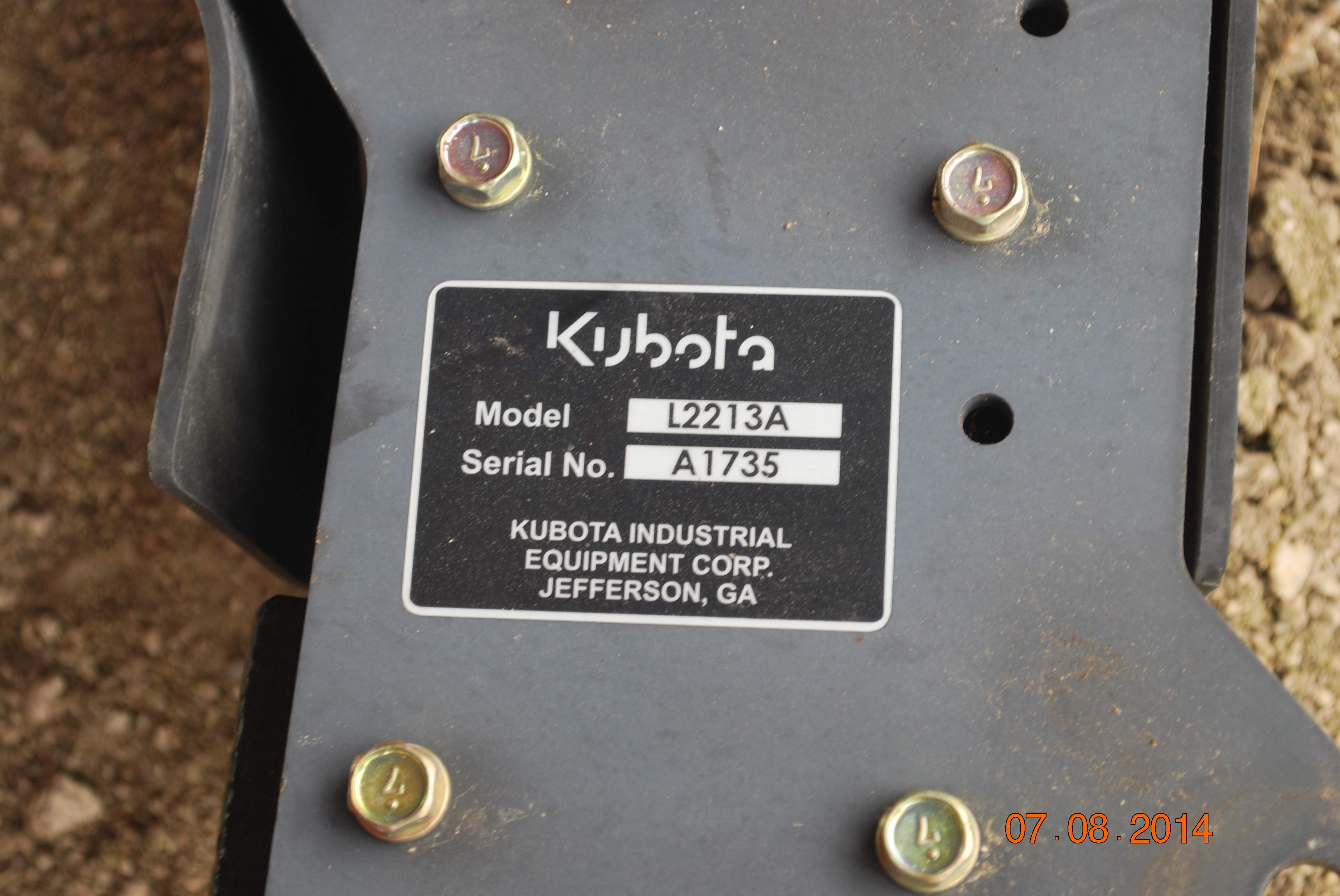

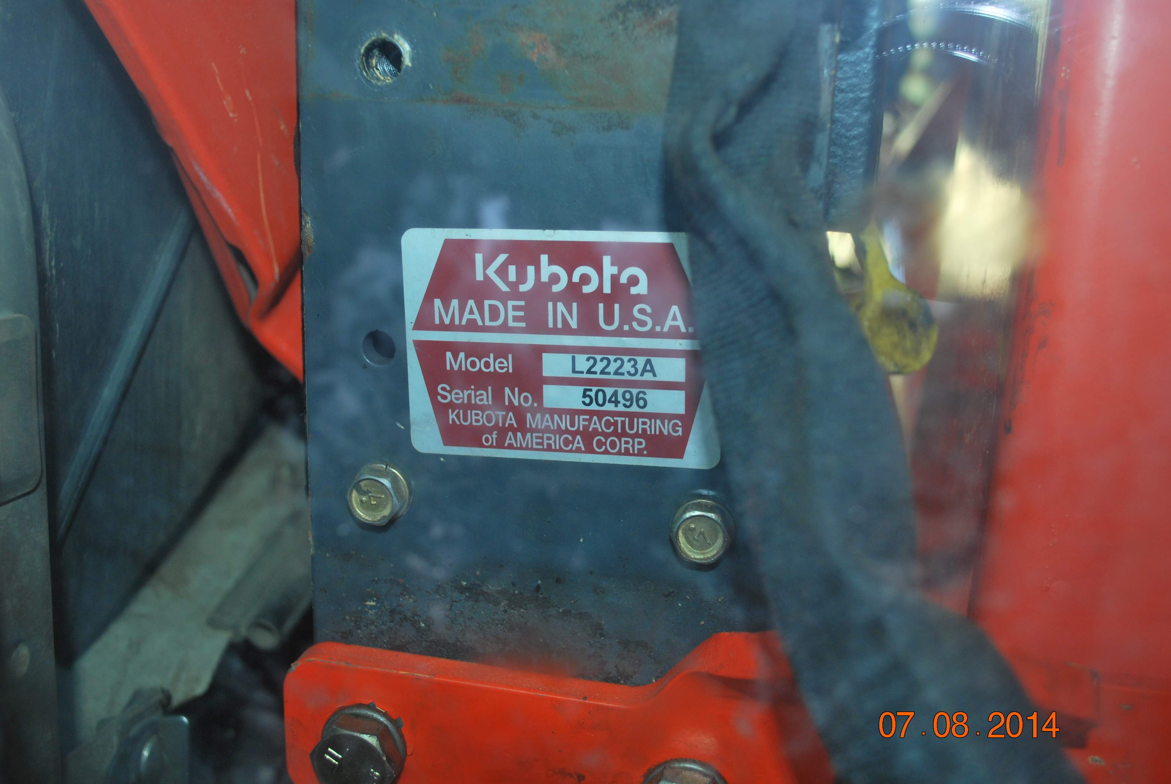

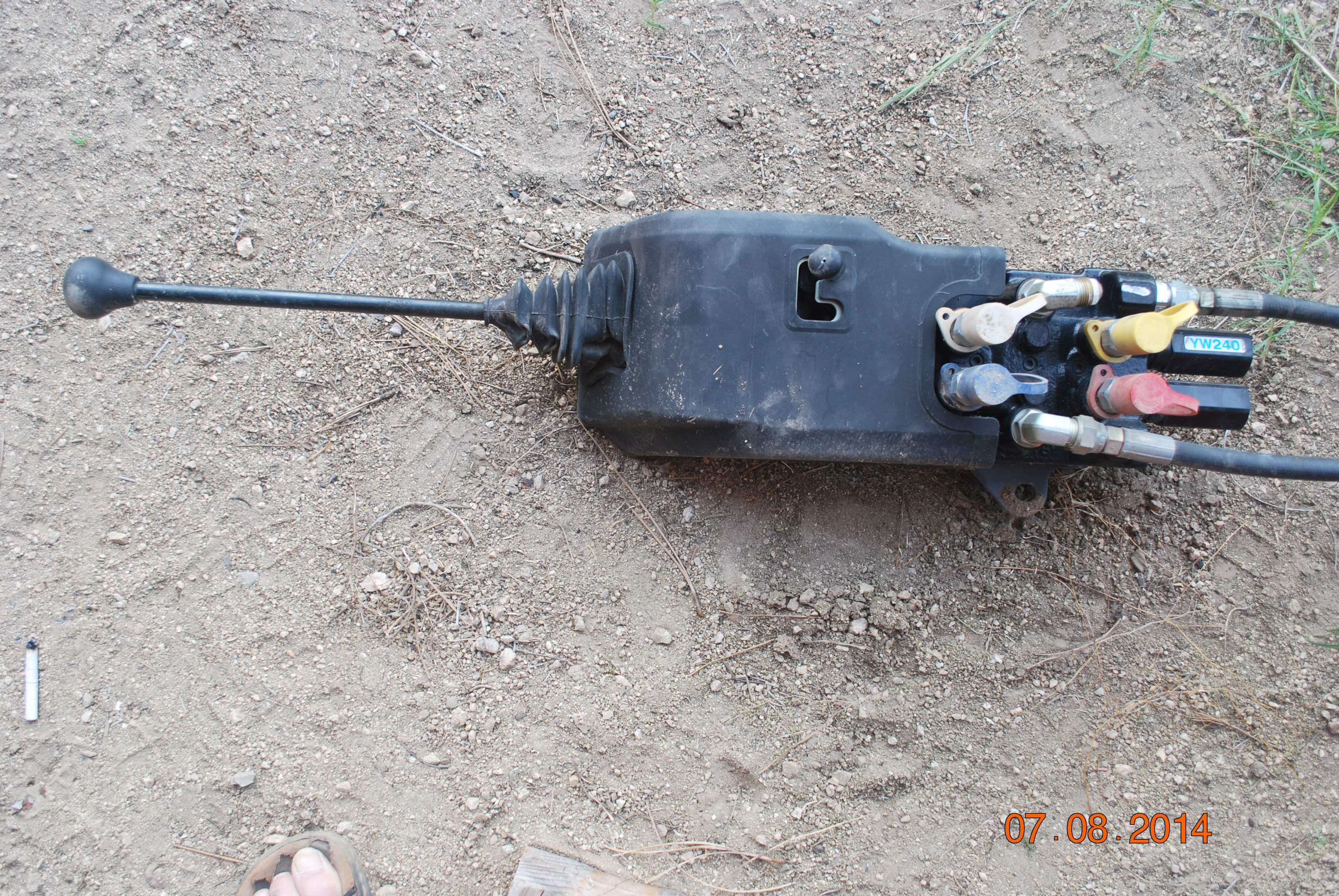

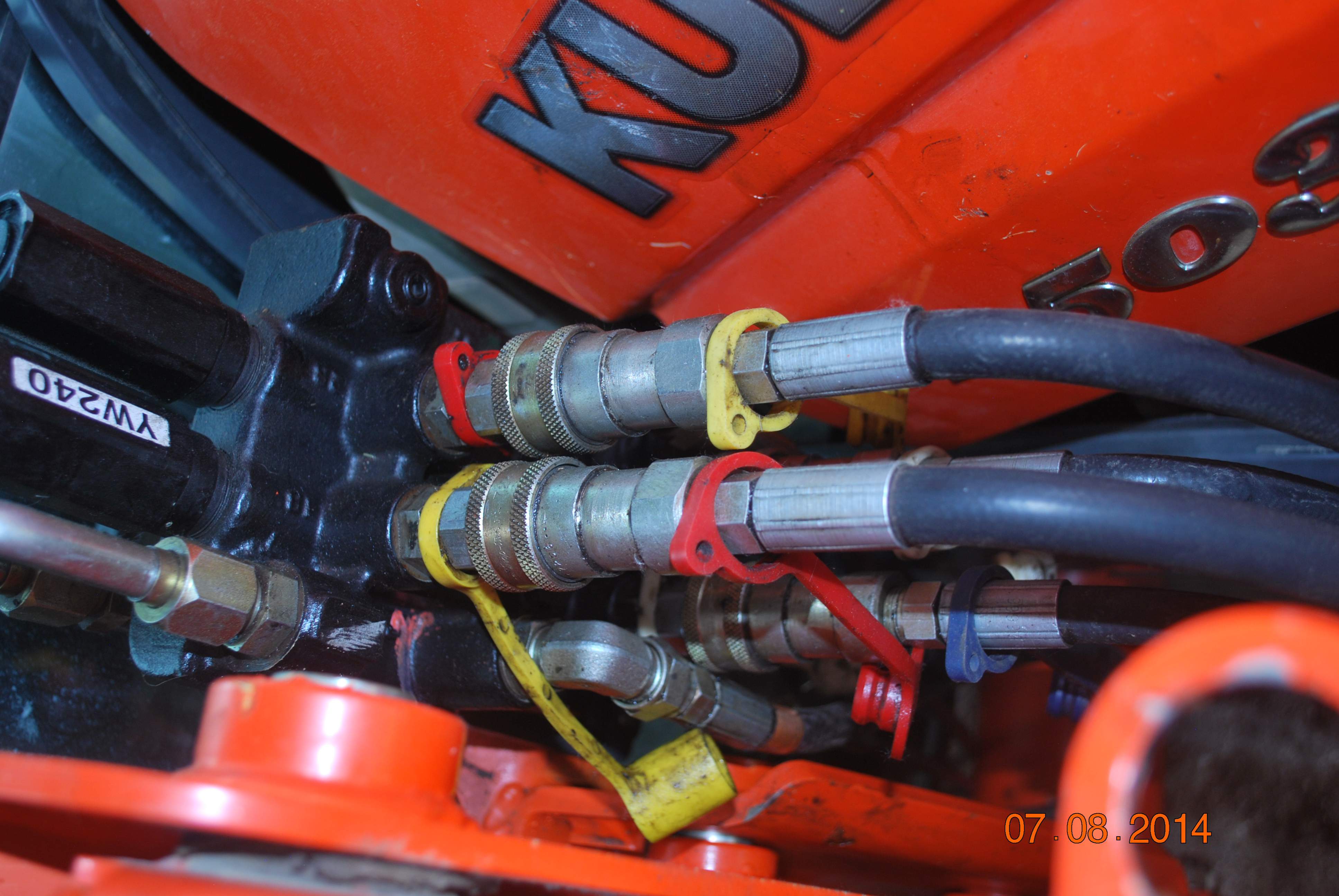

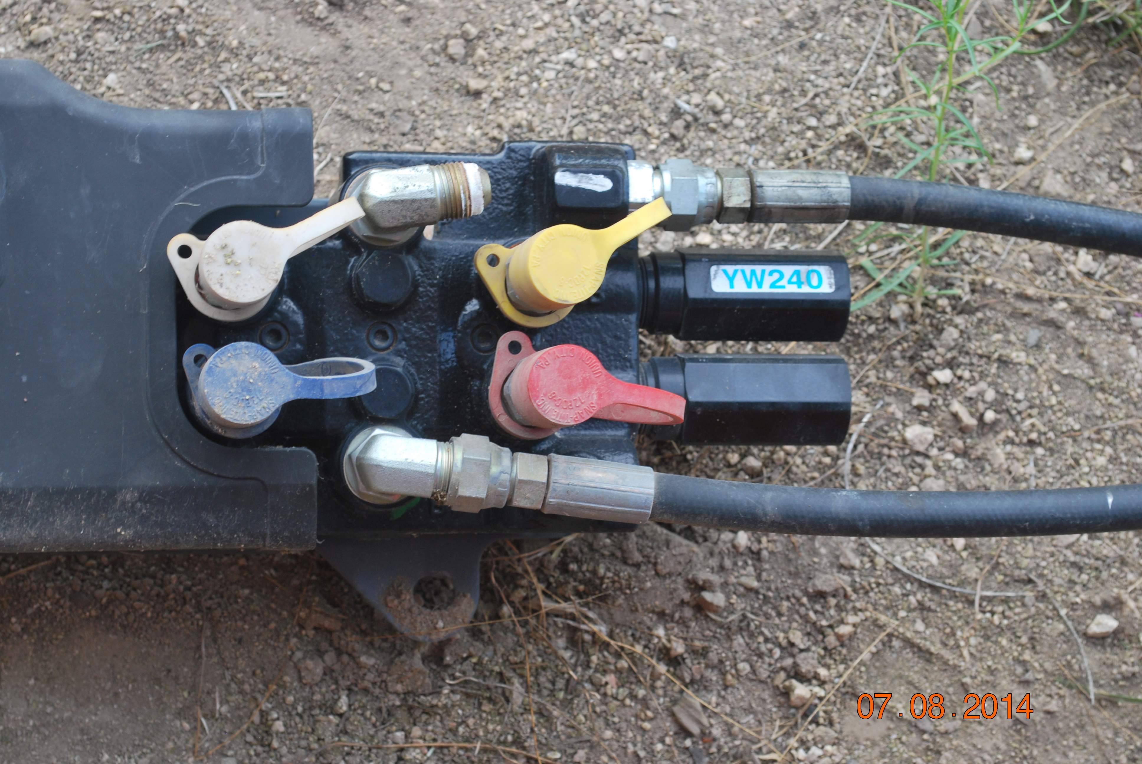

Hear are some pictures of what I have. When I went out to take these I noticed that I have two different models. The "red" block came with the tractor and snow blower when I bought it new in 2004. The other block came with the loader and is the type installed on tractors without a cab. My tractor has the factory cab. The way the QD's are attached in these photos everything works correct except when I push the stick forward the bucket goes up. The only way the bucket can be lowered is by pushing the stick into the float position. If I connect the QD's color to color(red to red, etc.) Moving the stick side to side the bucket goes up and down and moving the stick front to back the bucket dumps and rolls.
View attachment 382091View attachment 382092View attachment 382093View attachment 382094View attachment 382095View attachment 382094
When their connected "color to color" as stated,,
all you have to do now is,, swap them ( the two with the "GREEN" arrows with the other two,
So if you put them "color to color" ( like you said earlier ) and take the two with green arrows and put them on the inside, this should now make your loader work "the" opposite of what you stated,
and this, I believe is what you want.

I tried your idea, however, when I moved the stick in any direction you could hear/feel the pump working but no fluid would come out of the valves on the cyl block. I had another post saying to connect the hoses color to color and swap the two hoses coming from the hydraulic block. Whats your thought on trying that. He said to do that because the cly block on the tractor and the one that came with the loader are two different models.

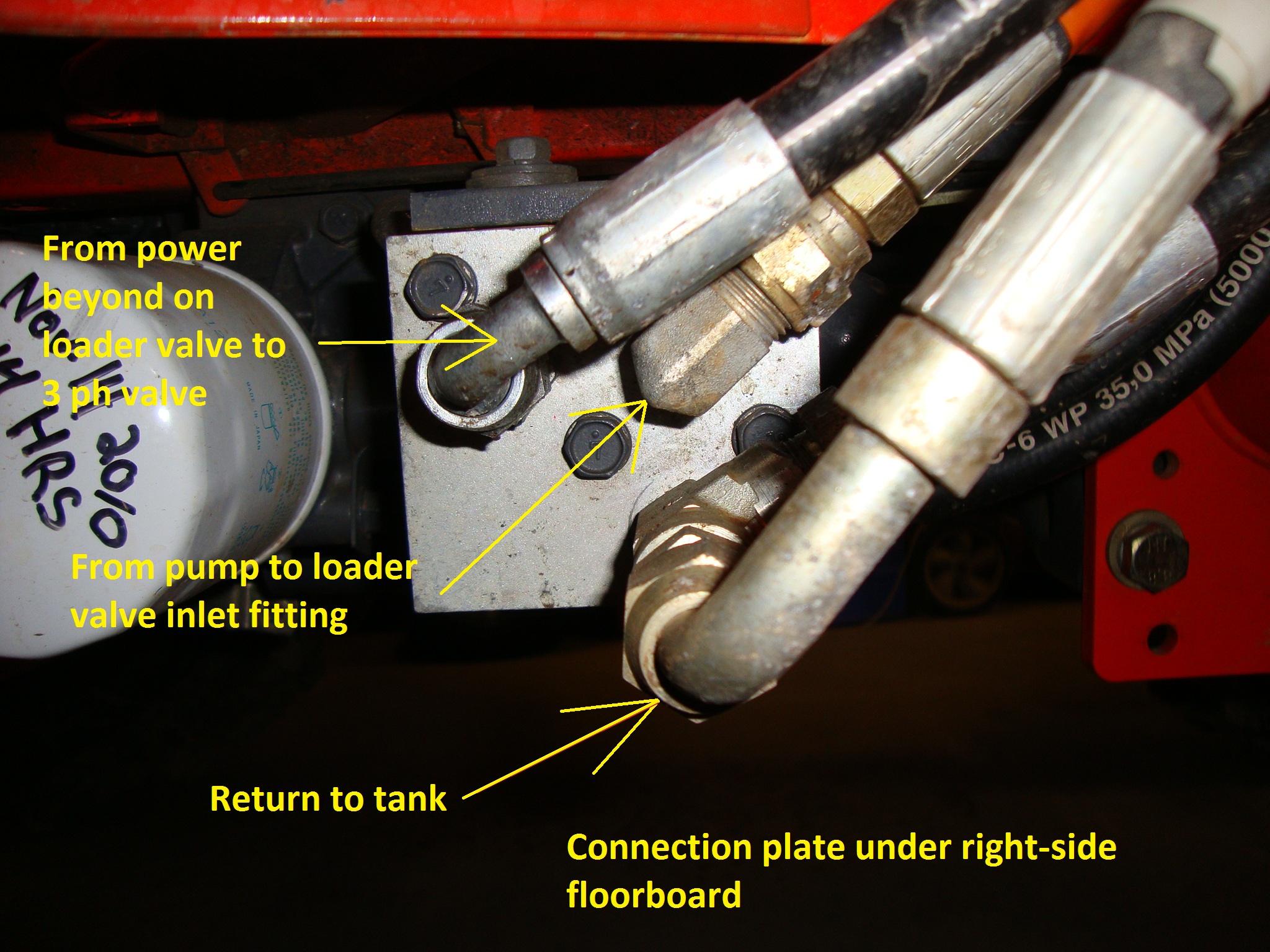

'On the hyud block, you probably have a pressure, a PB , and a return.
The three hyd block ports have to be connected correctly for the FEL valve to work.
Your hyd block should look something like this. Your ports may be located different.
Your manual should tell you the correct ports.
Pressure from hyd blk goes to FEL IN port.
FEL PB comes back to hyd blk.
FEL return comes back to hyd blk.
Then connect the cyl hose correctly.
You have to get this right as the flow in an open center is a series path and fluid is flowing at all times.
