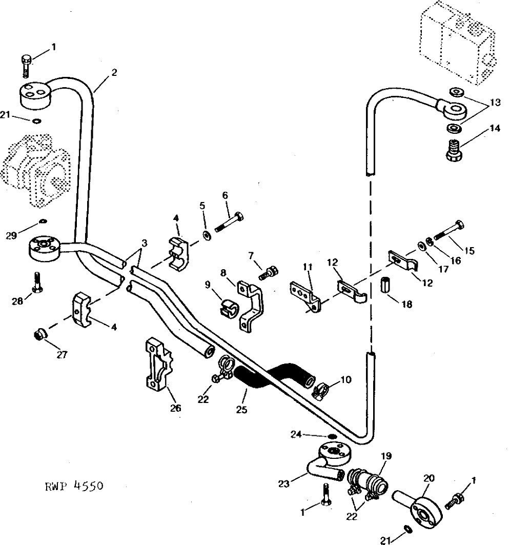

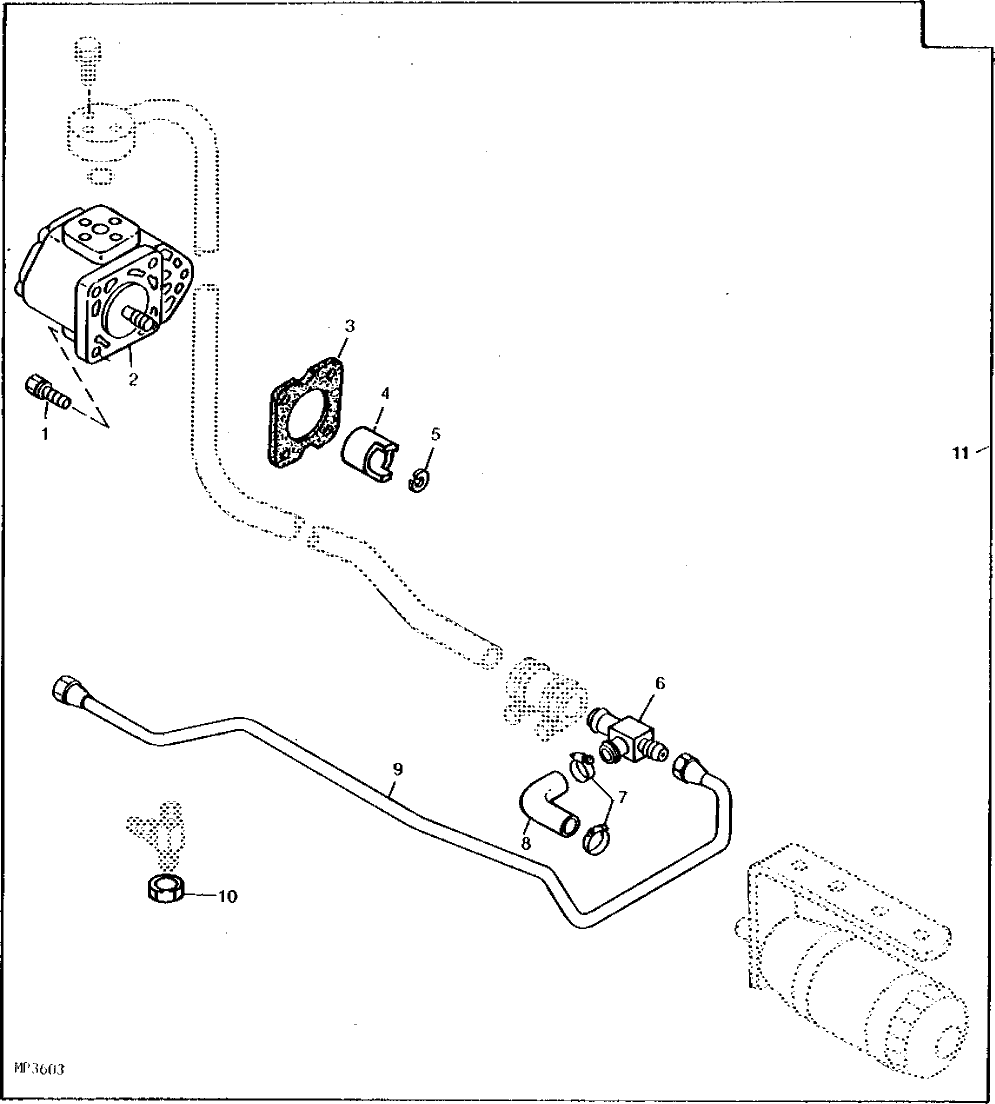

I assume when you say enhanced hydraulic kit, you mean increased capacity steering kit. The elbow hose in the enhanced kit is still available. Part number is CH13993. The double elbow hose shown in the other diagram is still available, part number CH13769 but I think that hose is not used when enhanced kit is installed. The straight hose, part number CH13767 is not available under that number, but deere does sell bulk hose the same diameter under part number TY24402. It comes in a 10 foot roll but most dealers will sell by the inch or by the foot. Good luck!
