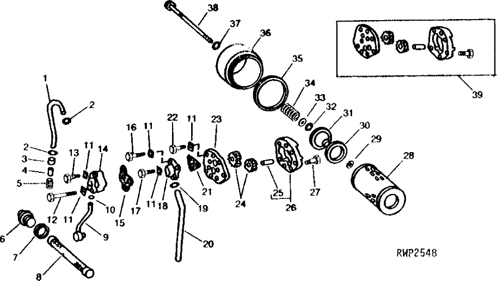

Today went to try to take the 3020 john deere in the field but the loader want go up or down. I check the fluid it was full the rear hydraulic goes up and down. The bucket or the arms don't move I think the pump is out if it is the pump do you recommend a new one or rebuild it. Or do you think it is something else?

Check hyd pump coupler between engine crankshaft damper & hyd pump to be sure it's not stripped out and pump shaft is turning with engine. How long since hyd filter was changed and sump screen checked/cleaned?
Where is the sump screen and the filter located at.
   / hydraulic problems #5
Hyd filter(parts key 28) is on LH side behind the battery. Sump screen(parts key 8) is between hyd filter & rear axle housing.
