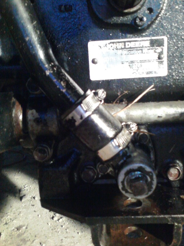

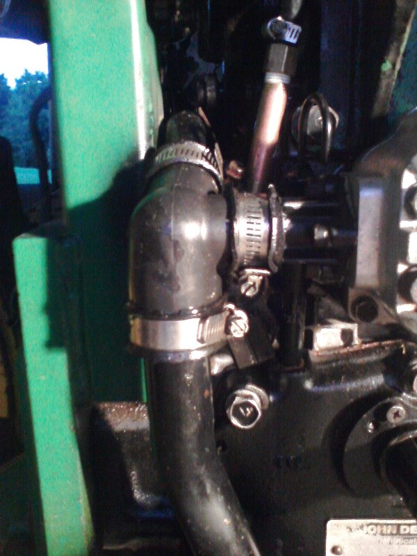

I guess I'll try replacing those rubber pieces next. Afterall, they are 20 years old. The lower one is pretty cheap, but the upper 3-pronged one is $52.

The new rubber couplers for the suction line came in today. Picked them up after work. Drained the oil and pulled the old couplers off and installed the new ones. The old couplers were hard as a rock whereas the new ones were soft and flexible.
Since I had to drain the oil to change the couplers, I removed the strainer out habit.... anytime I drain the oil, there is no reason not to go ahead and check/clean the strainer. Since there is very, very little run time on this batch of oil... only an hour or two with most of that time spent diagnosing the PTO problem, I was quite shocked and concerned at the amount of tiny metal flakes found on the strainer and in the amount of oil that drained out of the transaxle after pulling the strainer. There was a fair amount. I know it's hard to quantify "quite a bit", but it is way more than should be ther after just an hour or two of operation. Other and one or two laps around the property, all of that time has been spent with the tractor sitting still while I worked on the PTO issue.
I went ahead and put it all back together and tried the PTO.... same results as always. Well, I guess there was one little twist that was different this time. Normally, the PTO would engage at around 100psi or above. I was reading 110psi on the gauge with the PTO turning. When I cycled the PTO lever off, it took an extended period of time for the pressure to drop to zero instead of dropping immediatly like it had been doing. When I cycled the PTO lever back to the ON position, the circuit built 110psi, but the PTO would not turn.
Based on my findings tonight, I'd say that there more than likely something internal that is jacked up. Given the amount of metal I found in the strainer, it has me thinking that the PTO clutch pack is wasted. I feel that I have no choice now but to remove the transaxle and disasseble it for inspection. :mur:
Either that or drive it off into the pond and forget I ever bought it. :laughing:

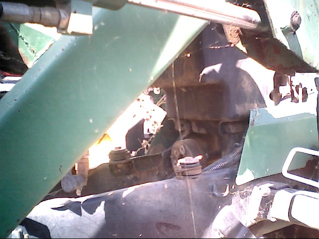

   / Hydraulic PTO issues ..... flow divider??? #37
To remove the driveshaft, I'll have to remove the fuel tank.
As I recall, when you remove all the sheet metal, you can detach the
driveshaft at the U-joint just above the filter between the frame rails. Or
you can disconnect the shaft at the rubber coupling below the fuel tank
without removing it. That allows you to keep the HST/gearbox all together.
If you take all the linkages out, you can toss the levers used as a
mechanical interlock system for the go-pedals.
   / Hydraulic PTO issues ..... flow divider??? #38

You have to loosen the clamp bolt on the u-joint yoke at the transmission, but you have to slide the d-shaft forward to slip it off the trans input shaft. In order to slide it forward you have to take it loose at the rubber coupler. With the engine still in place, the only way to slide it far enough forward is to angle it upwards and to the side. Even then, it has to angle up higher than the bottom of the fuel will allow, so I have to pull the tank. The HST has to be removed just to get to some of the bolts that hold the transaxle to the frame..... unless I could one of those nifty Japanese wrenches that those little handed guys must have had to put this thing together.
Believe me.... I just put half of those things back in the tractor. If I didn't have to remove all that stuff, I wouldn't. It was not fun putting it in.
