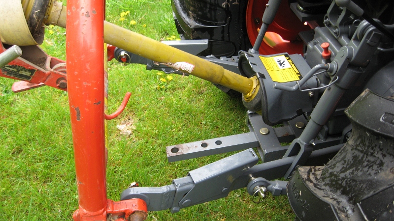

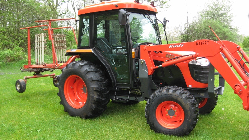

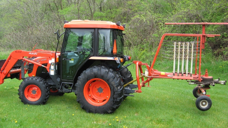

Hi Michigan Iron,
Maybe you could help me out on this one. :thumbsup:
My small square baler and sickle mower start fine with the slip clutch. My Kuhn hayrake starts a little harder than I like. The PTO is tied directly to the gear box with no clutch. I have been wanting to add a slip clutch but with PTO shaft going through the main frame tube and to the gear box I haven't figured out how to do it. Normaly they seem to be at the gear box. I need it to pivot at the frame tube if I could fit one there. These are the best pics I could find.
By the way with the short wheel base of the DK45, this is one great combo for raking hay! With the 3 point mount I can lift and turn without crossing over the end rows. Great for point rows as well.

Just idle down when engaging. I would never want to set a slip clutch loose enuf to slip on startup. Thats flirting with burning it anytime you run into a heavy load on the implement.
