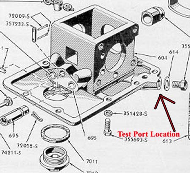

Your pump is worn as most N pumps get. As long as it is working, leave it alone. The scotch yokes have a bit of play. If it is raising/lowering properly and holding for a couple of days, I would ignore it and continue to use it until it starts not operating properly. Parts are available to rebuild your pump if you want to spend the time and money. There is a test port on the pump, on the lower, right side that you can connect a pressure gauge to test it. I've got a procedure and specs around here somewhere if you want to pursue that.
