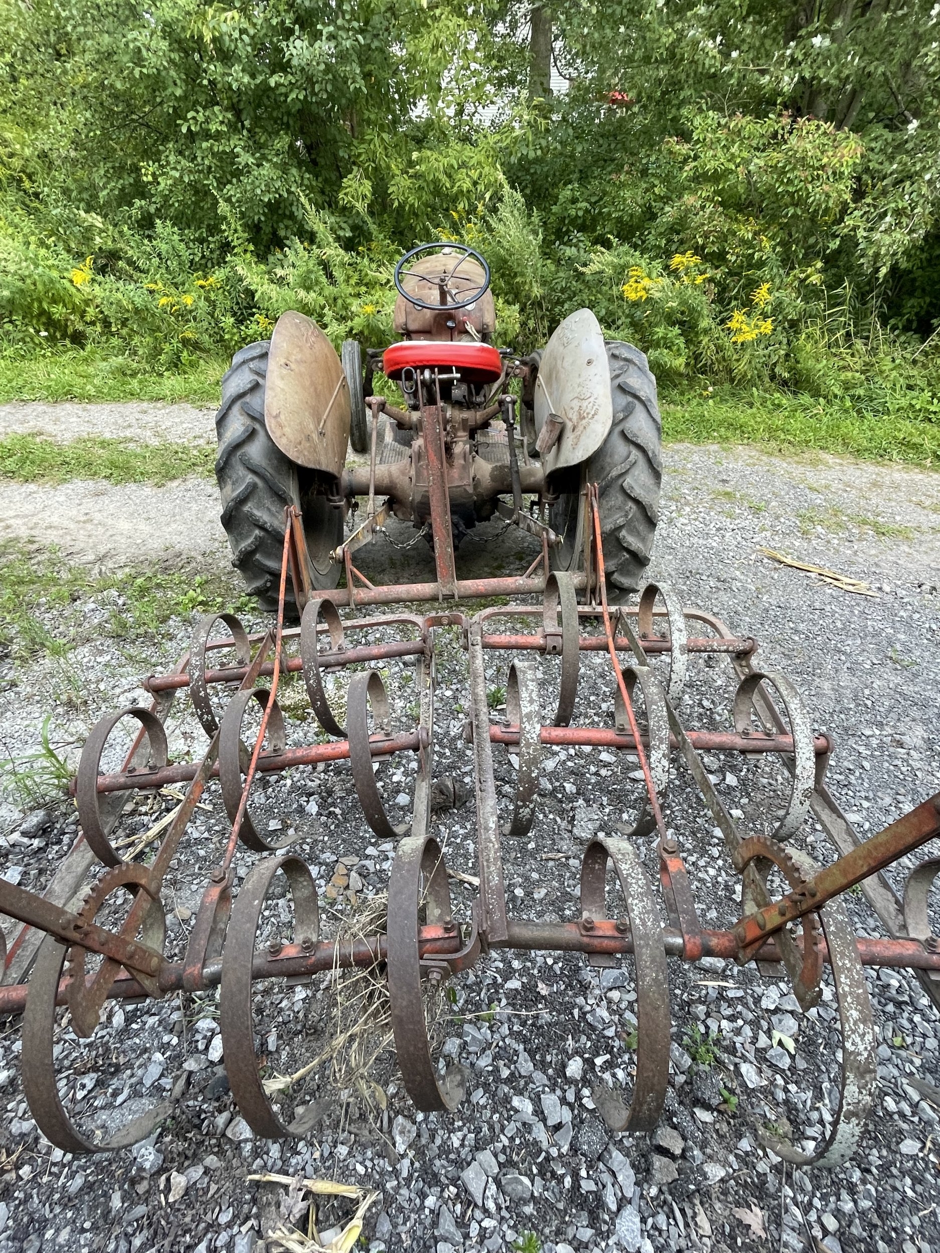

Meanwhile, I’ve got to get my two section drag on it Monday to work up a couple of weedy acres for planting a wheat/white clover mix. It don’t struggle, lock, or make a peep of noise while lifting that 6 ft wide tool.

Considering that my hydraulic oil has only been changed once in 72 years , I’d be inclined to agree with this. I’ll get on that this winter. I think tractor supply still has that “universal tractor fluid” by the 5 gallon bucket, which I think is what I used when I changed it last, back in 1989. It hadn’t leaked any and is still in the “good” range on the dipstick.
Meanwhile, I’ve got to get my two section drag on it Monday to work up a couple of weedy acres for planting a wheat/white clover mix. It don’t struggle, lock, or make a peep of noise while lifting that 7 ft wide tool.

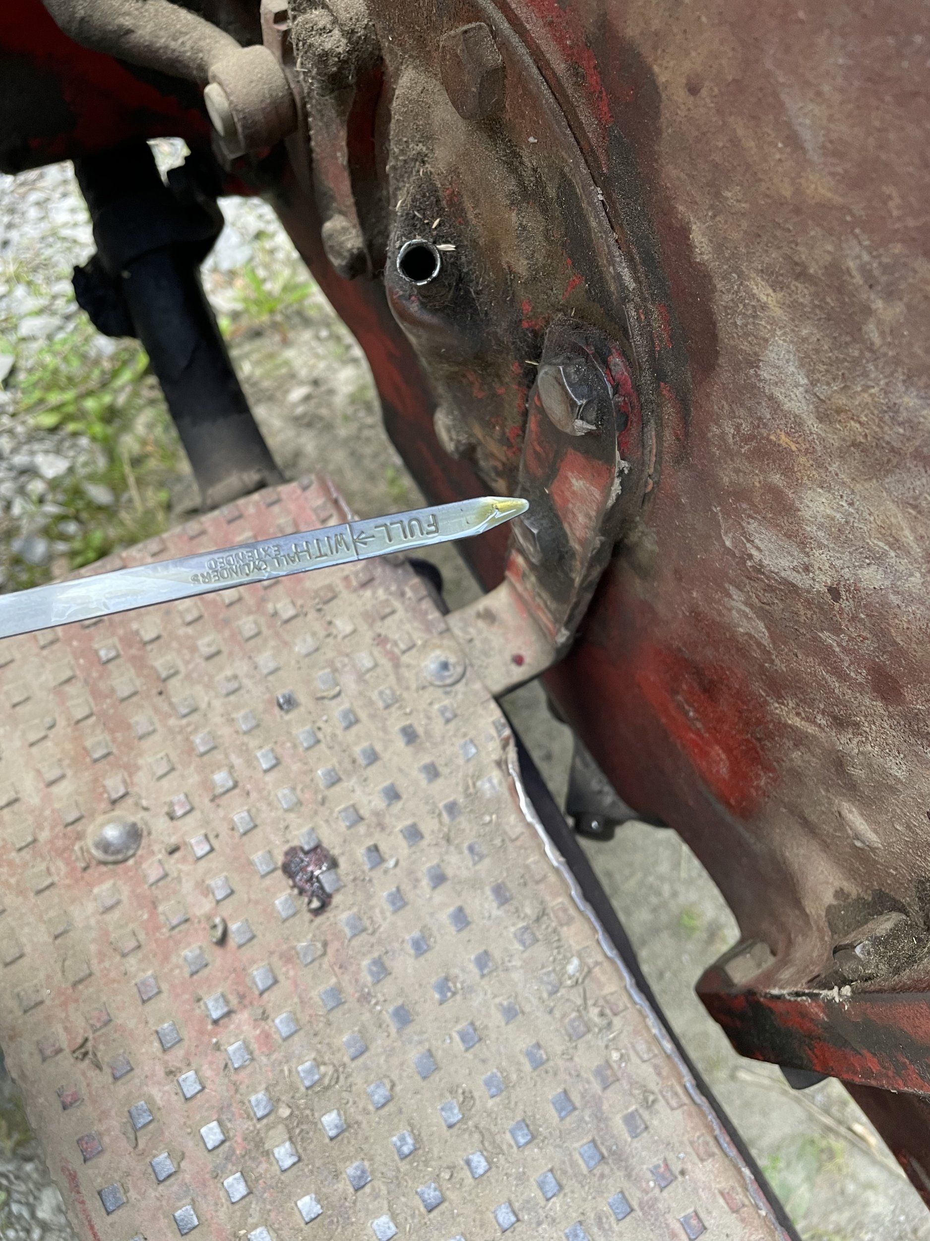

You had me a little worried about the 30 some year old hydraulic/rear end oil in my 51 8n EdG, with those nightmare tales of milky sludge and acetone.

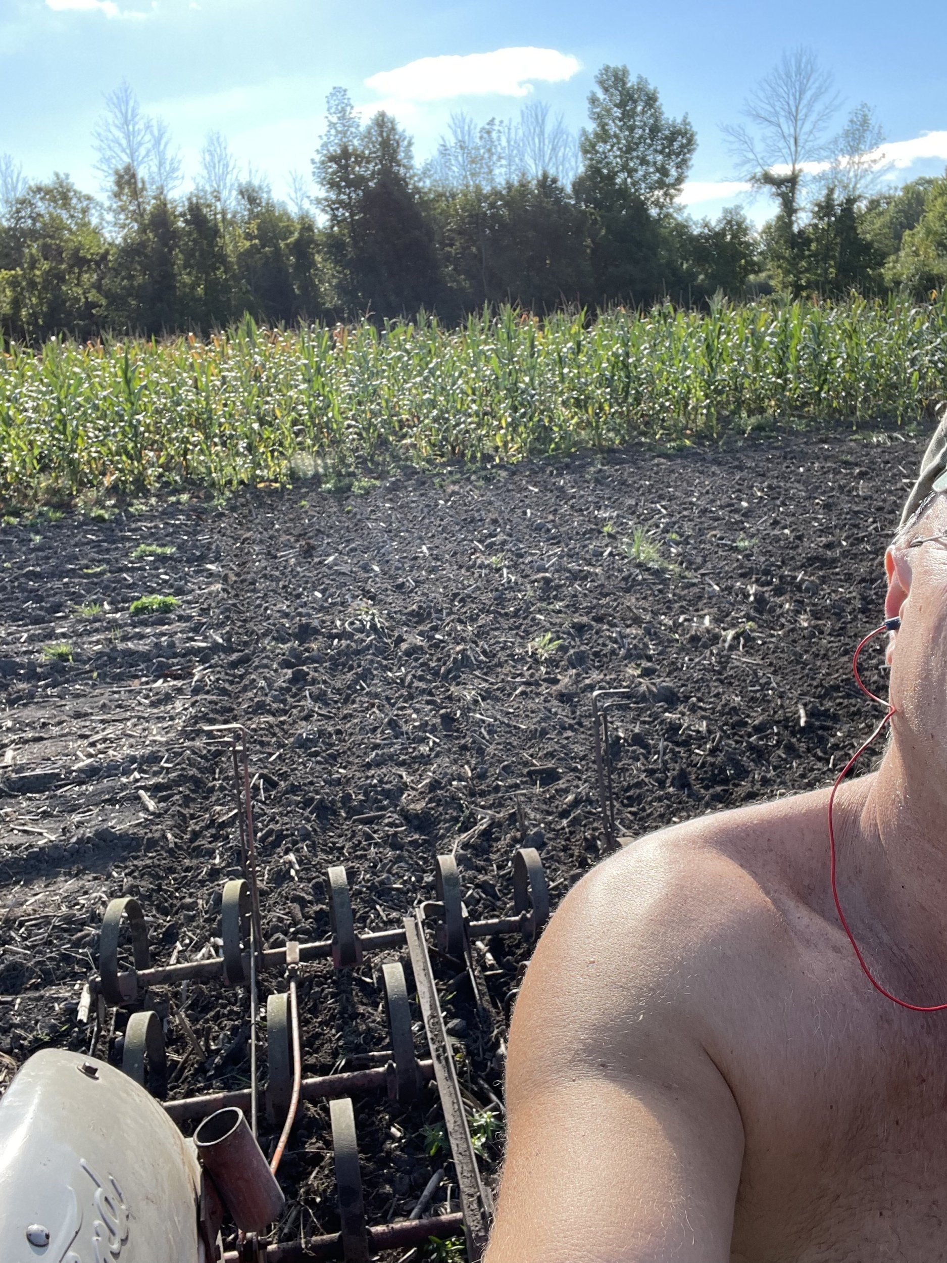

I pulled the dipstick and the oil color still looks good. The old girl lifted that drag without any funny noises. I think I’ll just let my grandkids worry about changing it, in another 20-30 years, if they feel like it. Looks like there’s lots of life left in the oil that’s in it.
Off to the wheat field now, to go over it once before sunset tonight. I’ll hit it again in the morning then sow my wheat and white clover.
