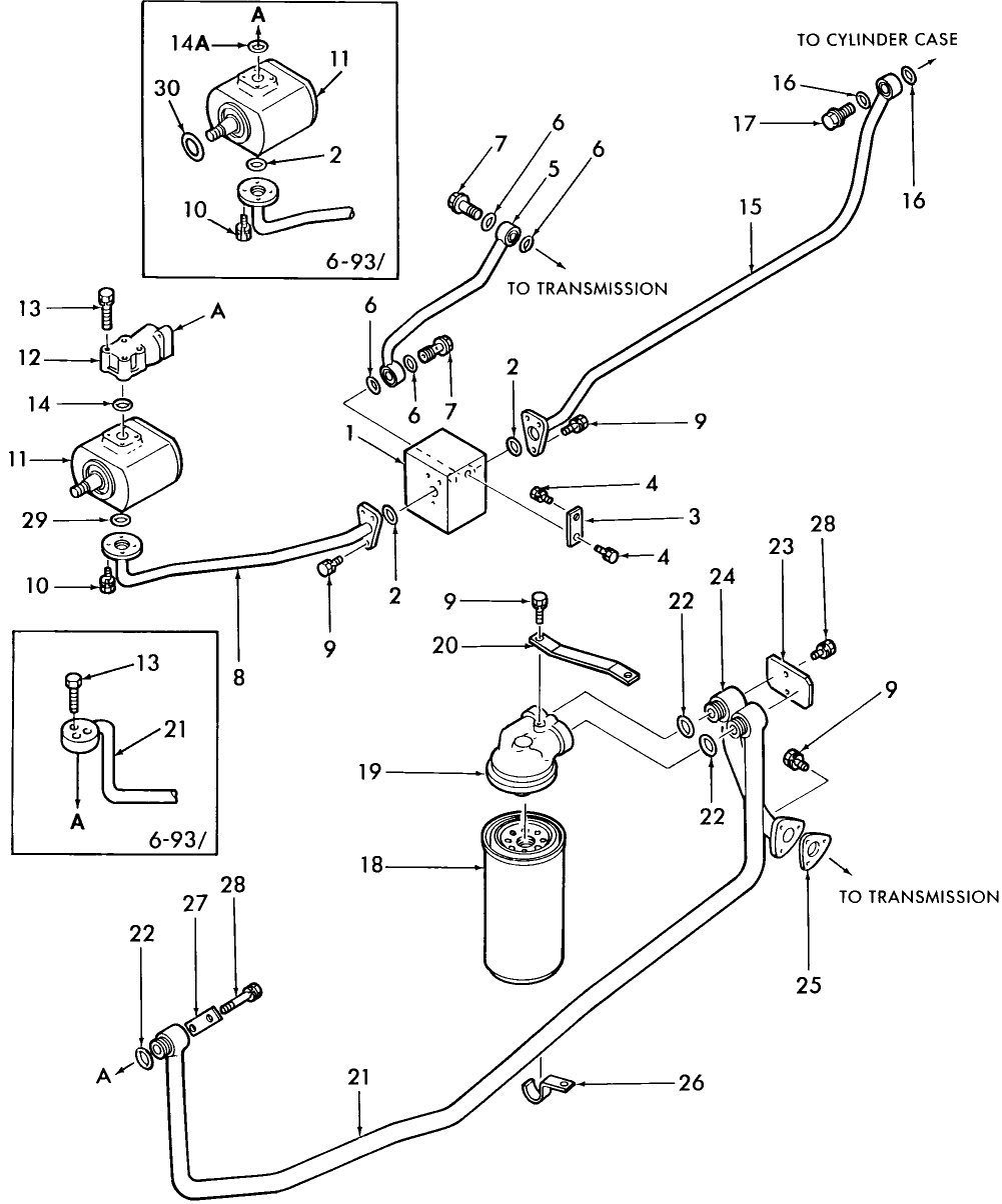

Here's a schematic of the hydraulic piping, filter and pump.
Hope this helps!

Just because your pump won't self prime doesn't mean it's worn out or worn beyond specs.
In order to self prime, this pump would have to pull the oil about a foot uphill, then suck ALL the air out of the new filter you just installed, then suck ALL the air out of the suction line from the filter to the pump. All the air this pump is sucking has to go somewhere. There's a priority valve between the pump and the next valve in the pressure line. A hydraulic pump can't pump air nearly as efficiently as it pumps oil so it can't push all this air through the priority valve and thus .... gets airlocked. Again, this doesn't necessarily mean your pump is worn out or worn beyond specs.
I agree that trying to rebuild the hydraulic pumps on these tractors is a waste of money, especially when a brand new one is only $300.00
Mark
1920's with sound hydraulic systems self prime just fine, thank you very much. I've been servicing them and other NH tractors since 1997, so I have a pretty good frame of reference. There are only two that I see regularly that don't pick up and prime on their own, and they are both high hour tractors that have had many hot suppers, so to speak. You are correct about priority valves making pumps difficult to prime, but in this case, a 1920 is NOT equipped with any priority valving. This tractor has either a suction circuit flaw or a weak pump, of that I am dead certain. A flow test would prove that, and should be performed prior to a pump replacement.

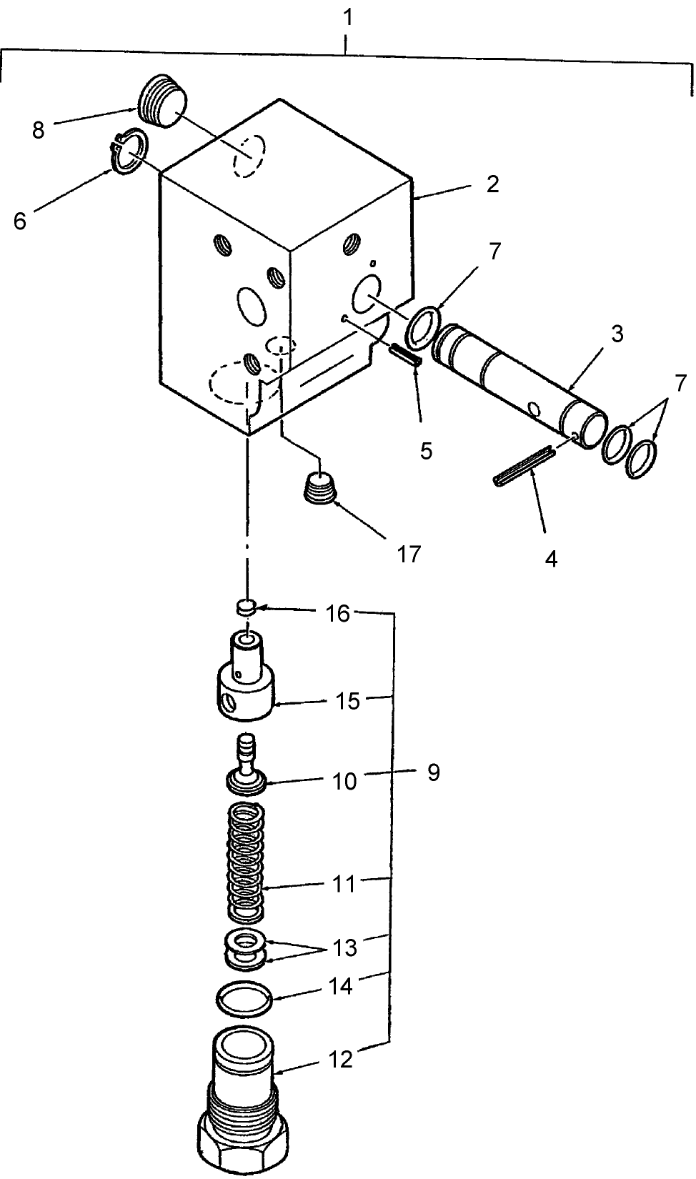

If you look at the schematic I posted from the Ford parts catalog, you'll see that the piping goes from the pump to the "manifold diverter valve" (Item # 1 part no SBA340016640). This may not be a true "priority" valve but it has relief valves and spools inside it much like a priority valve. And those reliefs and spools make it difficult for a pump to push air past them.

One of those methods is coming to places like this to get professional opinions based on years of experience working on dozens if not hundreds of different tractors. If that pump and its plumbing are right, and it has the proper oil and filter in/on it, that pump will prime in less than 25 seconds at 1000 or less ERPM. The OP should not have to jerk around bleeding the pump.
Mark
There is nothing in the diverter block that prevents oil or air from passing through with little or no restriction. I'm fairly familiar with that assembly given the thousands of Ford and NH tractors it is bolted to. Not at all like a priority valve, which will often inhibit the priming of an upstream pump.
