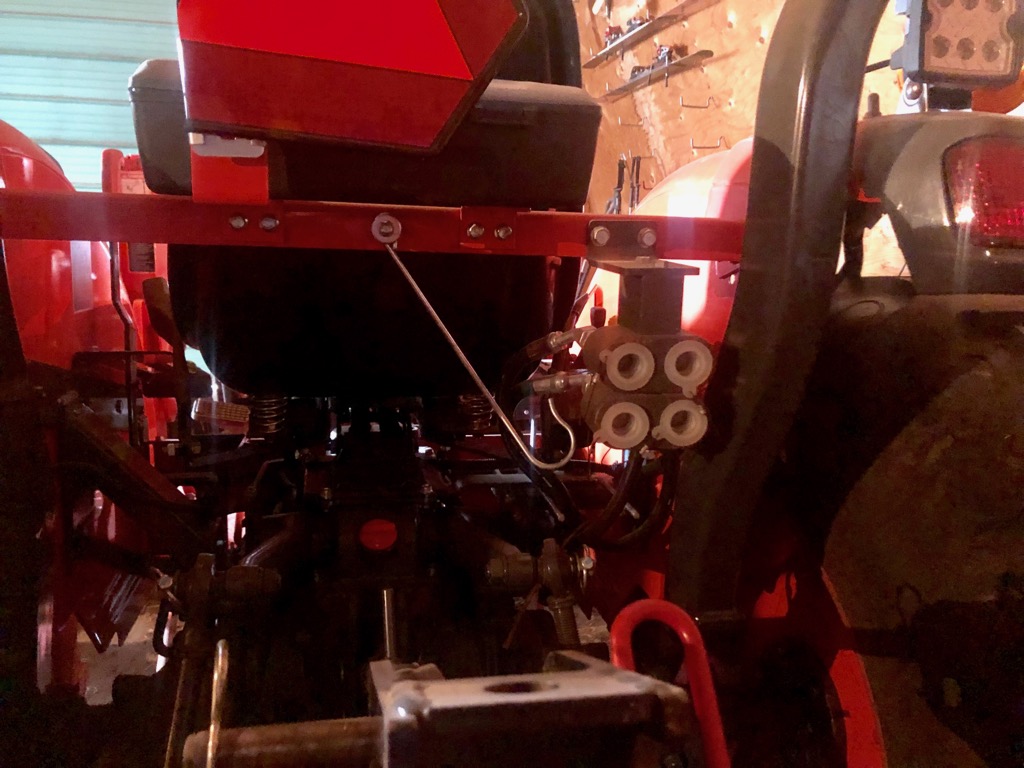

OK
So....
As you will note there are two sets of connectors that are almost in the middle of the picture. I had assumed that I will simply connect both hoses to the post driver to the appropriate set of connectors so that the "from" and the return were dealt with that way.
From what you said, it is fine to connect the "from" to the post driver, but the return should go somewhere else. I have my tractor maintained by my local dealer so I have never put hydraulic oil into it. As you will note, there is a red cap to the left of the connectors. Is that the area you are referring to above?
My apologies for being so stupid!

   / Hydraulic question for post driver #8
Those look like female 1/2" ag connectors, with dust caps in them. That's typical of modern CUTS.
You will need 1/2" male ag connectors to plug into them. They are not threaded. There is a locking collar that you push in to unlock to insert or remove the male coupler. Most tractors use ag connectors but there are other standards too, some that look similar. You can ask your dealer what kind of connectors are on yours. The standard ag type can be had at TSC or similar. They will have NPT thrads on them. Don't use teflon tape on the threads. I prefer Loctite 545 which is made to seal hydraulic threads. If the post hole driver has something other than 1/2" NPT on the hoses you will have to figure out what the use and buy adaptors. Or you can go to a hydraulic hose store or a good NAPA.
Some post hole drivers need a free flowing return. The standard route for the oil would be back into the tractor and through the valve that controls the 3pt. The post hole driver's manual will say if it needs a direct train line to the tank.
