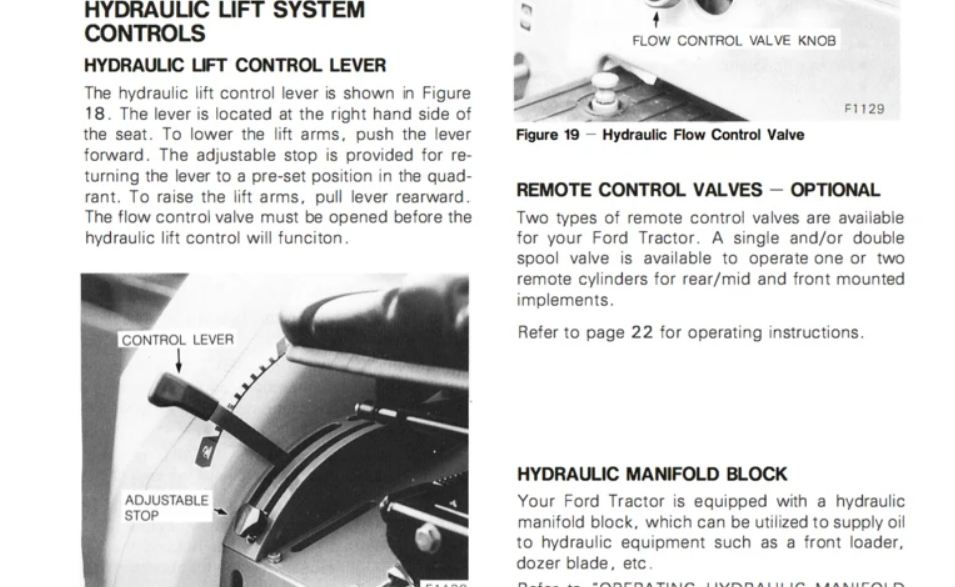

I will have to give that a try tomorrow but I think it was only two positions curl up or dump.
If that is the case what are our other options for angling the blade. The tractor has a set of rear remotes but I didn't see any way to control them
   / Hydraulic question #8
