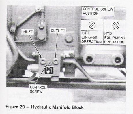

I have attached the photo from the operator's manual.
Mad:
I guess what I was asking is does the in and out apply to the block, or the valve it feeds. I have been researching everything I can find and now wonder if the loader valve was right to start with. The valve has ports labeled "P" "N" and "T". The hose from the block went to "P" and "N", but everything I have found shows "P" as pressure in and "T" as return to tank. I haven't found anything that tells me what and "N" is for. Maybe power beyond? /forums/images/graemlins/confused.gif

I'd be willing to be that due to haw that block has a diverter setup, that the other port that the diverter switch in, is for the external spool... etc.
