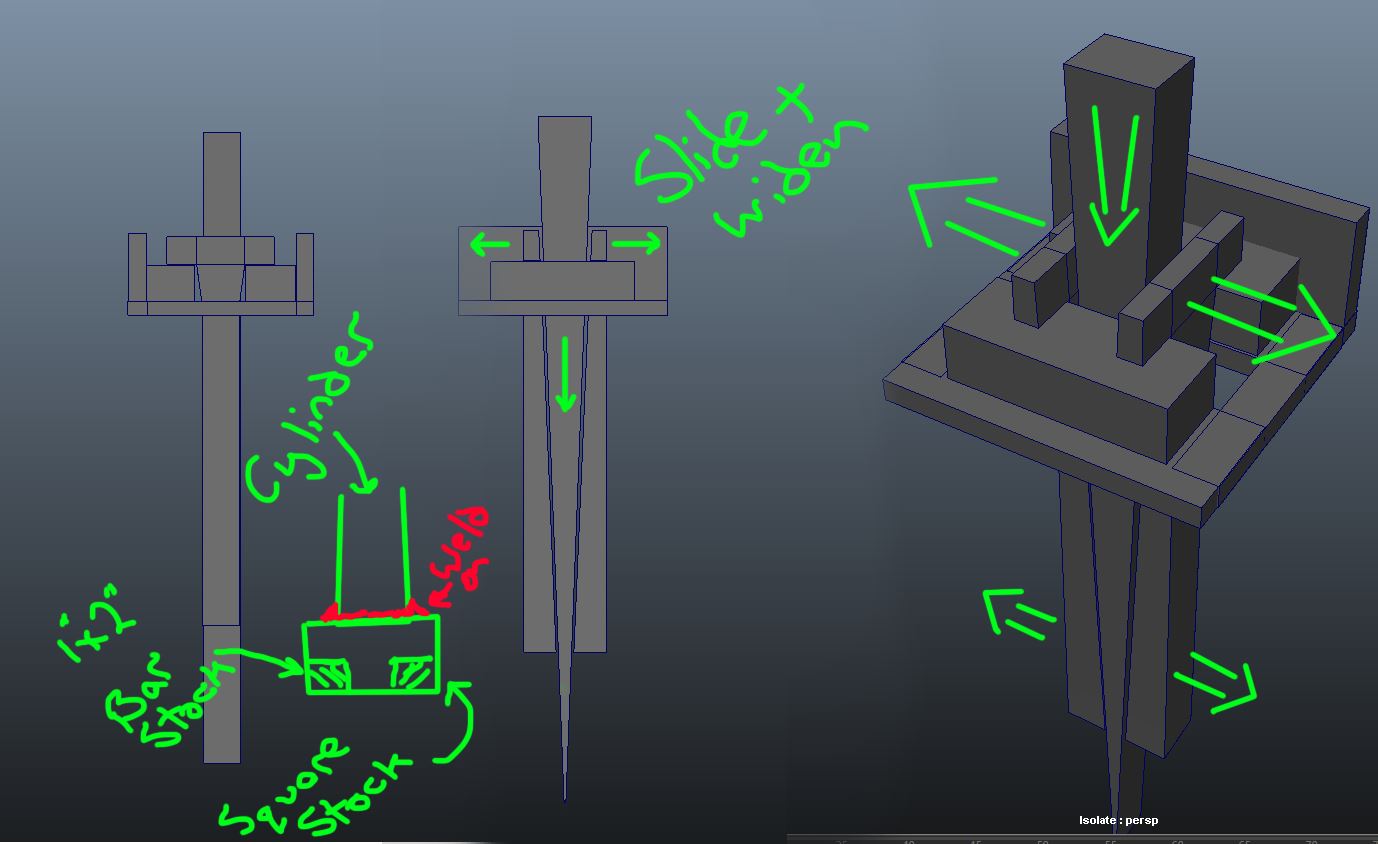

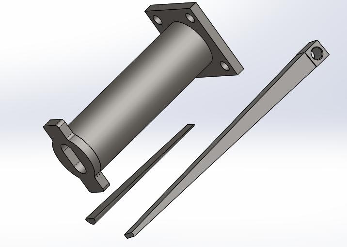

If you do build your own hydraulic splitter, would you need multiple units along the crack line?

That's a good question. I would assume that depends on how long a line you want to fracture. good to know about the water though.
