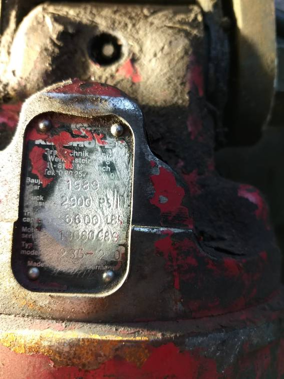

Threw a hundred dollars on the table and brought it home. Ought to be good for something if it works and I can provide enough pressure.
I know nothing about these. Why 4 lines? What should I be concerned about? Just looking for a little education.

The extra line might be for a braking function?
/ Hydraulic rotator #4
Could also be a drain line for letting fluid that bleeds through drain back to the fluid storage container.
Also could be for operating another device such as opening and closing a clam shell bucket or grapple.

Possibly two feeds (for different directions), a main drain, and a case drain, or two main drains.

The 4 lines, two control the rotation and the other 2 control another function, such as the cyl for a grapple. The ports should be marked for each function.
/ Hydraulic rotator #8
Based on the data plate and a lot of Google-Fu, all I could come up with is that you have a Kinshofer KM235-20-3000 rotator - which I figure you already knew.
So the best advice I can give is to call/e-mail the US office and see if they can get you any documentation on it.

Mine (not for $100 - you suck:thumbsup:) has 4 lines. As someone mentioned, the 2nd pair "pass through" and power typically a cylinder on a grapple providing 360* continuous rotation.
Look for a pair of fittings or plugs below the point of rotation, up under the hook area.
