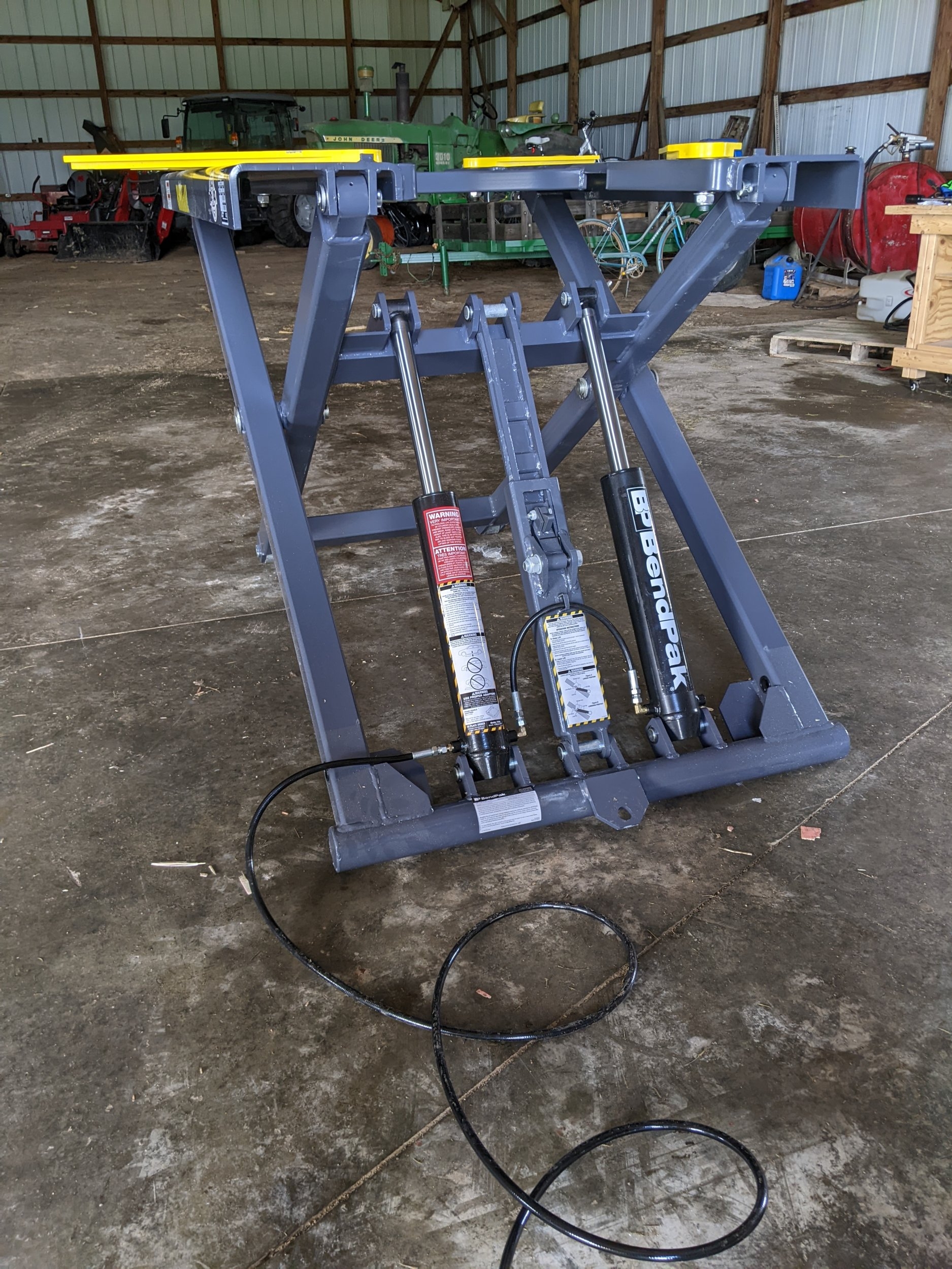

I bought this BendPak lift back in November and finally got the ambition and a reason to put it together. Went together smoothly, lifted fine but now it won't go down.
Any ideas here? It was when I was giving it a test run with no car on it.

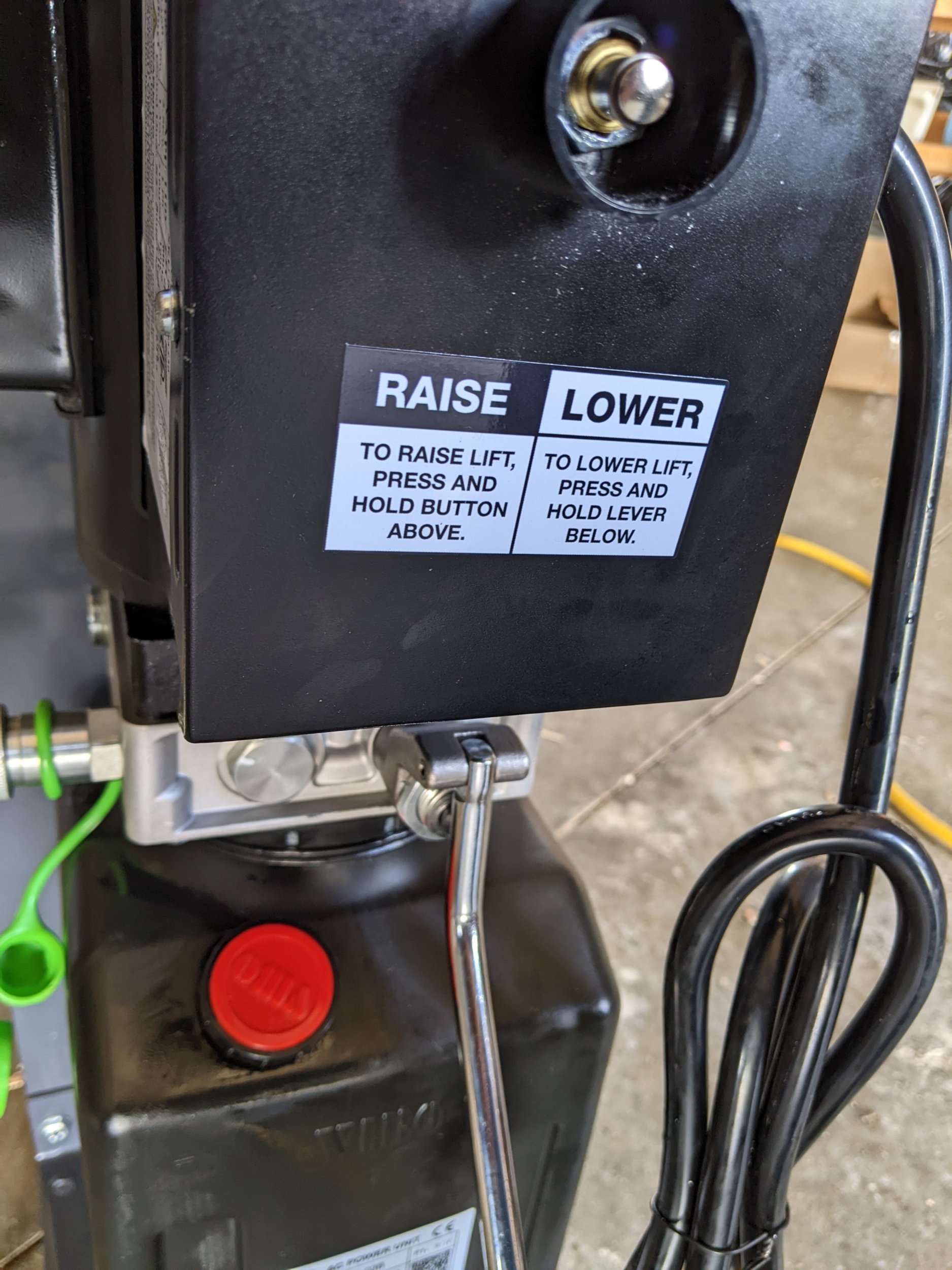

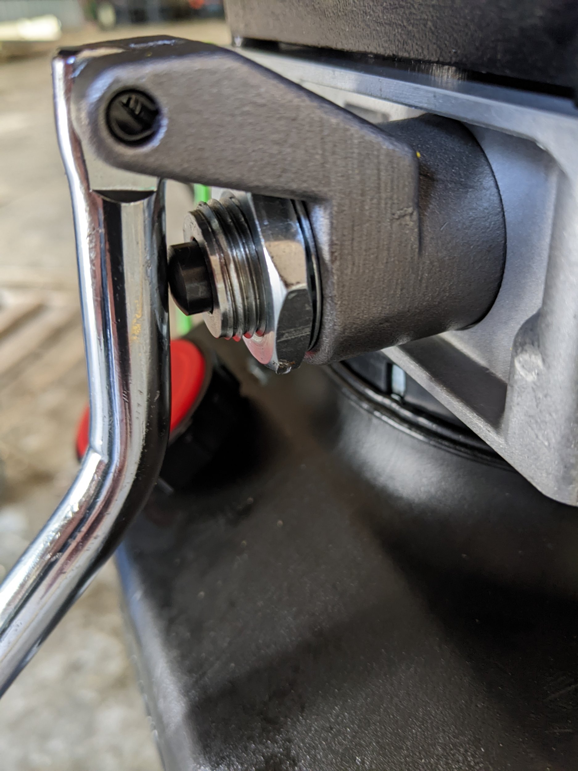

Here is a pic of the buttons to raise and lower. I have the steel stop out but it will not go down at all. Frustrating, I have a break job to do this weekend.
Thanks

In the middle, between the 2 cylinders is a safety lock. It must be released to let it come down. The directions should show you how to release the safety lock. You may have to raise it a bit more to release the latch.

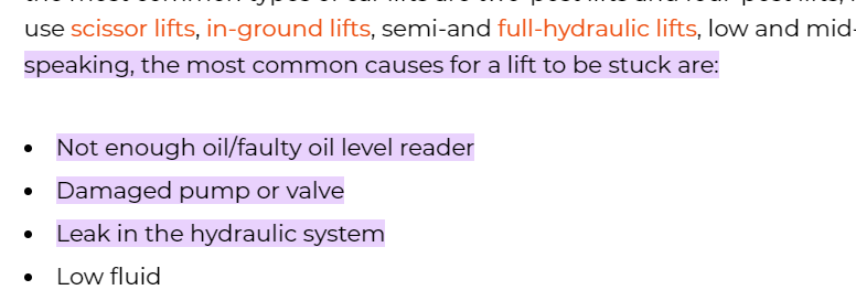

I just found this. This could be my problem. We didn't know if we should check the level with the dipstick screwed in or not (Nothing in the manual). I may have under filled it.
It turns out that I'm an idiot and it was the mechanical lock. I thought the little thing that flips out was the lock when it was really what allows the actual lock to ride over the lock points.
It took me a lot of steps to figure it out. To the point I had hydraulic lines off and it still wouldn't go down. Which caused me to say, it has to be mechanical and looked closer.
I will say, the manual is absolute crap. It does not explain this whatsoever. Anyway, mystery solved thanks George and others who commented.
No oil would prevent lift from raising.
