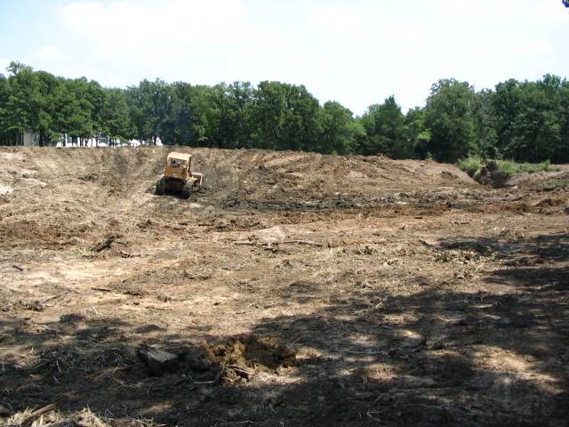

But I am getting a pond built (well, actually I'm expanding my 1/2 acre or so pond to 2 acres or so). They are about 2/3s done with it and I'm hoping they finish it up before we get more real rain here /forums/images/graemlins/smile.gif

That looks like a pretty serious project. A 2 acre pond ought to make a good fishing hole. Hope you have fun with it.

Don't you worry, I will have fun with it /forums/images/graemlins/smile.gif

Wow that's going to be HOT, or cool with water! /forums/images/graemlins/grin.gif
