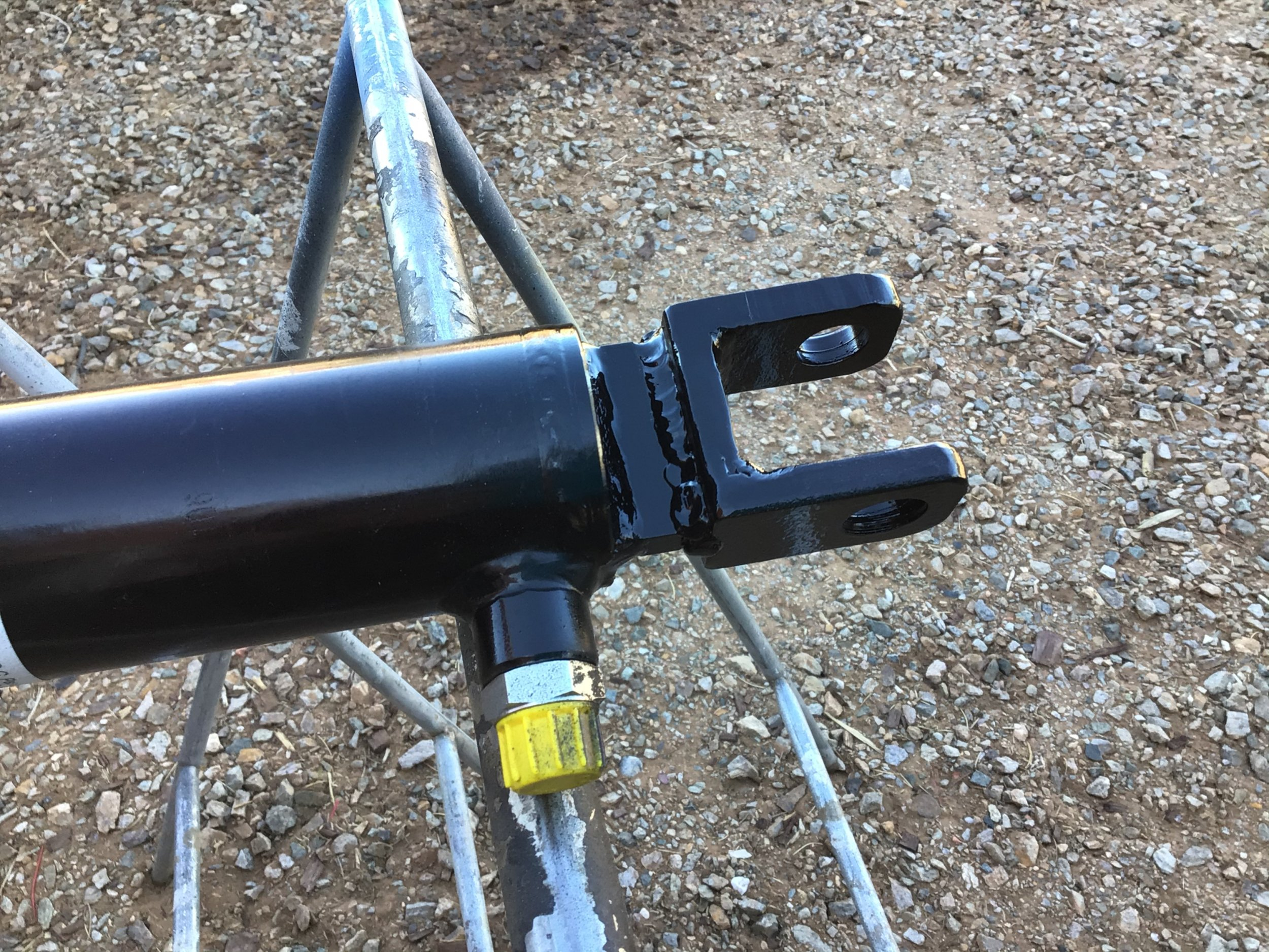

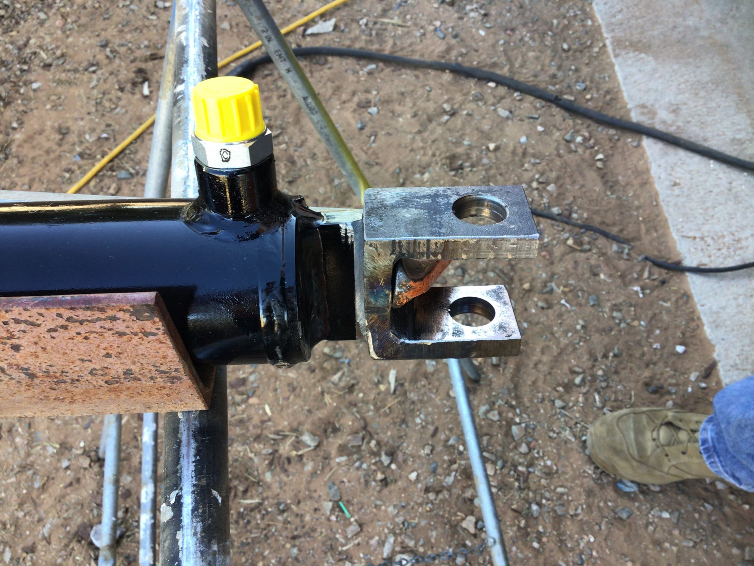

Mine did the same thing. I ended up getting #6 ORB to 3/8" BSPT adapters from discount hydraulics. They were both #6 male, one was 3/8" BSPT female, the other 3/8" BSPT male. Also a pack of the O-rings that fit the #6.I got mine hooked up and was happy. Until it started leaking from the bottom 90 degree fitting. The crush washer didn't work, and the rubber O ring isn't up too the job. I need to get another crush washer.
