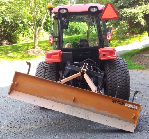

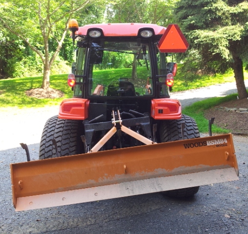

I know there are different views on this, but I'm a big fan of double-piloted check valves on both the top link and side link cylinders, and MIE will add them if requested. They eliminate the risk of nuisance drift-down that is pretty common with any brand of rear remote valve. With your DK, there will be room to add one if you ask for a cylinder with 6" extension for the side link. That's what I have on my NX, and it will also work on your DK.
BTW, by moving the Kioti OEM adjustable side link to the other (left) side of your hitch, you can set it so that you then have tilt both to the right and left. See pics of my NX. NB: That's only on the DK and NX and larger frame models. On my CK, I have top 'n tilt as well, but the smaller tractor requires a shorter cylinder on the side link, and there is not enough room to fit a check valve between the ports, unfortunately.
