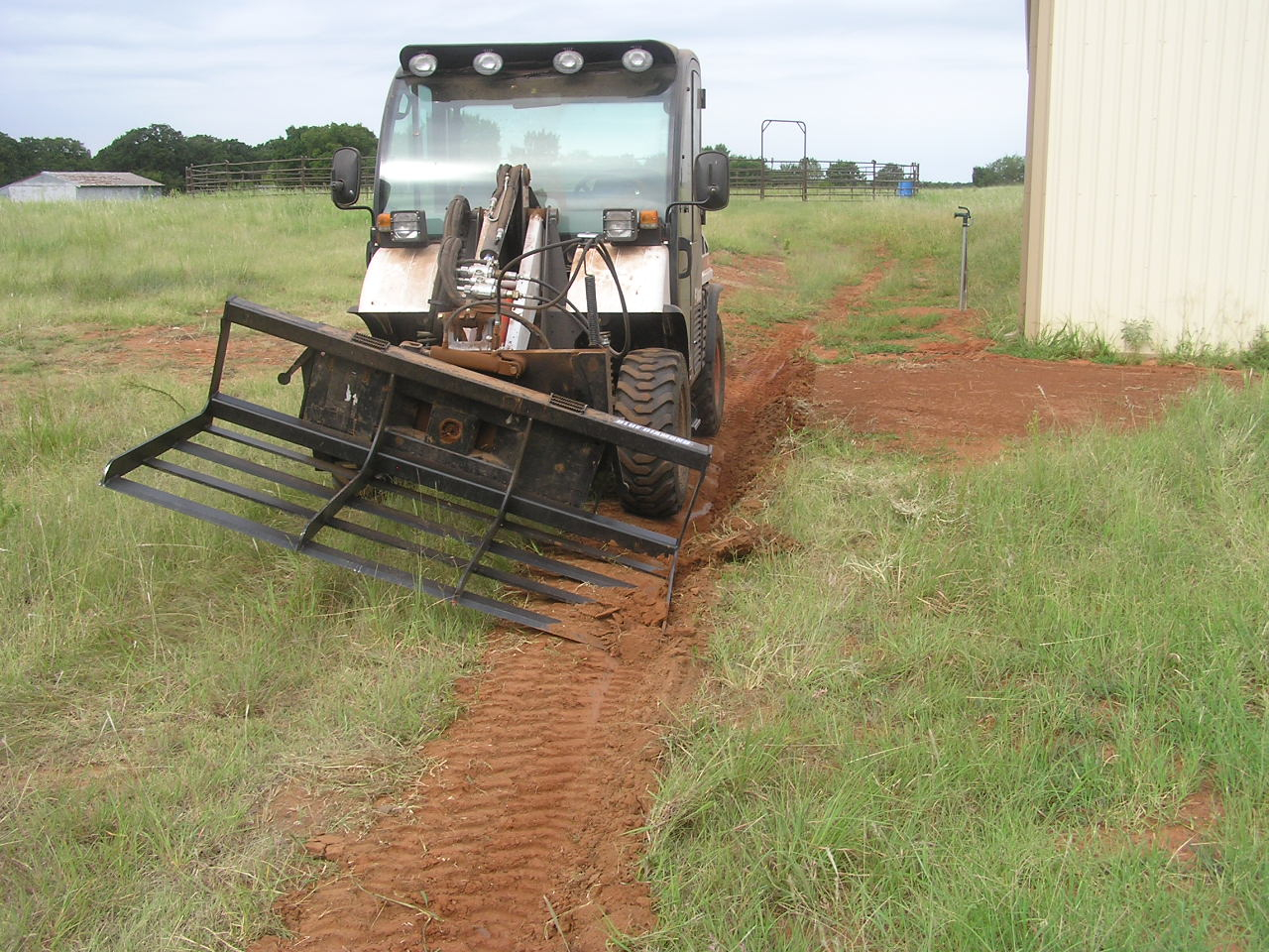

I use my double acting cylinder to push one side or the other of the attachment down. The push is achieved by applying the weight of the attachment on one small edge. Such as a BB or rear blade.
If I'm trying to dig a ditch with my rear blade, and extend the cylinder lifting the entire blade off the ground except the digging end of the moldboard I can dig a ditch in almost any type of dirt.
Or if I'm trying to level a side slope with the BB I can apply the same principle. Making quick work of the challenge.

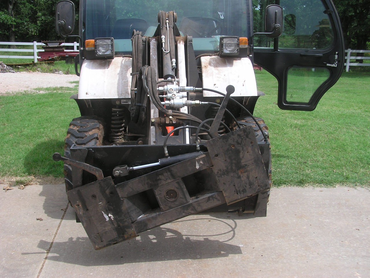

But the double action tilt cylinder increased the tilt angle. A single action tilt cylinder couldn't do that without raising the 3pt.

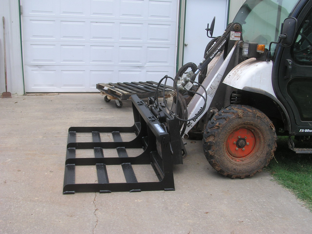

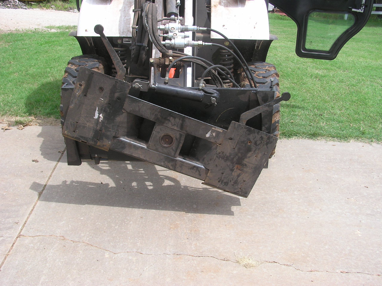

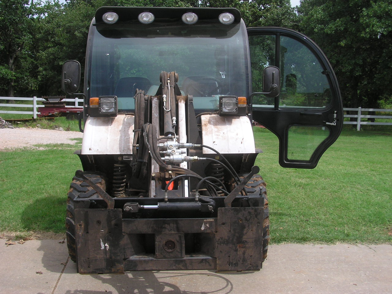

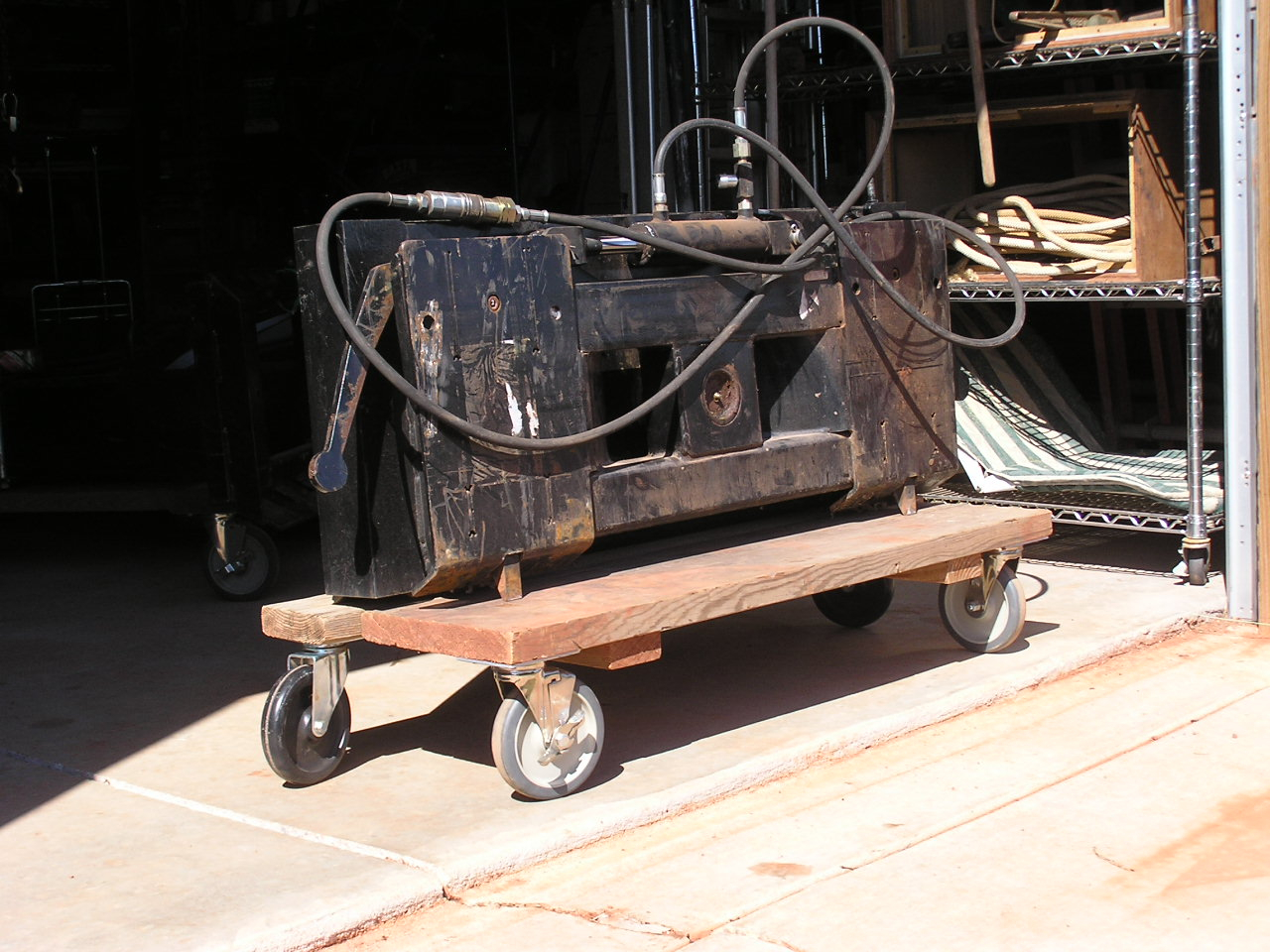

This is my double action tilt cylinder. It is in a Tilt-Tach:
It goes on the SSQA:
Then the attachment goes on the Tilt-Tach:
And it tilts the land plane:
Tilting the 6' box blade:
