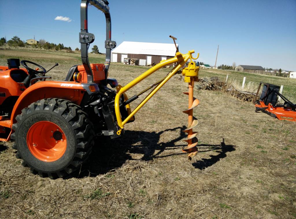

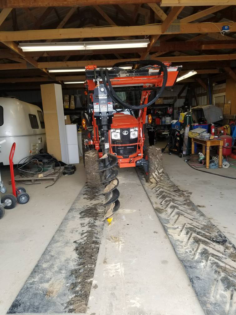

Any photos here of what guys are working with?
   / Hydraulic ssqa augers? #36
Here is my new SSQA hydraulic unit. Also my old 3pt unit I rebuilt to fit on a 3pt Quick Hitch & to mount a heavy chunk of ballast on.

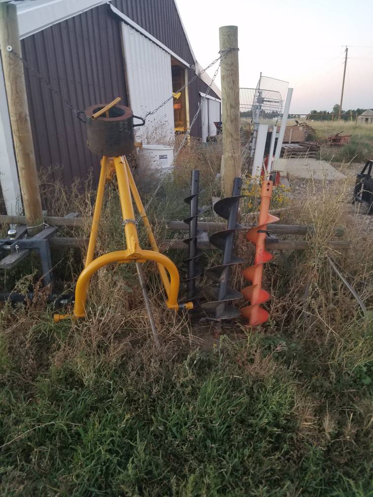

   / Hydraulic ssqa augers? #38
here's mine:
im building a little corral fence over the weekend.
   / Hydraulic ssqa augers? #39
That is what I have, except a size or so down. How fast can you spin that model? I get about 1rev/sec
   / Hydraulic ssqa augers? #40
Slow... It spins in the same ballpark as my PTO PHD did at an idle. I set my auto throttle button to 1900rpm or so. I generally hit that button along with the 3rd function button.
Mine is the small Danhuser model. Something 6 maybe? Rated for up to 15gpm if I recall. It's underpowered, but thats more a function of the max hydraulic pressure & flow of my (or any other CUT) hydraulics than the PHD itself. I'd classify it as adequate, barely. I'd buy it all over again though.
The only way to do better on a CUT is to make a PTO powered hydraulic power pack. That would be around $2k or more. And then the small PHD would probably need a bigger motor to match the bigger pump & flow. Pretty sure all the PHDs in a given line are the same, just with different sized motors on them. And of course the big round vs 2" hex output shaft options.
