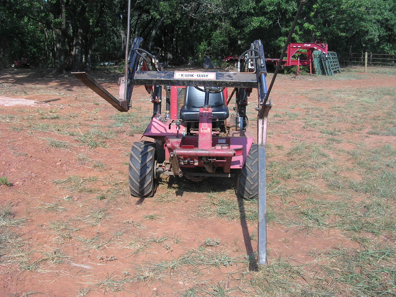

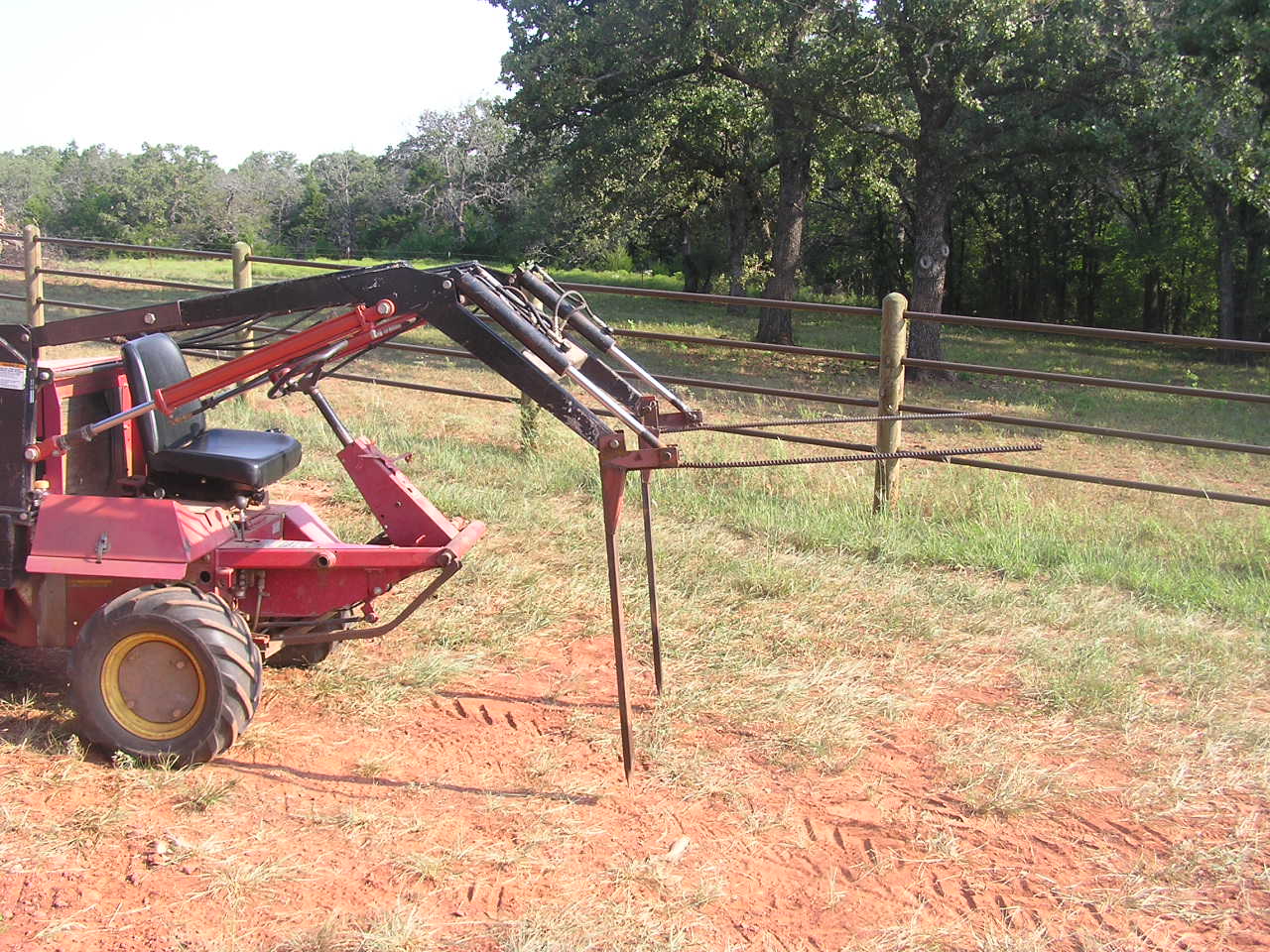

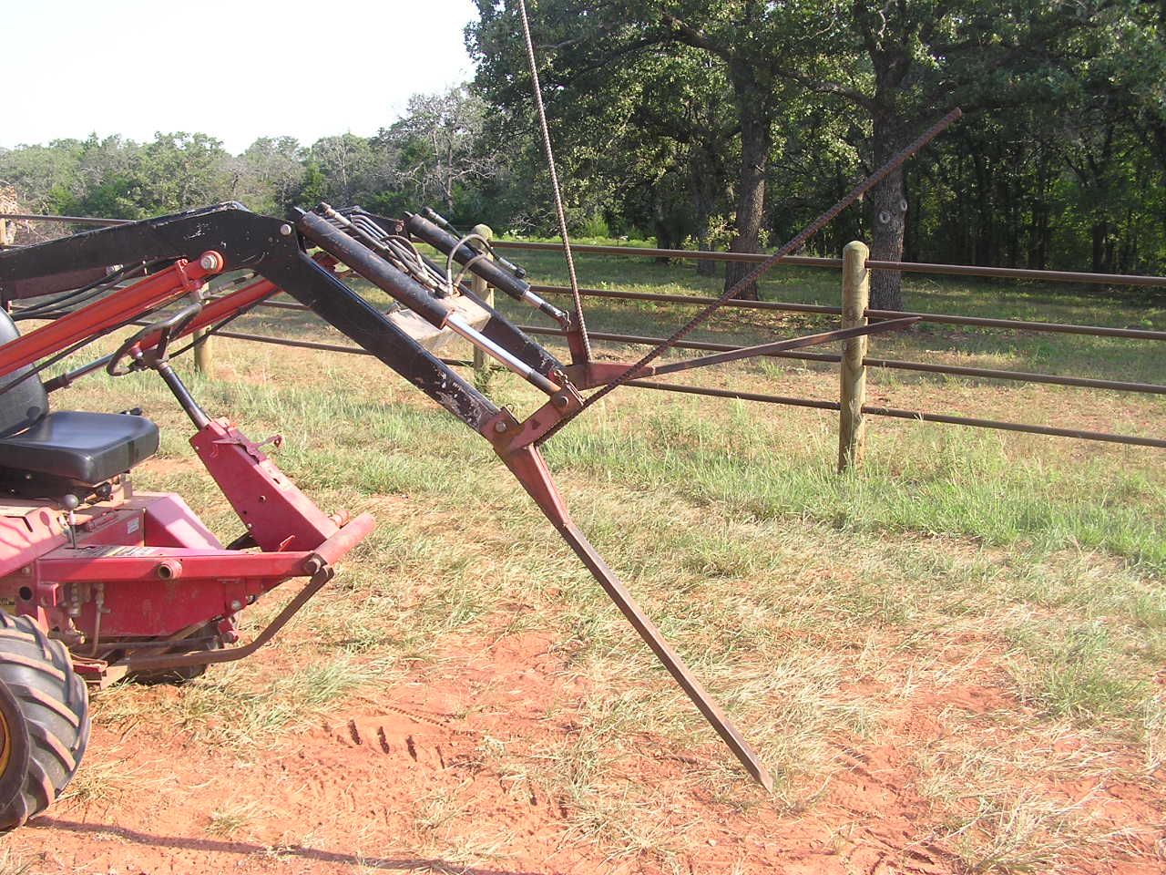

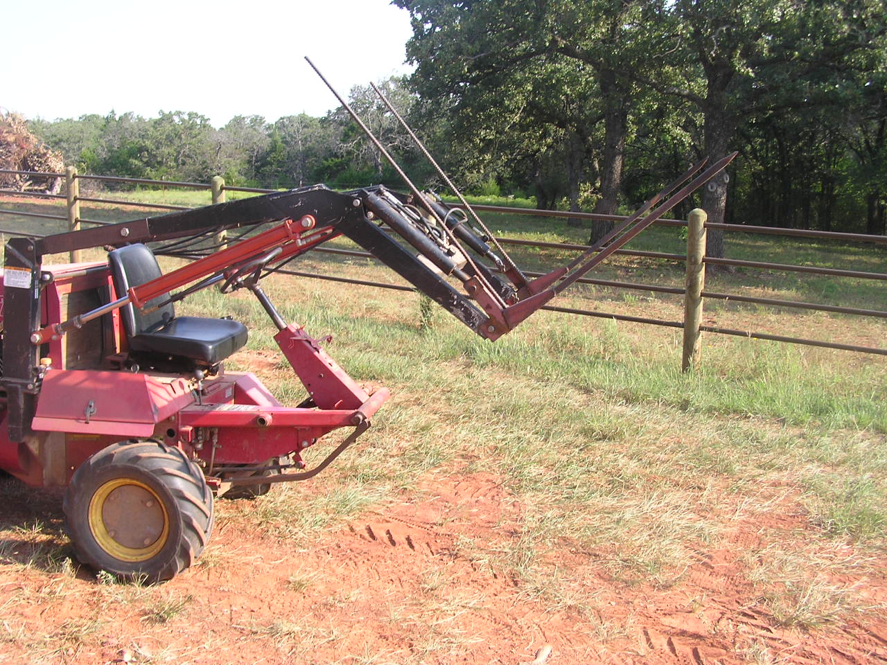

Here is visual proof, push down one fork, the other comes up. It is the reason my Independent Forks work.
More info here: FEL, TORO Groundsmaster Put Together - Page 5
