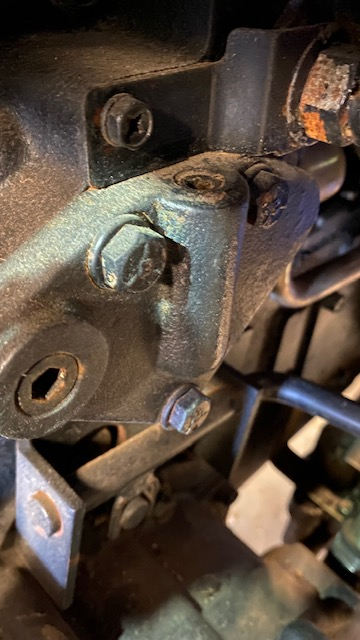

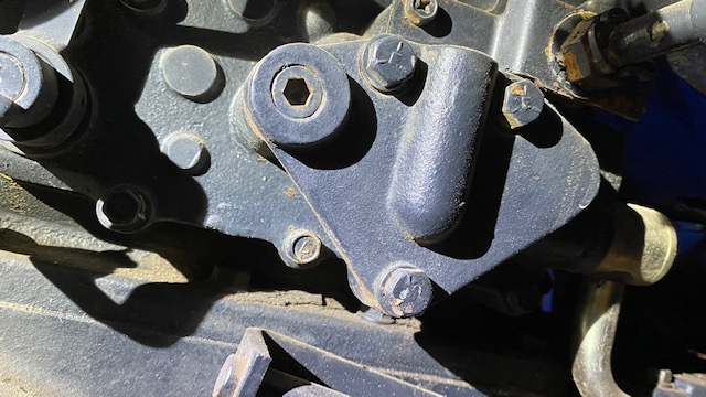

But here's my problem... the cover plate that is on my New Holland TC55DA is triangle-shaped, and mounts with only three bolts instead of four bolts like the part numbers above. So it looks like the 4-bolt ones don't fit my tractor. I have not seen my tractor listed as one that these will fit. Pictures below of my cover plate.
Here's my question...I see two ports on that cover plate, with hex plugs inside. One is on the side and the other is on top, shown in the attached pics. Has anyone used those ports to power remotes or a backhoe? If so, which is pressure, which is return, and where does return-to-tank go? I've looked at the NH parts diagram and I see that those ports do seem to be fed from inside that lift cover area... that is where the factory remote valves mount and get pressure and return hydraulic fluid. I have a pressure gauge that I could thread into them to see which one might be the pressure side.

I don't believe you can just plug into those ports. They had a adapter plate for a backhoe connection that allowed fluid flow in the right direction.

Hi K5Lwq, I thought the same thing until I saw that my cover plate has ports on it. I was hoping that someone may have found a way to use this cover plate directly. I searched at length for a 3-bolt adapter plate like what might have been used on a Woods backhoe kit, but no joy.

Update: I found a CNH assembly manual for several backhoes on tractors including the TC55DA. It shows this port with the hex plug on the side of the remote valve cover used for return to tank.
It also says to run the pressure line to the power beyond port of the loader valve. In my case, I'll run the pressure line from the power-beyond port of my third function valve.

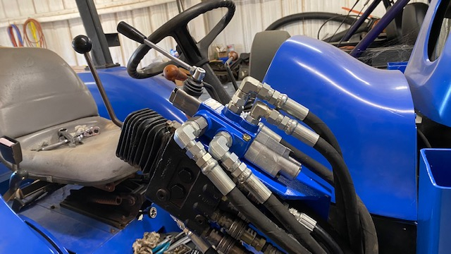

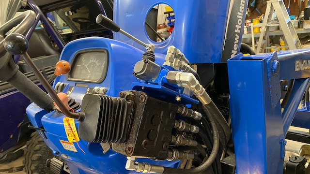

My third function valve for my grapple:
I went with the separate third function valve because I found a nice NOS one really cheap, and it was less hassle trying to get a three-spool valve made like yours. You had a very informative thread a while back describing the hassle that you went through to get that nice Walvoil valve that you installed on your Kioti.
   / Hydraulic Supply for Rear Remotes? NH TC55DA #7
No doubt! You did a wonderful job on that installation. Very clean!
