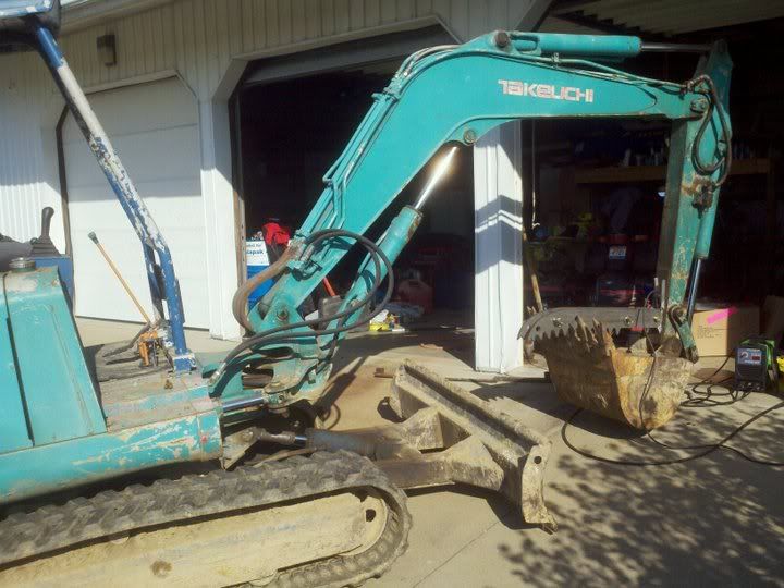

Well, it's been quite a while since I started this thread; but this morning I finally finished it.
I've had the steel cut out for a month or so, but the only welder I had was a little 110v Lincoln MIG. Nice welder, but completely out of its league with 1/2" steel.
I decided that a stick welder was the way to go; mainly because I can't afford a big MIG (and don't need one most of the time)
Looked at some Lincoln buzz boxes, but ended up with a new Everlast inverter-based welder. 200amps, weighs about 30lbs, DC, works very well so far.

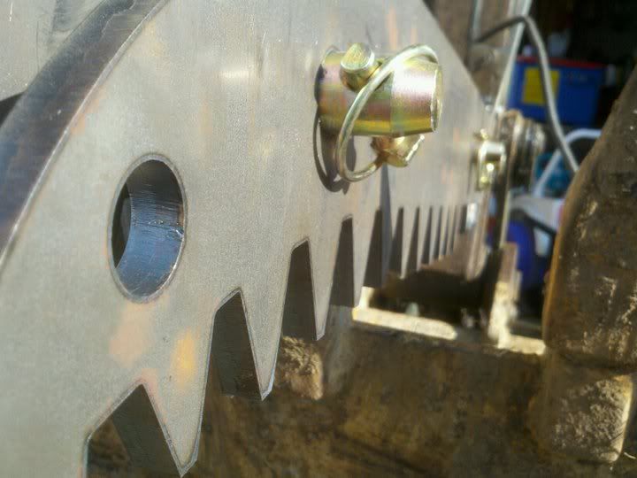

Tacked everything up with the MIG and ran the hydraulics around a bit; seemed to be in the right spot and lined up, so I welded it all solid with the stick (no welds across the dipper though, heard that was a no-no)
Used Cat II toplink pins to hold everything together.
They're just clipped in at the moment, but I'll probably go back and weld a few of them solid for strength.

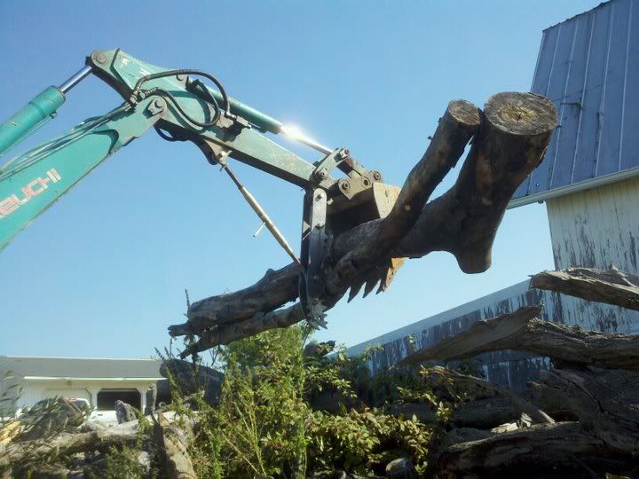

Got it all welded up and took it out to test it.
Seemed to work great with the little stuff; now it's time to see if I can break it :D
It was all the hoe could do to lift this log up, had to keep it as close as possible so it wouldn't tip over, but it worked great.
Carried it a hundred yards to add it to the firewood pile.
Checked everything out after that, nothing bent/cracked/etc so I think it'll hold up for quite a while.
Easy to adjust with the toplink, and two pins will take it right off for dirt work.
