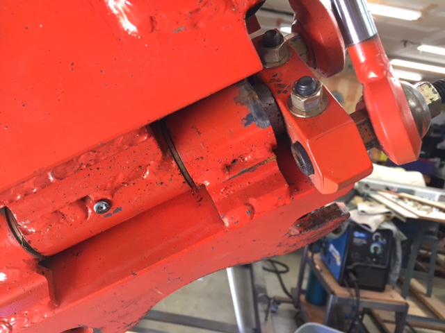

Only one welding photo left, might as well put it up too. Getting ready to weld the upper cylinder mount. Lots of clamps and spacers to keep things aligned.

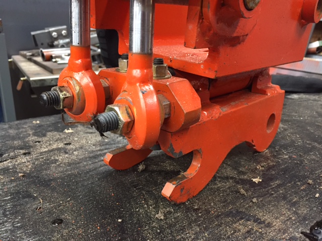

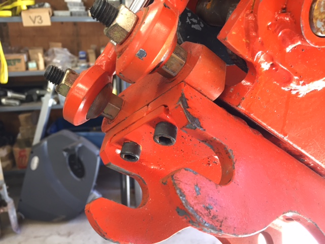

For some reason I left out photos of the lower cylinder mount which was the most complicated part of the job. All the dimensions were critical either for clearance or tilt geometry reasons. I seldom use a milling machine but I did on this to make the mating surfaces completely flat. All the bolts are socket head alloy steel.
The last photo shows it in use. It is very easy to make a perfect grade in a confined space. I've ordered a check valve from Trausch to keep the bucket steady. I might also install flow restrictors to slow down the tilt movement. The valve can be feathered but it would be easier to use if slowed down.

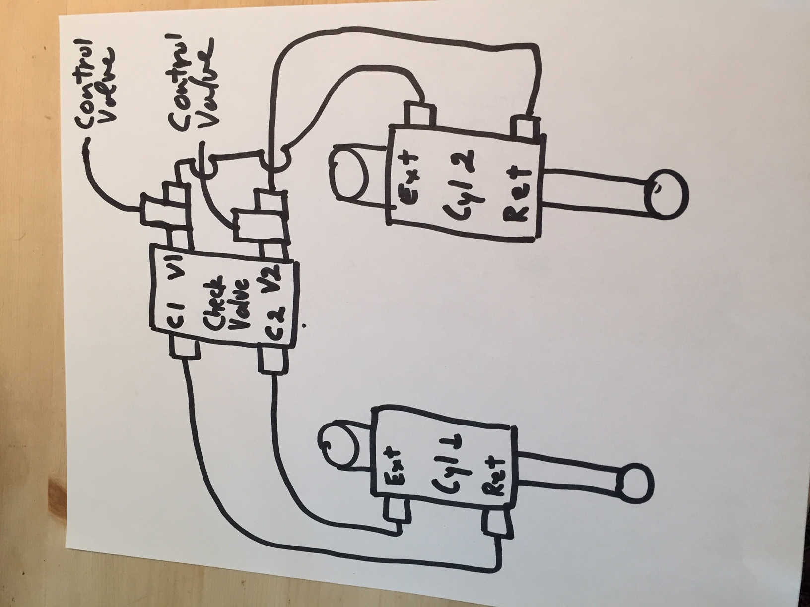

Time to wrap up this thread. I finally got around to installing a check valve on the tilt coupler. It works perfect to keep the bucket tilted in the position where you set it. Instead of slopping around due to the the two operating cylinders being interconnected. The check valve operates on Cylinder 1 like any check valve. The lines coming from the control valve are Tee'd on the inlet side of the check valve. So that Cylinder 2 is operated directly, bypassing the check valve.
Photo 1. Valve installed. Hard to see, it is in between the cylinders and the guard plate.
Photo 2. Hookup diagram. If someone else wants to make a hyd tilt coupler this will save you some head scratching.
