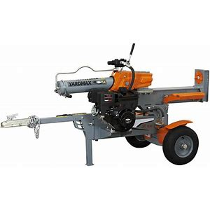

A photo of the whole cylinder inlet to outlet would be helpful. If the tube is a straight piece between the inlet and outlet... the design is faulty and will always eventually leak. There should be a bend in the tubing to allow cylinder length change.

PTSG .. I am not referring to the valves. It's the tubing path. Notice the tubing bend between valve and port on this log splitter. The valve is fixed on the retract port. The "bend" allows movement between two fixed points (The 90 degree tube bend after the fitting helps too)
Any flex or expansion between the cylinder ports is stressing the tubing and fittings. I would not design or allow such an install. You may have different thoughts and practices.

PTSG .. I am not referring to the valves. It's the tubing path. Any flex or expansion between the cylinder ports is stressing the tubing. I would not design or allow such an install. You may have different thoughts. Notice the tubing bend on this log splitter. The "bend" allows movement between two fixed points
