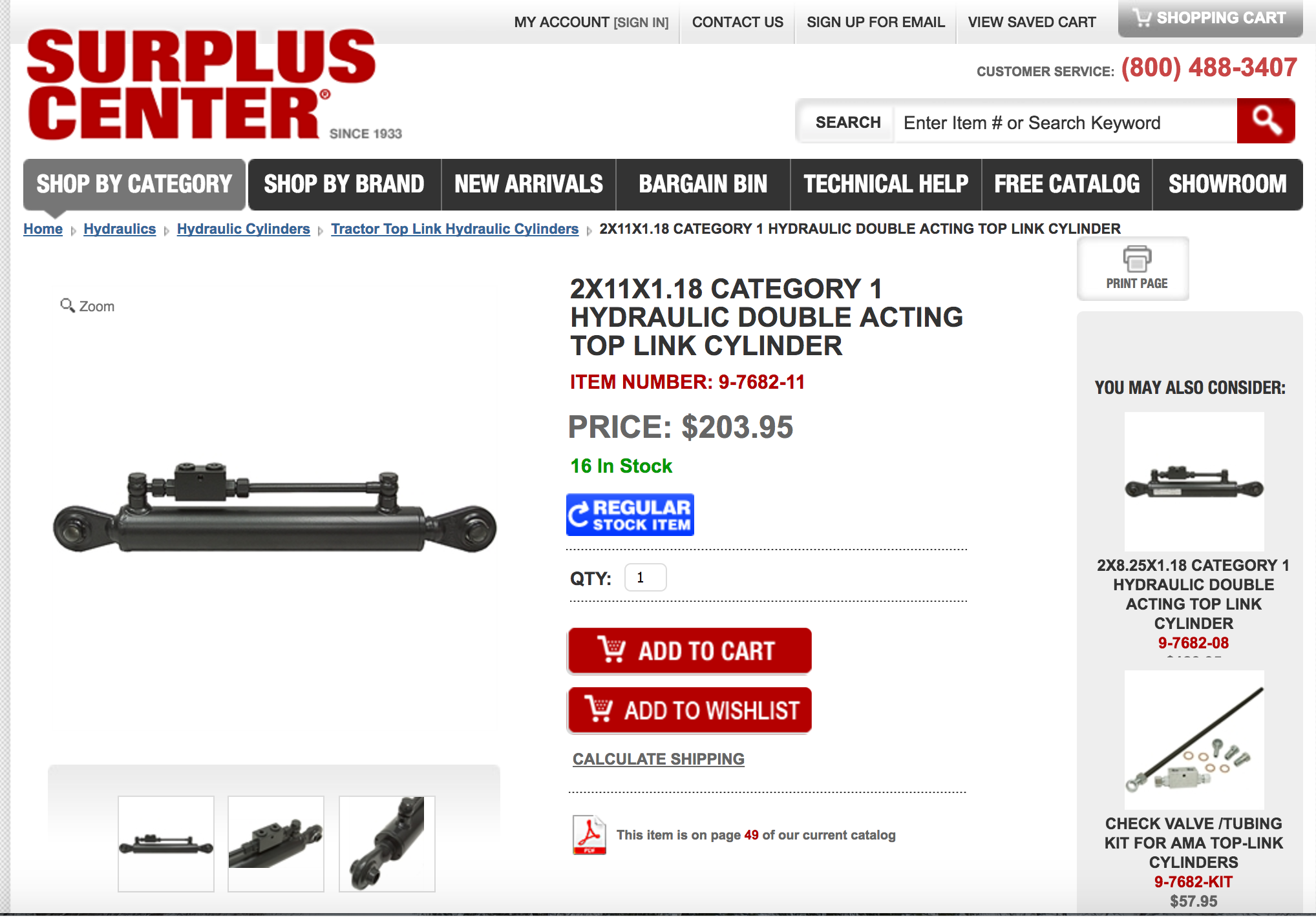

How many of you use a dual acting hydraulic top link? I found some for around $200 on Surplus Center. I already have a diverter valve for additional hydraulic that set empty unless I'm using my snow plow. What are your thoughts and suggestions on using a hydraulic top link?
You know,, the top link in your pic does not need tractor hydraulics??
It is self contained! :thumbsup: ,,, just open and close the little valve.

You know,, the top link in your pic does not need tractor hydraulics?? It is self contained! :thumbsup: ,,, just open and close the little valve.
No the one in the pic DOES need a control valve, it's not a self contained unit. The square box is a check valve that the hoses connect to. I've been using that toplink from surplus center for just over two years and have had zero issues with it.
