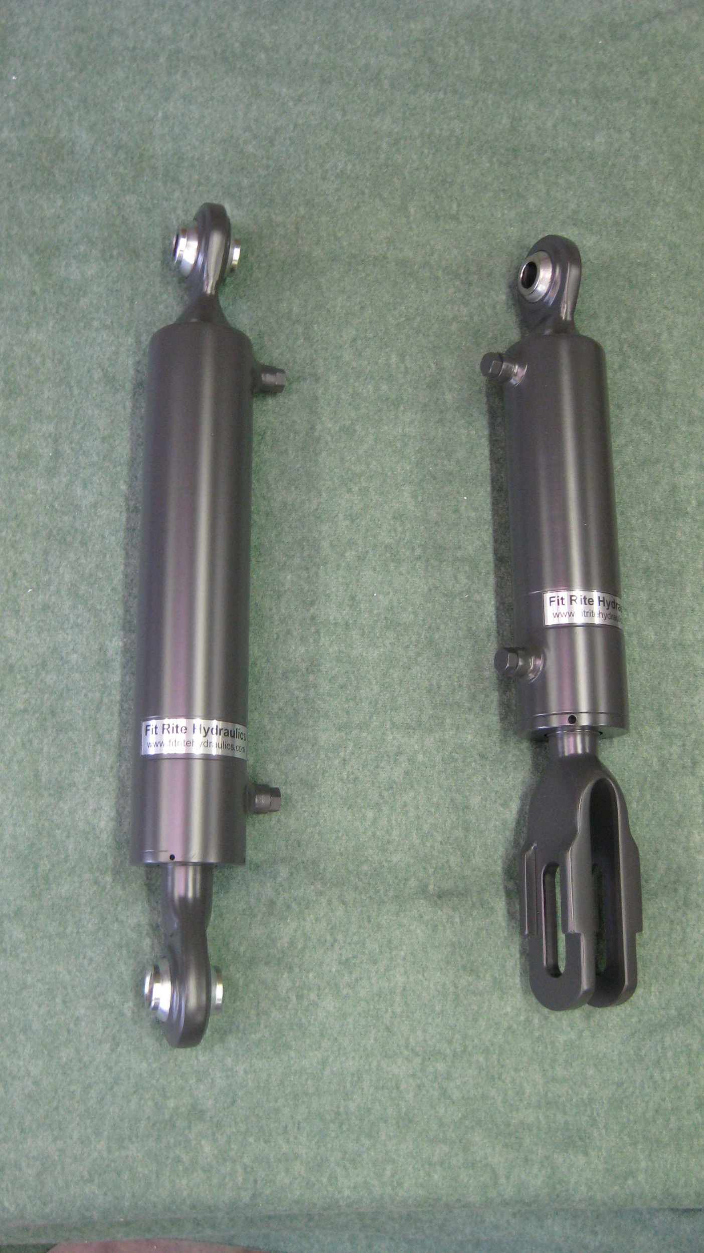

Really the only thing about it that is cat 1 is the tractor end pin size. It takes a full cat 2 sized ball swivel, larger dia ball swivel and 2" wide.
I typically provide a 23 1/4"- 35 1/4" working length similar to the left unit pictured.
My current lead times are almost 29 weeks.
Agristore has some units that are in stock, you just need to decide which one would work best for you.
Don't forget to get a reducer bushing for the tractor end.
