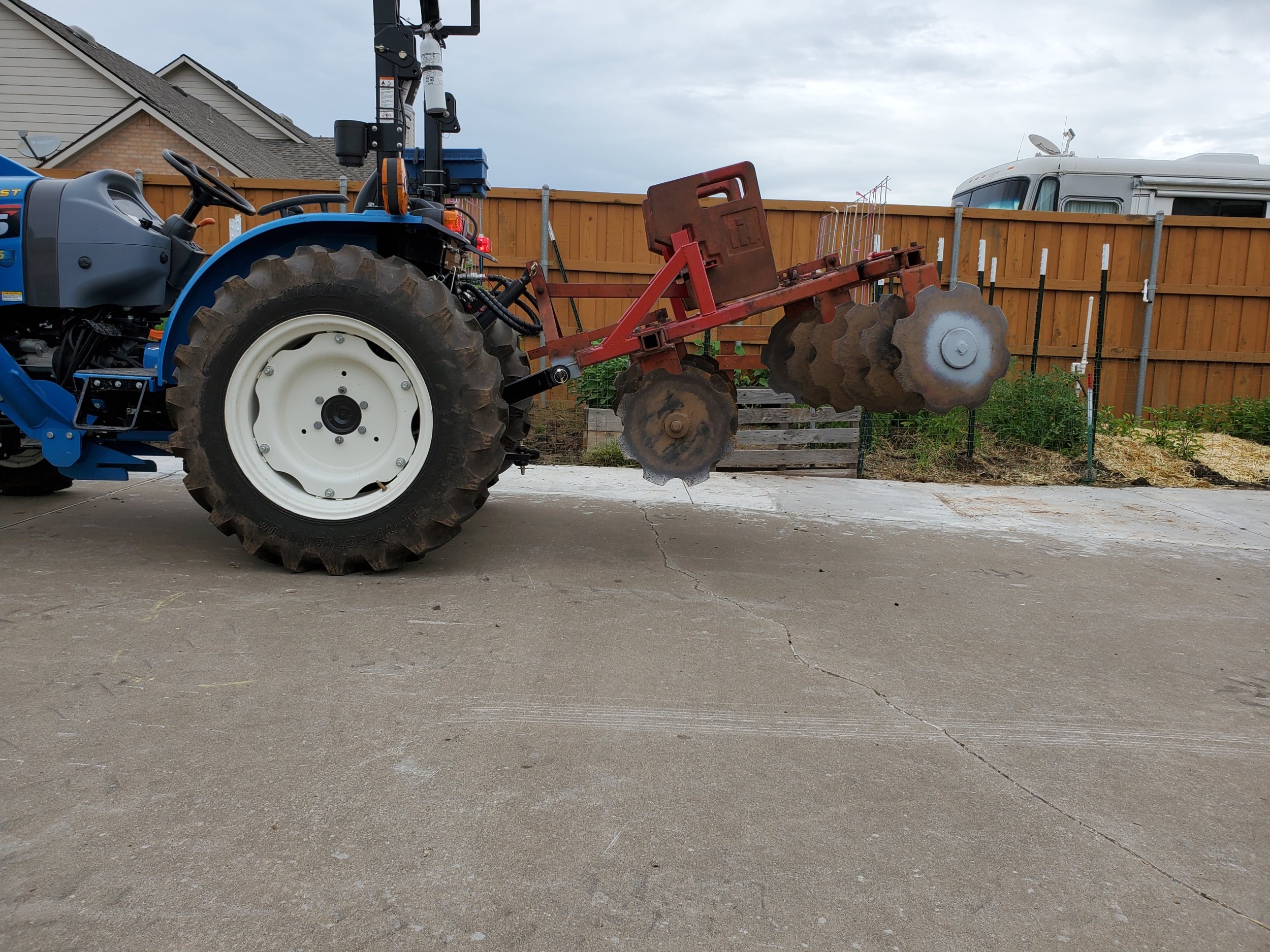

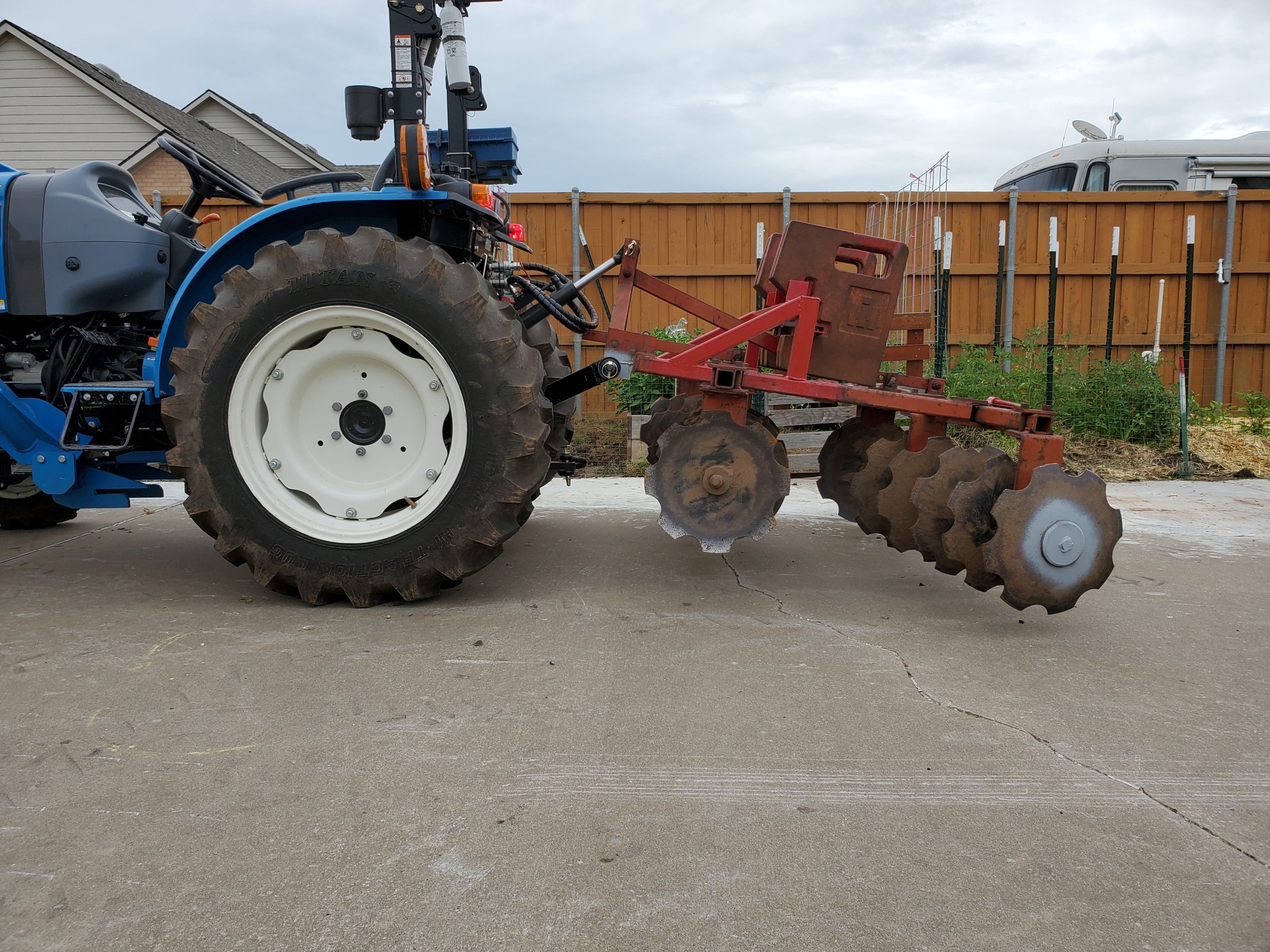

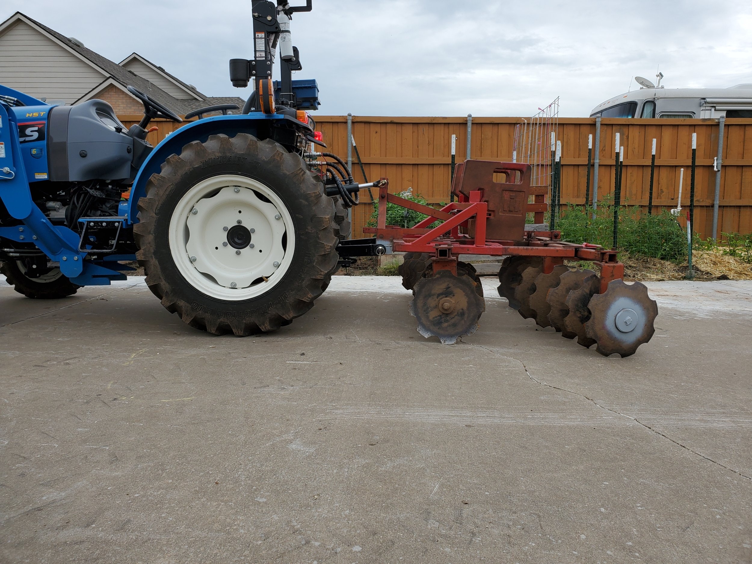

Hydraulic top link makes a BIG difference! Here is the difference on my little 40hp with one of the smallest travel distance top links.
First 2 pics are at then maximum lift with top link fully out and in.
(If you zoom in, you can see that I also moved the lower pins on the disk itself (Primerd area) down to get more lift)
I have since moved my lower arms up to the next pair of holes so that it lifts higher but will still almost reach the ground when lowered.

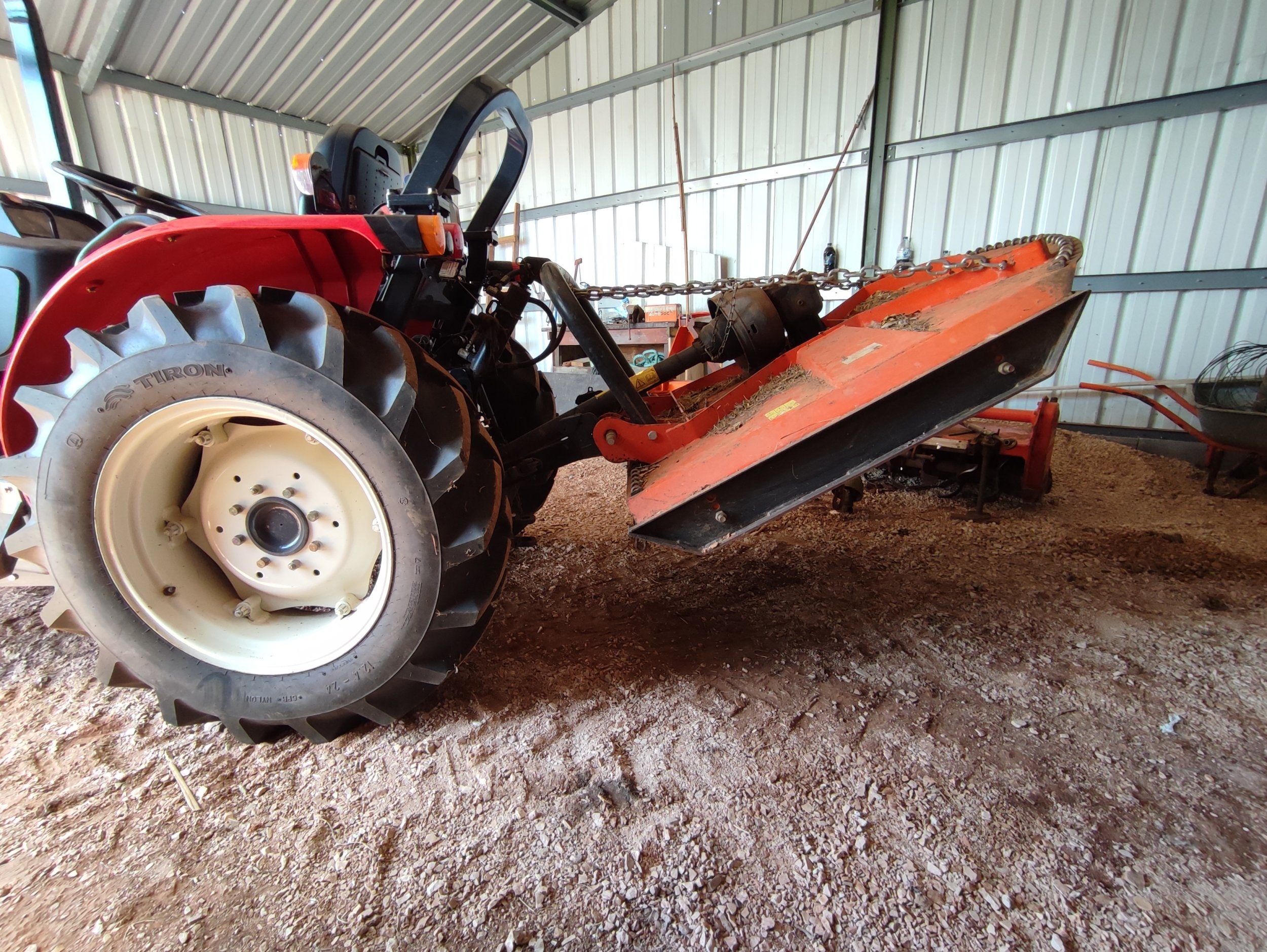

+1 for hydraulic top link. No hay operation for me but I do use mine a lot, specially with the brush cutter as it allows me to put my cutter at a near 45 degree angle to tackle high brush and cutting against embankments.
Picture as example, although it still has more to go than it shows in the picture.

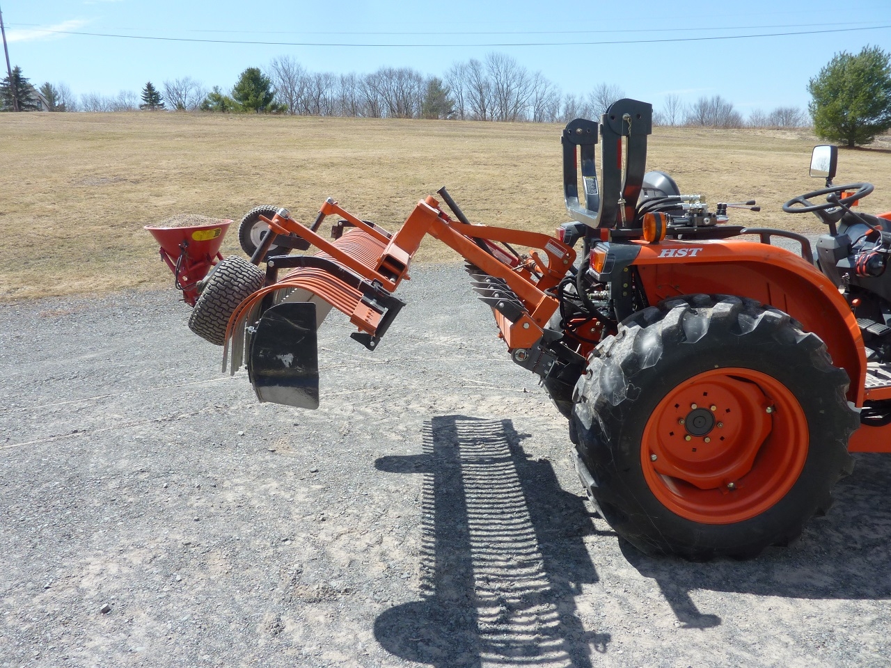

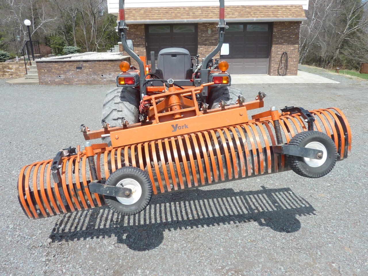

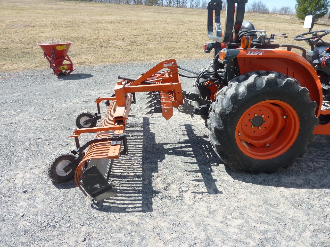

I find the hydraulic top link to be handy with many implements, most of all, the stone rake:
Add a hydraulic tilt cylinder and you can do this as well. All without getting off the tractor.

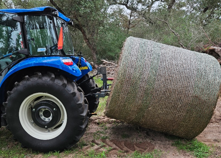

Here's an example. This is as much lift as I can get without cranking on the manual toplink after I've speared the bale...

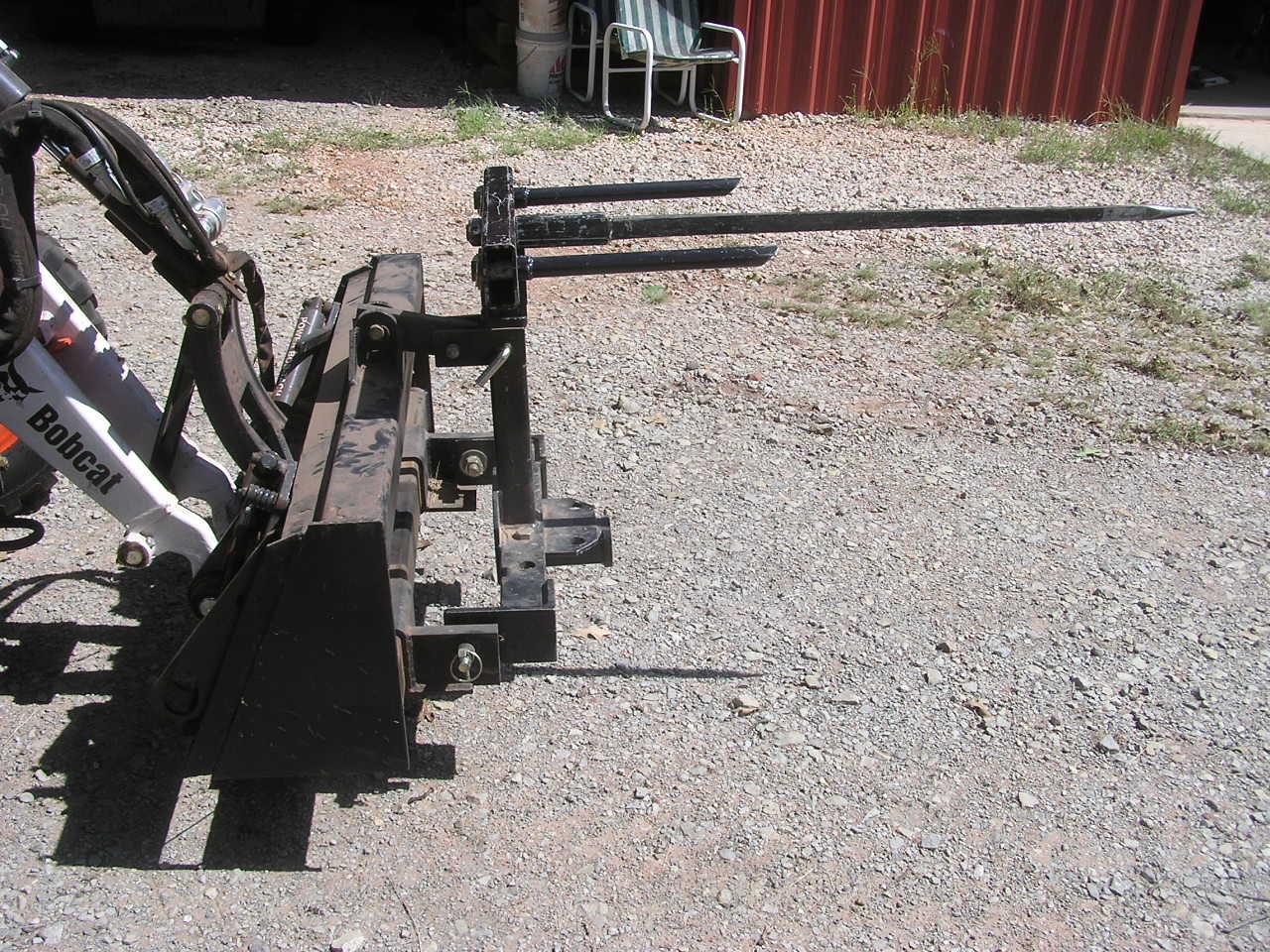

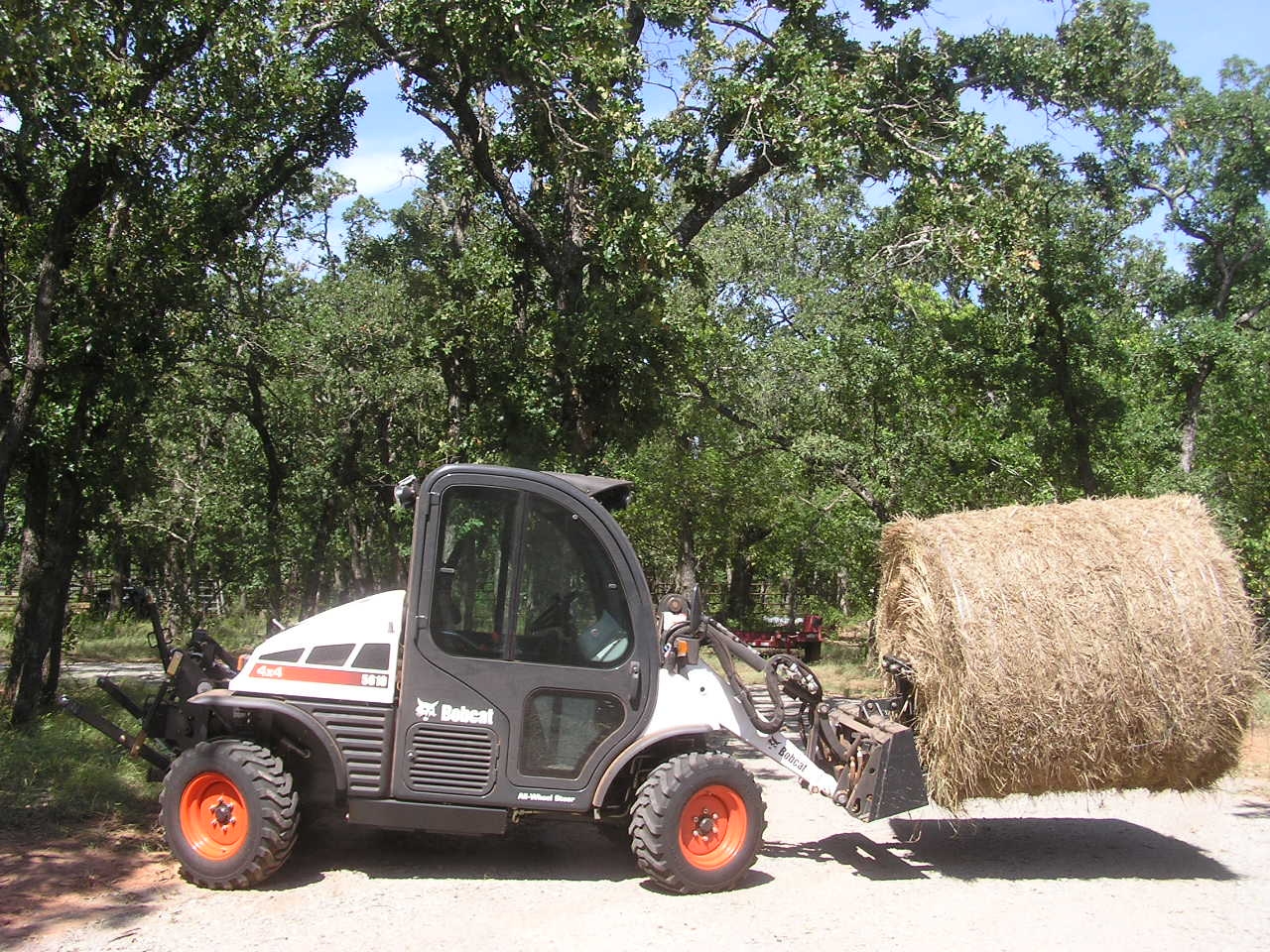

Looks like a longer bale spear would help.
Mine is 48 inches long:
A 5x6 bale:
   / Hydraulic Top Link? Moving Hay~UPDATE! Problem Solved!
#18
A 5x6 bale:
My rear spear has a 48" spike and two shorter ones. But my short ones are underneath the main spike.
I just think I can get as much lift as I need with the hydraulic top link. Should solve the issue.
I don't have trouble with the front loader spear because it has 2 48" spears and as much lift as I wanna give it.

Got a hydraulic top link and installed it today on my PS120...
It lifted up just as it should and solved the issue! (y)
I swear, tractors ought to come with these as a standard top link!
Think I'm going to get another one for my PS75 so I won't have to swap them out.
Before:
After:
