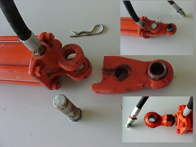

In my limited experience, I think both the limits of retraction and extension are important. My TBN research also left me with the impression: strive to obtain the fully retracted length of the OEM Top Link.
With a BoxBlade, for example, tipping the implement forward or back allows different functions of the implement to be utilized. So, for a BoxBlade, both are important.

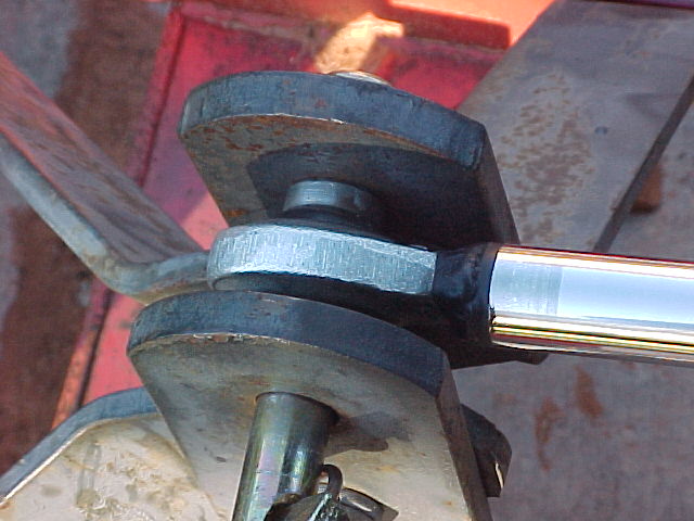

My OEM link collapsed to 18 1/2" and would extend 8" to 26 1/2". The Prince cylinder has 8" of extension and is 13 1/2" collapsed. That gave me 5" to make up by welding the swivels. To make things fit best, I didn't want to equally divide those inches. The swivel on the rod was cut quite short, while the rest of the length was made up on the cylinder base. This picture and the next one show what I mean. Rod end swivel, Picture #1.

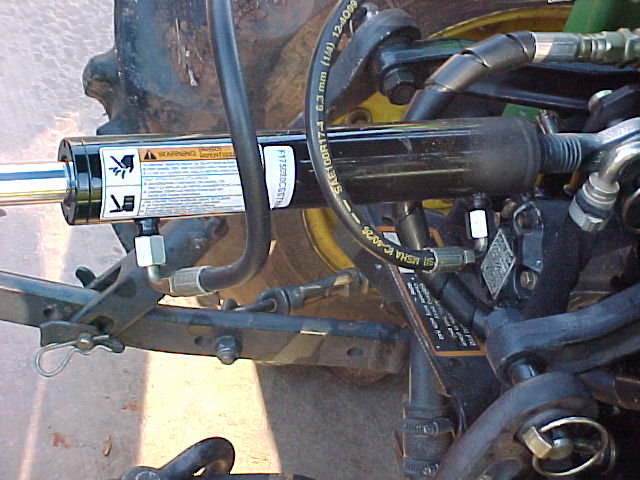

Cylinder base end. Picture #2.

Also, the rotational angle that the swivel is welded onto the base can make a difference as far as clearing obstacles the Link might encounter as it is raised and lowered through it's range of motion. My base swivel was welded at about a 45 degree angle off of being aligned with the cylinder fitting ports. This picture kinda shows that.

Finally, to attempt to answer your question. If I had the luxury of a cylinder with more than 8" of extension, and could make the collapsed length anything I wanted. I would divide the extra extension in half, between full retraction and full extention, so each limit would benefit by half. In other words, I think both limits are equally important.

Thanks OkieG. Very helpful with the pics, especially the extra wrinkle of angling the proximal weld-on end. /forums/images/graemlins/smile.gif It looks like you had some room to spare with some threads visible on that proximal end that you welded on.
